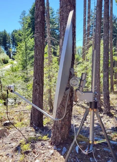

The mounting post itself is basically 0º in the adjustable direction (it has a pivot to adjust the angle) but it is leaning maybe 0.9º in the other direction (based on how it's bolted into the trellis post). I tried to kinda "encourage"/slide/bend it over but might have to loosen those four lags bolts and try again. Not sure how much better I'd be able to get it though; as I tighten the bolts it kind of has a mind of its own where it wants to settle in :-/
One thing that strikes me… I don't have a good sense for how high 38º is up in the sky and it's really hard for me to tell what the dish is actually pointing towards. But there is a tree around the block kind of in that direction. Maybe I should set my "dumpy level" (as I think people call it, basically an old Craftsman survey transit for construction work that the real surveyors don't think too highly of) back up both in azimuth and elevation there. It has pretty detailed markings that would help me aim its eyepiece and see visually towards the satellite. Just to rule out it's not physically blocked I guess? Because my arc doesn't seem **too** terrible off afaict.
If on 123W, you can't receive any signals, then try another way. Point the dish at the correct azimuth as best you can. Blind scan. Anything? If not move the azimuth a bit either way. Blind scan. Anything? If not, adjust elevation a small amount (1/2 degree?). Blind scan. If elevation is off a little, you may not receive anything. But if azimuth is off a little, you may still catch something on blind scan. So elevation can be critical.

Added: For setting elevation, I just use an angle app I downloaded for free to my smart phone. I place the phone on the centre edge of the dish face. You must know your dish offset angle which is typically about 24 degrees for a Ku dish.
So for me on 123W Galaxy 18:
Elevation needed: 33.2 degrees
Dish offset: 24 degrees
Actual dish face elevation: 33.2 - 24 = 9.2 degrees

Super great tips, thanks! Turns out though… kinda embarrassed to even admit it, but let's just say I'm not nearly so far North as I imagined I was 😂
What I mean is, I knew the dish kinda reflected offset and all but I didn't really realize how much. So I was still imagining all the birds out kinda over the horizon. Like in my head still stuck on more like what the dish was facing.
So G-18 is about 37º elevation for me. And relative to in retrospect if I'd been thinking, basically 45º elevation isn't like "halfway down from where you see airplanes going around" it's halfway to straight up… the very tippy-top of the sky my neck doesn't even hardly let me look at.
Well I set up my transit level and tilted it waaaaaaaay up until it was at 37º, and guess what… not the far away neighborhood tree but my own tree branch "above" the dish? I think it's right in front of the where Galaxy 18 should be! 🙈
So that's less of a mystery now. Not sure what I can/will do about it, the tree will probably be due for some trimming in another couple years. Might just prop up a separate dish for that and try one of those DiSEqC switches.
This dish is pointed at 123W. It is at 33.2 degrees elevation.

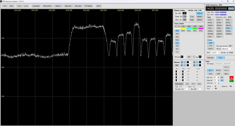

Looking with a spectrum analyzer at 11913 H from 123w, there is no signal there. Nothing near by either. Even if it was too weak to lock, the spectrum analyzer would still show a signal.

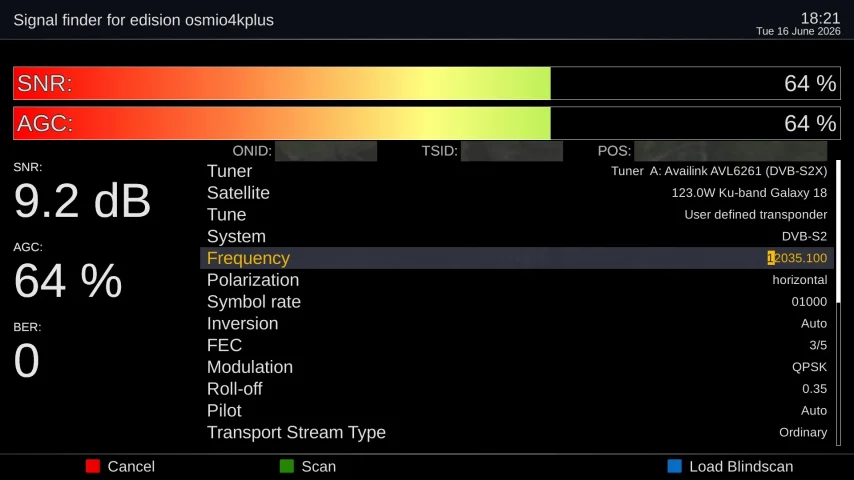

This reference says the Blockstream transponder frequency on Galaxy 18 is 12035.1 MHz Horizontal. I guess a symbol rate SR is not needed for this application since it's data and not video.
I see a strong transponder on 12034 V 19854.

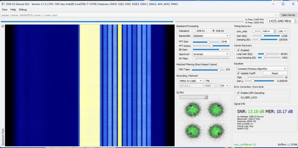

OK, I got it at 12035 H 1000. Scans in on the V9 also, but of course, no program found.
Here's a spectrum image. The 1 MHz signal in the center of the display.
