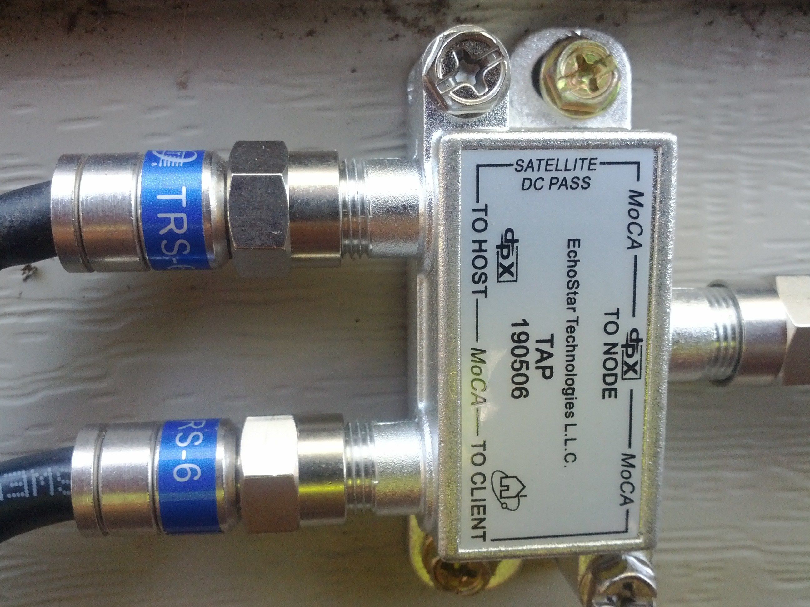

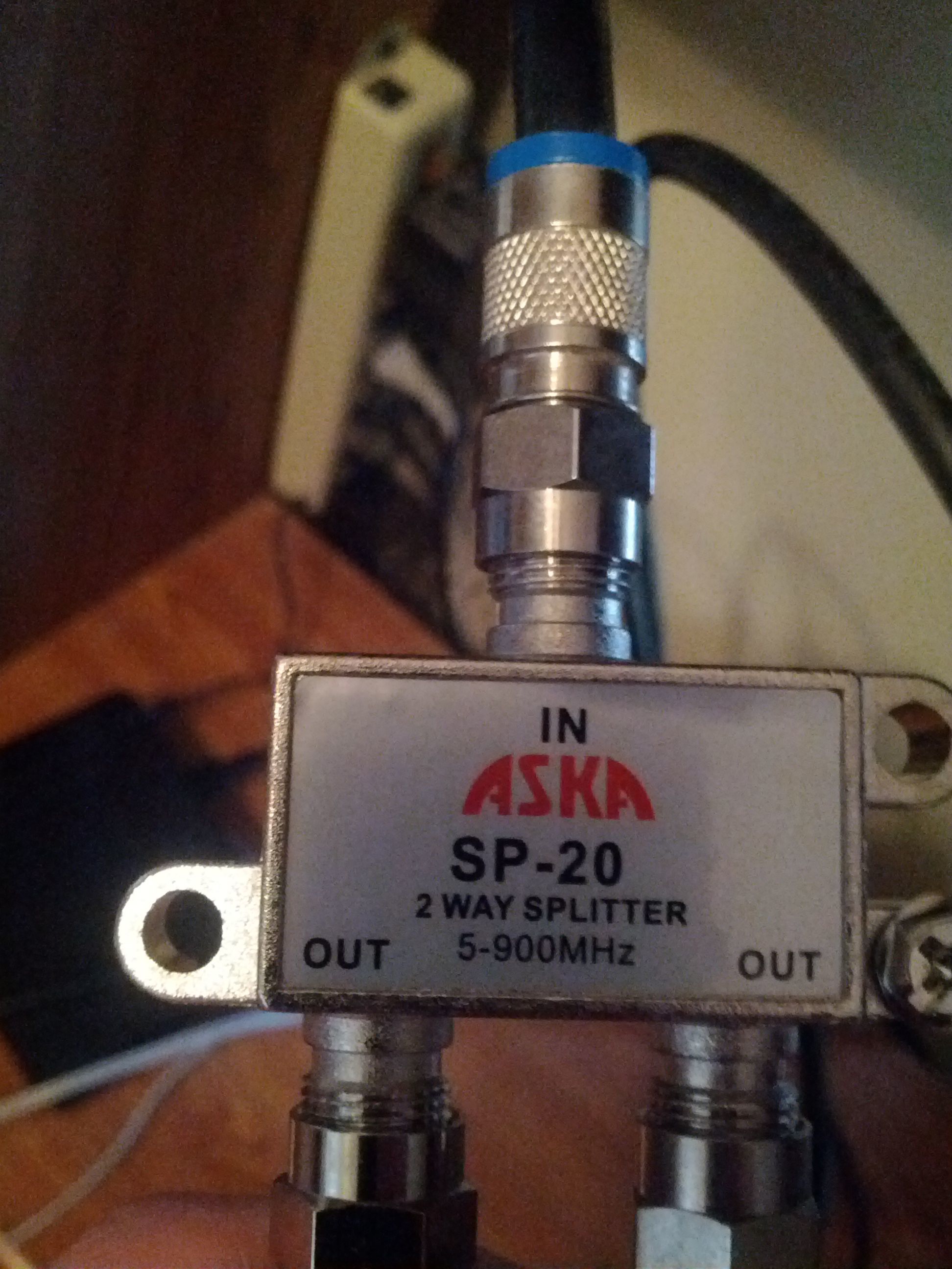

do you really have two taps? or one tap and one splitter?
if you really have two taps, then all the cabling past the node needs to be 3Ghz rated RG6.
Looks to me like Tap 1 is mislabeled and should be a splitter in your diagram, but you'll have to confirm.
Pictures of Taps 1 and 2.
