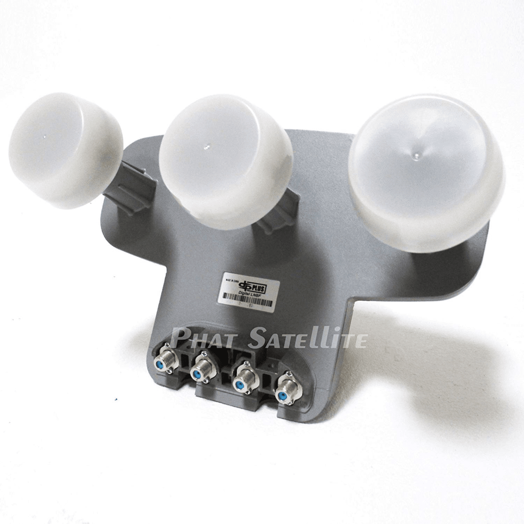

Ok so I was able to get a 1000.2 antena, the LNB says LNBF DPPlus and it has 3 outputs and 1 LNB input just like this picture. Back to my original question, can I run just one single cable from port 1 into the Wally to get 110 & 119 satellites or do I need a switch?

If you use the 1000.2 dish, you'll get 110, 119, and 129 all over one cable from the lnb. The switch is built in.
