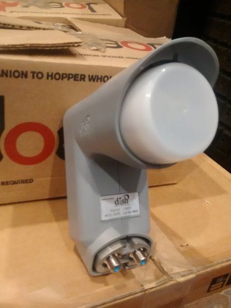

A partial answer you don't have DPP LNB's if you have single or duals on your dishes. A DPP TWIN was made for dishes such as the 500 or original 1000. All that really means is band stacking was used instead of voltage switching used on Legacy LNB's (original DISH or Directv LNB)
DPH42 takes DP LNBs and converts them to work on hybrid systems giving correct frequencies and satellites.
If you can see 61.5 and 72.7 you only need 2 dishes to get all of DISH's programming. 61.5 & 72.7 will work with your existing Hopper 1.
Sorry if I called my LNBs by the incorrect name. I've attached a picture to show you what type I use.
