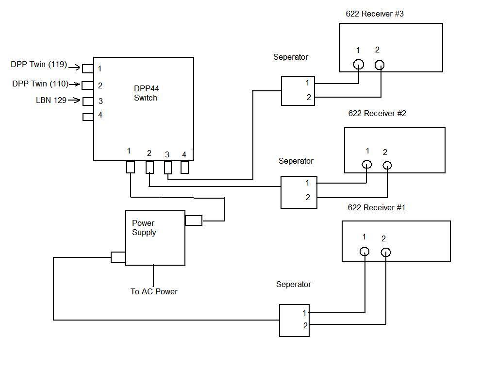

I was looking at the power supply for the DPP44 and have a question. There are two coax connections coming from the power supply. One is labeled to go to the switch receiver 1 position for powering the switch. The other says to go to the receiver in. Do I need to have one of my receivers connected to the switch power supply?
yes, you have to have one of the receivers connected to the power supply(the connection will be as follows: DPP seperator into port 1 and 2 of the receiver, then the to DPP lnb connection of the seperator will go into the to receiver port of the power inserter and then the port on the power inserter labeled as to switch will go into port 1 of the switch.) Also, the length of the copper from the end of the F connector on the coax cable could be the culprit as to why your switch is not working, i tend to leave the copper anywhere's from 3/8 - 5/8 of an inch from the end of the F connector when connecting into the ports of the switch. hope you get it sorted out.
Here is a diagram of how I think I should connect the switch based on the previous post. Is this correct? If it is I will try again tomorrow.

yes, that is the correct setup, just make sure the power inserter is installed correctly with the to receiver end going to the receiver (seperator) and the to switch port 1 side is going to port 1 of the switch. make sure to run check switch once you have everything wired up as per your diagram. nice diagram btw:)
yes, that is the correct setup, just make sure the power inserter is installed correctly with the to receiver end going to the receiver (seperator) and the to switch port 1 side is going to port 1 of the switch. nice diagram btw:)
Thanks for the reply. I will keep my fingers crossed that it works. I did not have receiver one connected to the power supply in my previous attempts to connect the system.

You absolutly do NOT need to have a receiver connected on the receiver side of the power inserter.
It could be possible that power inserter doesn't work. To check you can hook a receiver directly to port 1, if you get anything then, you will know it's the inserter. Don't leave connected with out a inserter very long.

i would first do as n0qcu suggested, if that yeild's no result i would then change the f connector of the 119 lnb at the switch and leave the copper out from the f connector and reconnect to lnb port 1, then change the f connector at the switch going to port 1 receiver 1, i would then disconnect the seperator and plug the cable directly into tuner 1 of the 622 (receiver 1) and go to the point dish screen and make sure tuner 1 and sat 119 are selected and see if you have signal, if so then the issue lies with your f connectors.
