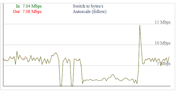

EDIT: Just hooked up the spare Joey to a WRT54GS with DD-WRT in wireless bridge mode. No coax hooked up whatsoever. Router is an ASUS RT-N16 (DD-WRT also) with two HAWKING HAI15SC Hi-Gain 15dBi Corner Antennas, and the third Hopper (has NO MoCA connection to the other two Hoppers) is connected via the Dish-supplied NETGEAR Wireless-N Adapter. WORKS PERFECTLY and that's halfway across the house. Attached is a reading of the bandwidth used when tuning into HD (HDNET) and SD (some random ENCORE SD channel.)
Note: It says almost the same bandwidth up AND down because when two wireless devices communicate data is sent to the router and then back to the other device and vice-verse. Also note that on the graph before the first drops is the HDNET HD bandwidth usage, the lower amount is ENCORE SD, then after the spike near the end we're back on HDNET.
This is neat as I can see almost EXACTLY how much bandwidth each channel has.
So my guess is that Hopper integration will work exactly the same way. We'll see!
Given that Dish HD is MPEG4, MPEG4 needs half the bitrate of MPEG2 (OTA) thus, at 7Mbps, it is the equivalent to 14Mbps OTA. Not too bad.
