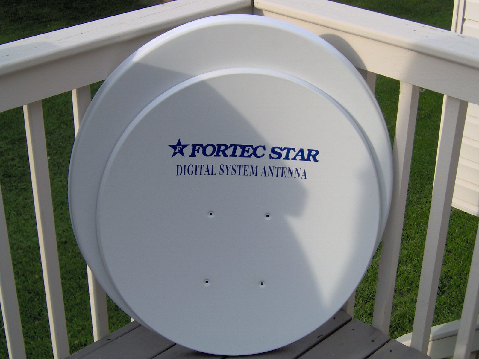

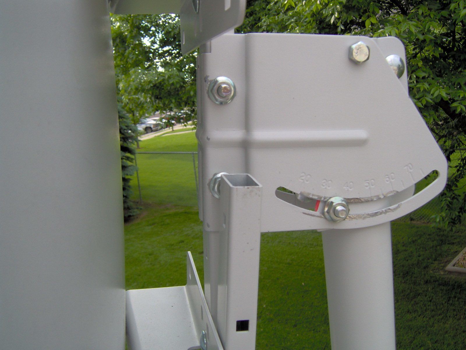

You CAN'T just replace the reflector as the focal distance will not be the same, EVERYTHING must be changed :(

and the difference in the arm for mounting
and the difference in dish size :)

Odd. Sorry for the bad advice. When I received my replacement, parts we're EXACTLY the same. Only difference was the reflector. 1st one was supposedly a 33" then my replacement ended up being a 31". Maybe this whole time I actually did have a 31". Just keep in mind, PSB is a professional installer, I'm not. But then again, this is a hobby. We all live and learn.
Thanks! Looks like it would be easier to just swap the hole dish assy. I am thinking maybe my next upgrade might be that. I have a birthday in Jan. :) Gotta give my wife ideas :)
