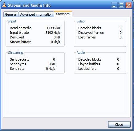

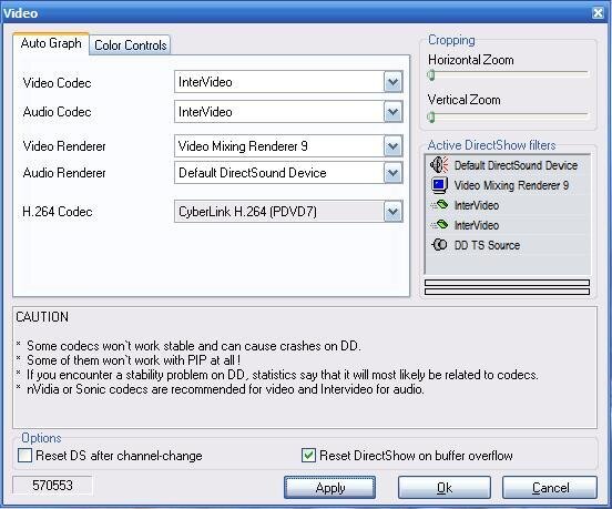

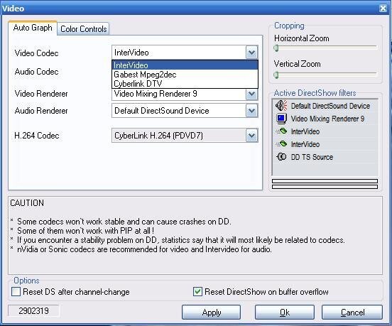

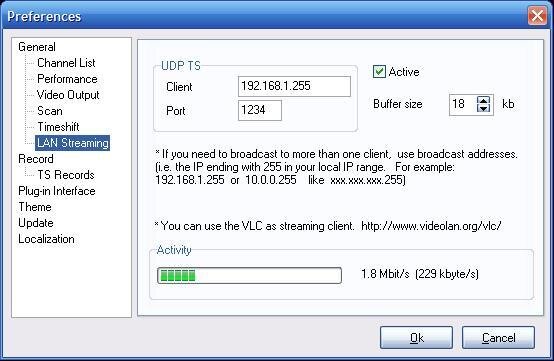

Today I installed DVB Dream and hooked it up to my G10R dedicated dish. I like DVB Dream MUCH BETTER then MyTheathre.
Anyways I wanted to go down the stairs and play XBOX360 for awhile but I also wanted to watch RTN, so I tried getting VLC to work on DVB Dream but have had no luck.
I suspect it is a CODEC issue. I went to the DVB Forum and installed all the codecs they suggested (WinDVD)
I can connect to the server with no problem and get data, but it does not decode the video (see the pictures down below)
Anyone know how I get this to work?

Besides installing the correct codecs, you may have to change the priority they are used, you can use the program gSpot (http://www.headbands.com/gspot/) to see which codec chain is in use for a particular filetype, sometimes there will be a filter insterted into a chain and can mess things up, and use, DirectShow Filter Manager (http://www.softella.com/dsfm/index.en.htm) to add/remove/change them to the correct ones. Make note of what changes you make so you can always go back.
Hope it helps.

If you are streaming to VLC it has nothing to do with the CODEC's on the pc with DVBDream since it's just sending a stream. It's up to VLC to decode it.
Are you able to get VLC to display the video on the machine DVBDream is on?
i.e VLC input is the network stream 127.0.0.1:<port> where port is whatever DVBDream uses. (Can't remember as I am at work)
Any firewall issues to deal with?
Have you tried unicast streaming directly to your xbox IP instead of xxx.xxx.xxx.255?
How about streaming a video file using VLC to VLC on your xbox?
And I agree, the codecs are irrelevant to streaming to VLC.

It appears to be an issue with DVB Dream.
As this morning I was in Tsreader and pulled up the transponder with the FTA Angel 1 channel on it. I double clicked on the picture of Angel 1 and VLC opened up with the Angel 1 stream.
So its not an issue with VLC.

Have you had any success with DVBDream streaming yet? Last night I brought up DVBDream 1.3a and successfully streamed to another machine running VLC on my LAN.
DVBDream LAN settings were 192.168.1.201 (address of the machine I'm streaming to) port was 1234. On that machine VLC opened the stream using "Open Network Stream" "UDP/RTP Port 1234" and up came the video.
I also had to stop Norton on the machine running DVBDream from blocking port 1234. It seemed to think that a trojan of some kind was coming through that port. The client machine was a Mac so I don't bother running antivirus/trojan software on it.
