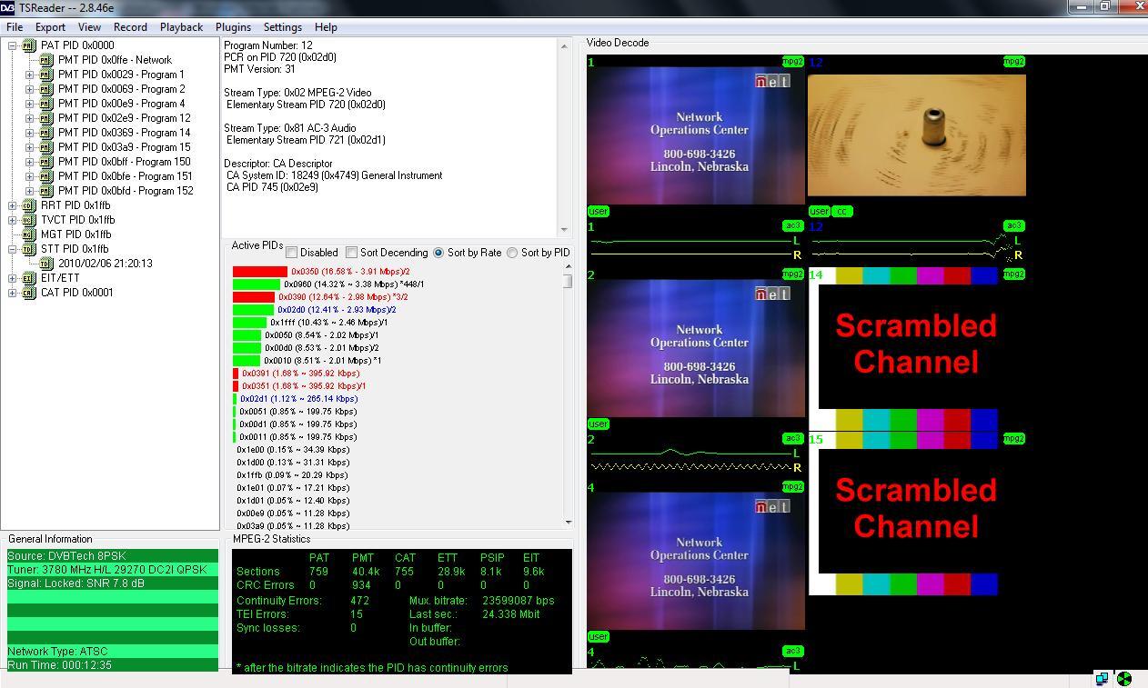

Scott Greczkowski Welcome HOME! Staff member HERE TO HELP YOU! Cutting Edge Sep 7, 2003 105,308 34,491 Newington, CT Feb 5, 2010 #4 Can someone let me where the files go to make this work in TSreader?
digiblur SatelliteGuys Master Jun 8, 2005 14,190 4 Louisiana Feb 5, 2010 #5 Probably in the Source folder with the rest of the dll files for the various cards.
P photoman76 SatelliteGuys Pro Jan 8, 2005 3,291 1 Feb 5, 2010 #6 It's been awhile since I installed mine. If I remember correctly, right click on DVBTech.inf and select Install. Put dvbtech 8psk firmware.bin and TSReader DVBTech 8psk.dll in the Sources folder in TSReader.
Scott Greczkowski Welcome HOME! Staff member HERE TO HELP YOU! Cutting Edge Sep 7, 2003 105,308 34,491 Newington, CT Feb 5, 2010 #7 Great thanks, some folks told me I can pick up ZK digicypher things with this, so I want to give it a try.
P photoman76 SatelliteGuys Pro Jan 8, 2005 3,291 1 Feb 5, 2010 #8 Yes, it does ZK fine. Try NET on Galaxy 28 3780 H 29270 Is anyone working on a firmware update to fix the Turbo QPSK problem?
Scott Greczkowski Welcome HOME! Staff member HERE TO HELP YOU! Cutting Edge Sep 7, 2003 105,308 34,491 Newington, CT Feb 6, 2010 #9 It works And the PQ looks quite good as well. Got to go on the hunt for MORE Attachments dc2works.jpg 142.2 KB · Views: 222
