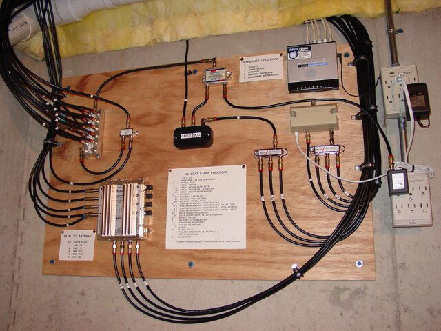

That is how I do it Geoff. I have three DVRs (six tuners) agile modulated out to all of our 11 TVs (12 coax wall locations) in my home thru splitters and combiners. The three DVR locations have four coax each at the wall plate. Satellite In, OTA Antenna In, Modulated Out, and Home Distribution Modulated In. No diplexers. I have the three DVR's modulated out on channel 80, 85, and 90. Comes in handy if a program is recorded on a DVR that you want to watch at another location. Also have very basic cable coming in too on an A/B switch as a last resort backup. I do have one diplexer installed and it goes to my kid's DVR. The home distribution system is diplexed with the satellite coax to his room. I would have four coax run to his room too if it wasn't such a nightmare to snake the walls. I will never live in another two story home again. Everything works great and not too complicated.
I like the pic. Nice job. We have a 625 and a 722. The Channels are modulated on Channel 4 and 85 (Tuner 1 is 4 and Tuner 2 is 85 on the 625) and channels 73 and 75 on the 722. I agree that it is nice having all tuners available as it lets you see anything that is playing or recorded (even when the tuner I normally use is recording) or when a channel is available via HD only.

Yep, it is nice for sure to be able to watch anything from everywhere. We were long time cable customers so I tried to rig it up the best I could with the advice from some helpful members of this forum and the Dish set up charts. I think it is really awesome to be able to record three channels at the same time. It sure comes in handy. My OTA picture quality is outstanding. We don't ever use the tuner one out signal from the DVRs. I have ours on channel 77, off, and 3.
