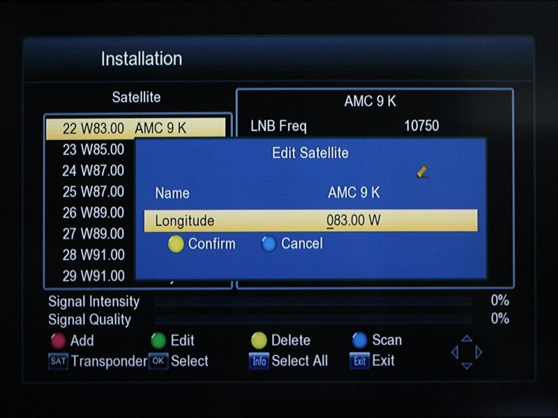

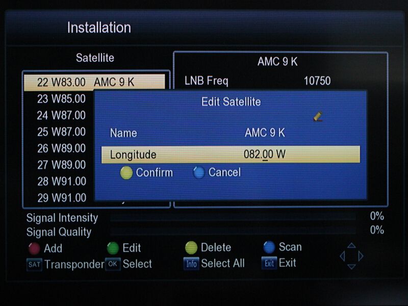

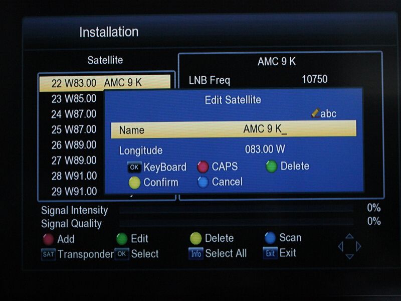

On the ku side can you change the sat from say 103.0 to 104.5 etc in usals mode ?
and does it work if you can ?
Yes, both the satellite name and it's longitude can be changed. Here are a few pics showing 83W being changed to 82W.
Highlight the satellite to be changed and press the green button for edit mode. Here you could change the satellite name (but I didn't).
Arrow down and highlight the number to change (in this case the 3) and press the new number on the remote (the 2).

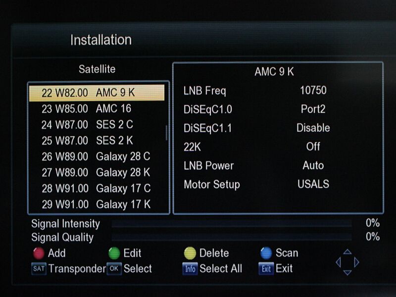

Yellow button confirms changes and after exiting 83W is now 82W.
Sat Info Changed.jpg :)
View attachment 127804 View attachment 127805
View attachment 127806 :)
