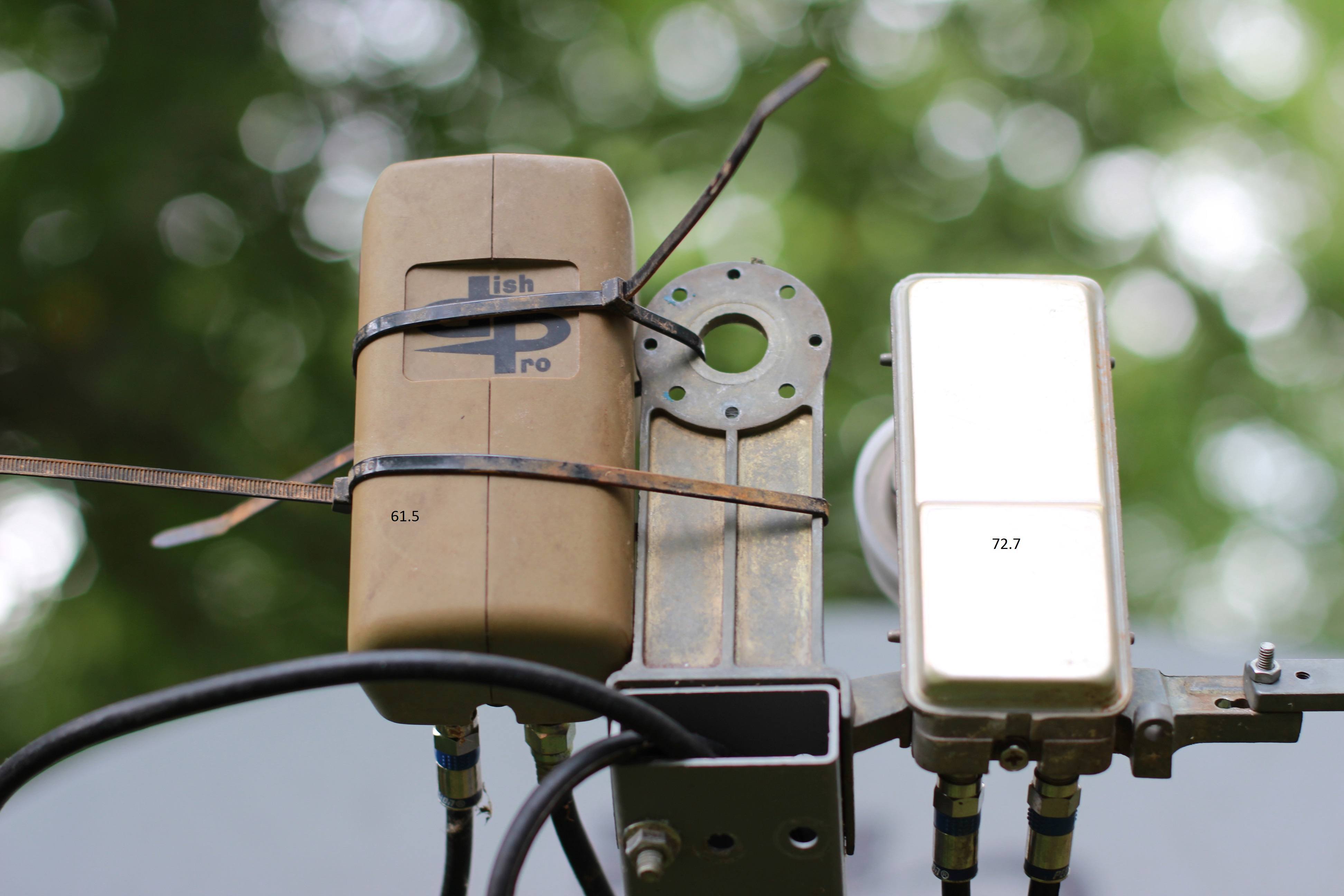

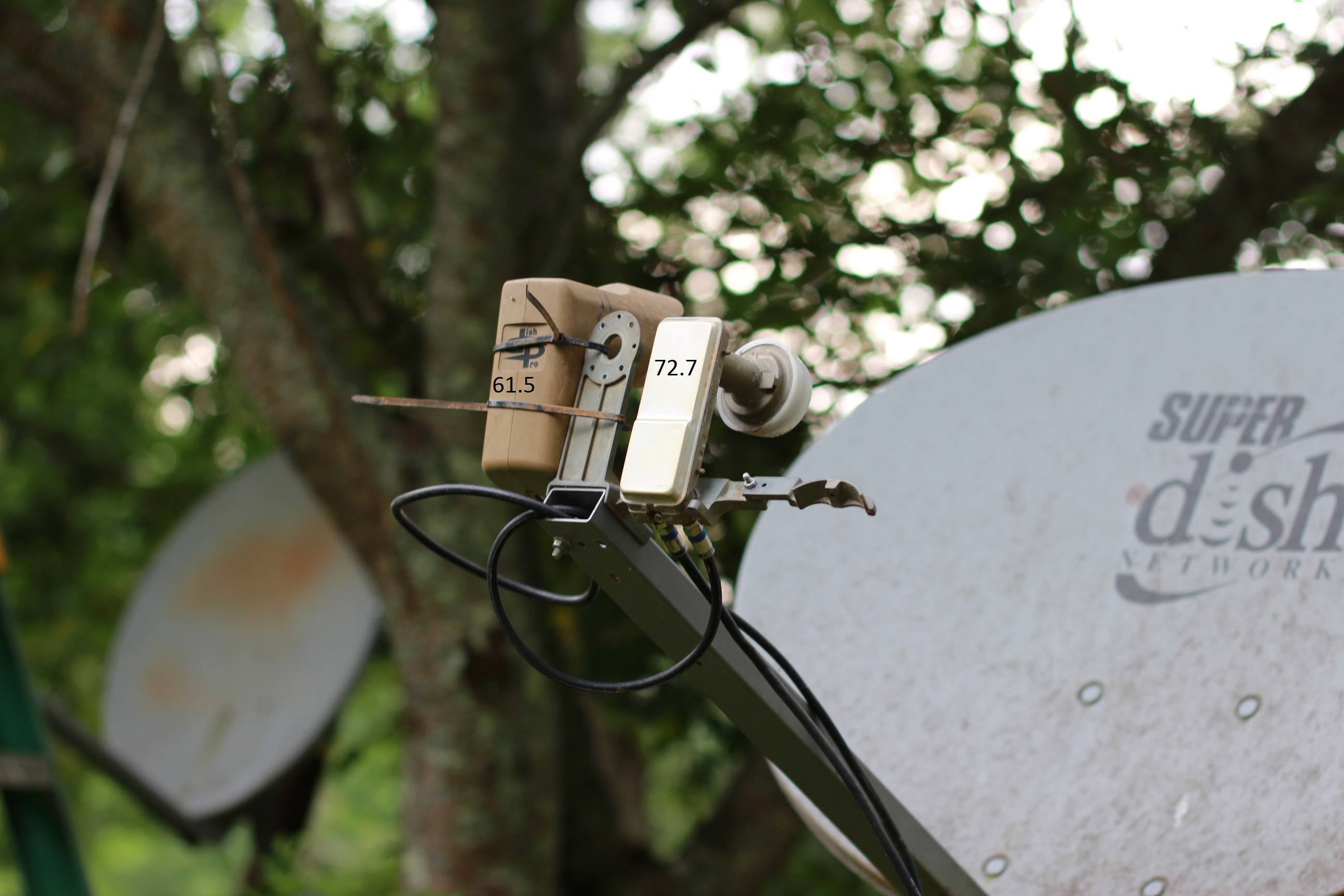

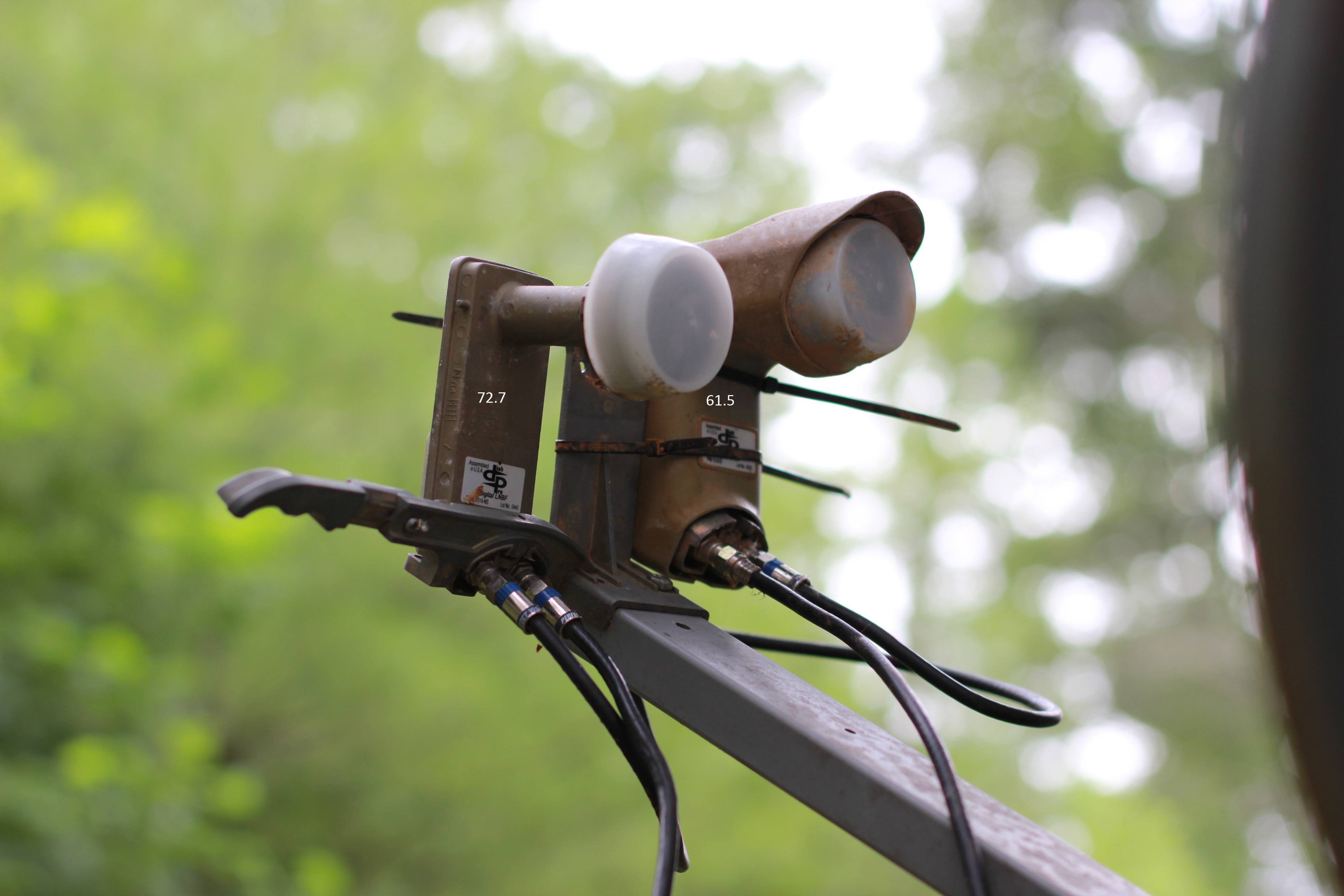

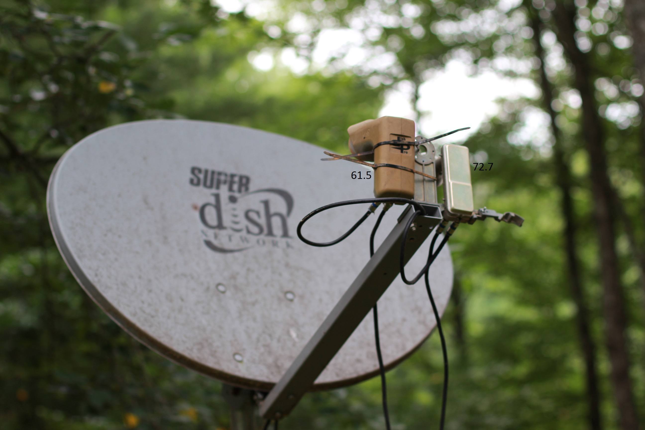

So I took it home and did I clean it nope as you can see in the pics below. Nope I just mounted it and decided to try something I have been thinking about for awhile.
I turned it into an Eastern Arc dish, just 61.5 and 72.7. What I did was use what the book says for an an Eastern arc dish. I used the elevation and skew right out of the book. I removed the 105 deg linear LNBF, and I aimed the 110 LNBF for 72.7 and peaked it for best signal.
Now the next part, where to put the other LNBF to get 61.5....so hand holding it and playing around I found that it worked the best right up against the bracket for the old 105. I knew it would be close, but wow that close....awesome. So I just used ties and strapped it on. Made a slight adjustment and tightened the zip ties.
Works like a charm. I have great signals on both birds at the receiver. So maybe this can help someone else, if not.....

Now mind you I have not clipped the extra on the zip ties yet or made it pretty....but there it is. I will use it until it dies or DISH changes something again. ;)

I never did like the signal levels from my Eastern Arc 1000.2 dish. I just two days ago swapped it out for two seperate Dish500's with the I-adapter and DP lnbs. My signal levels for 61.5 and 72.7 came up 10+ points or more all around. Dish500's are good with that I-adapter and a single lnb set in the middle. They really do gather quite a lot of signal for their size.

Yeah the zip ties are just a temp thing just to find the right spot.
