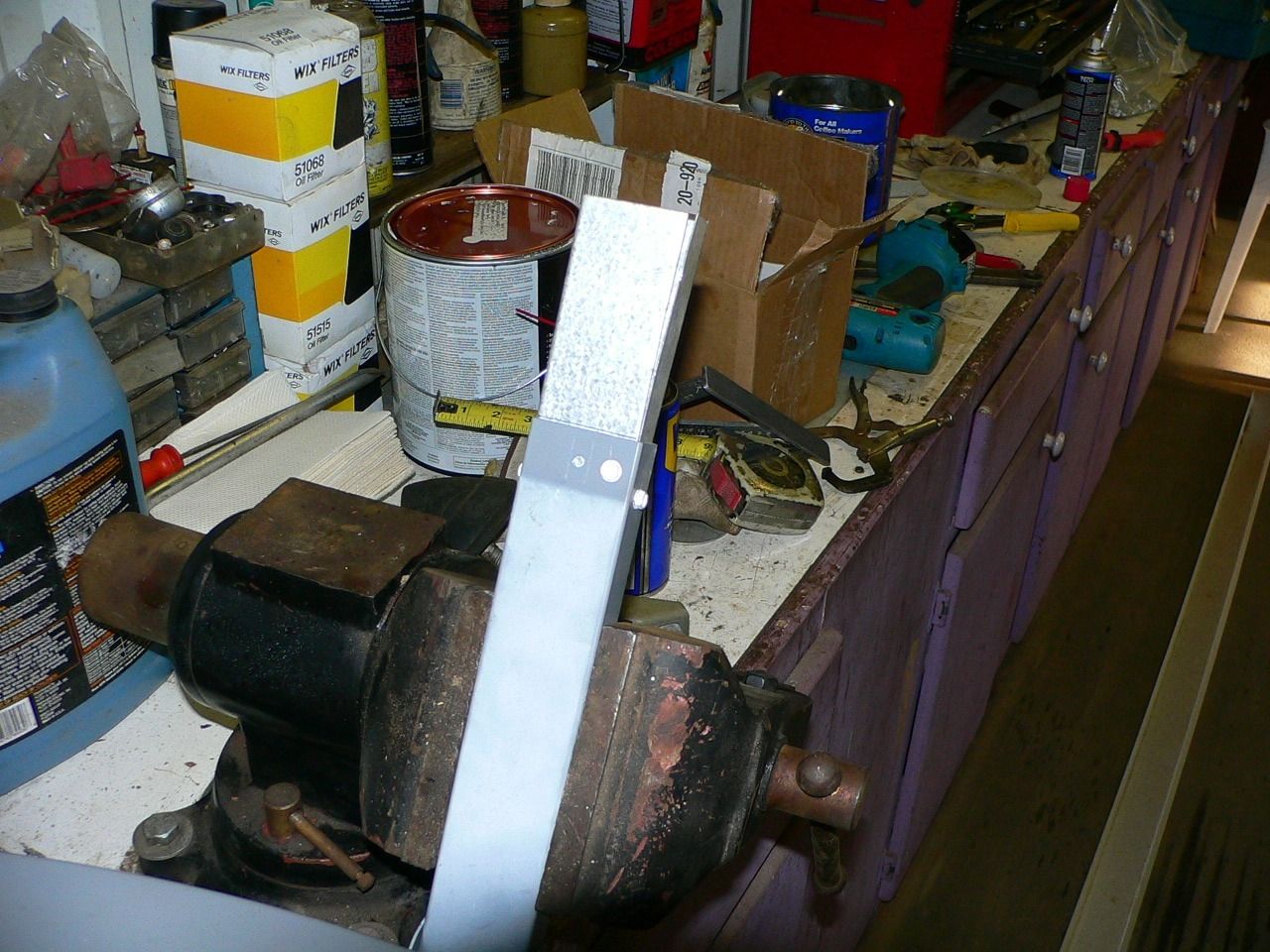

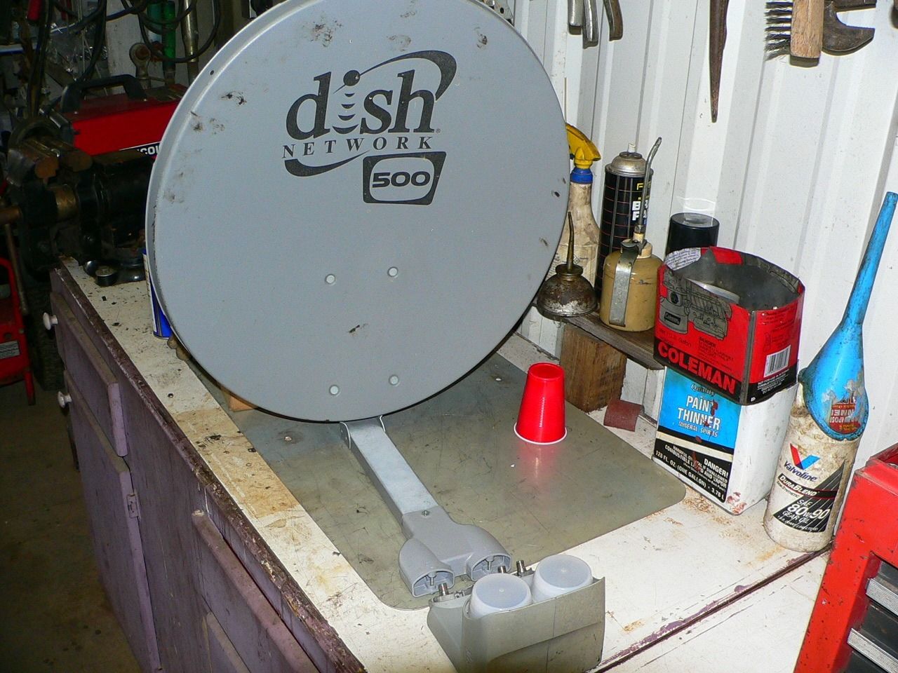

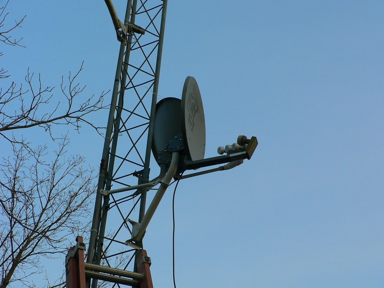

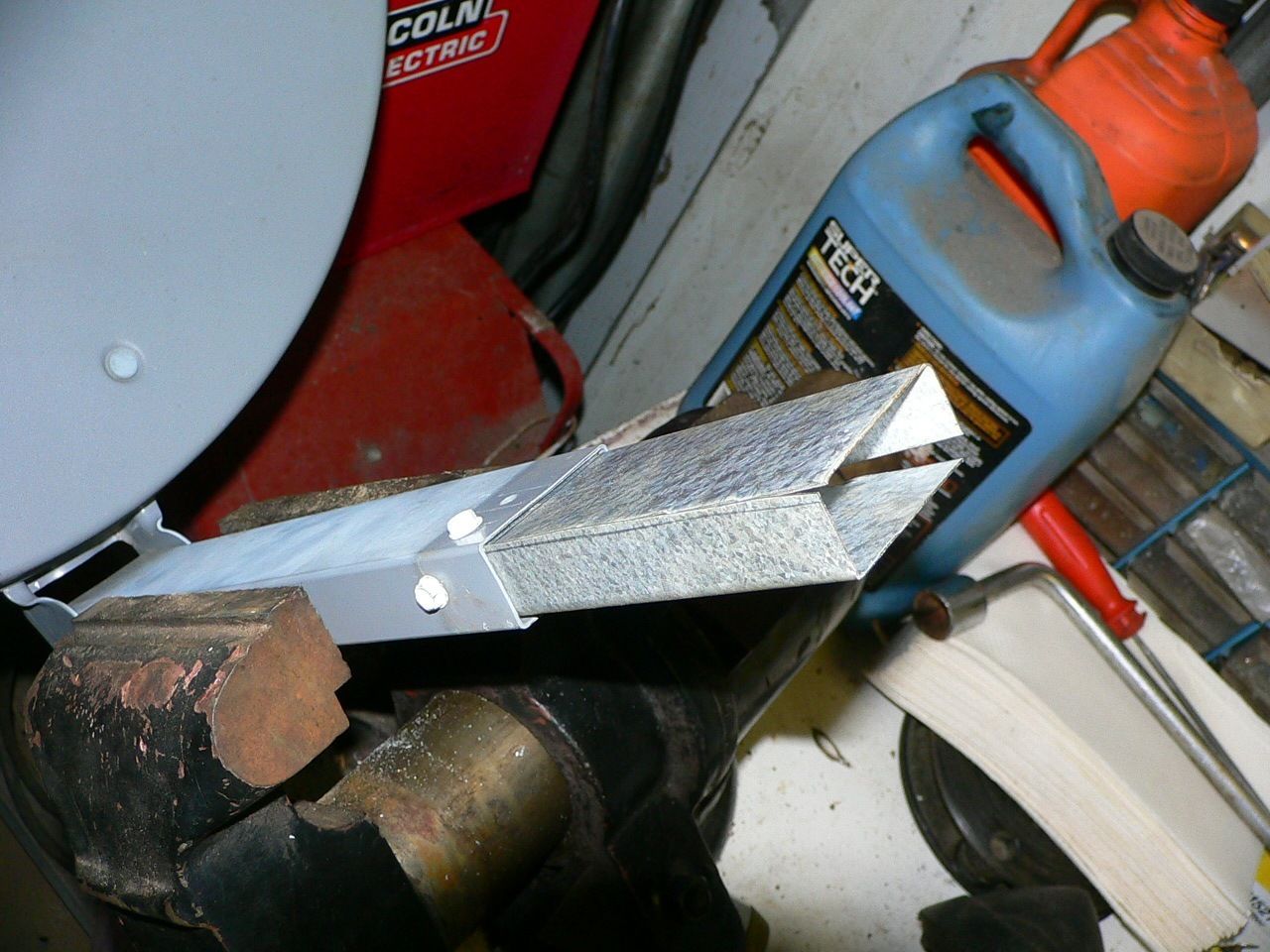

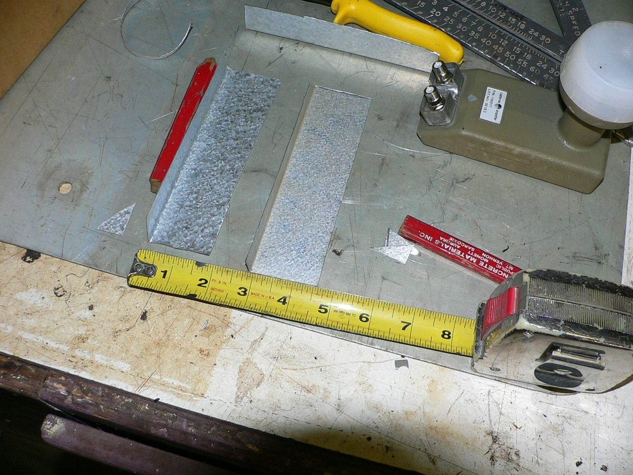

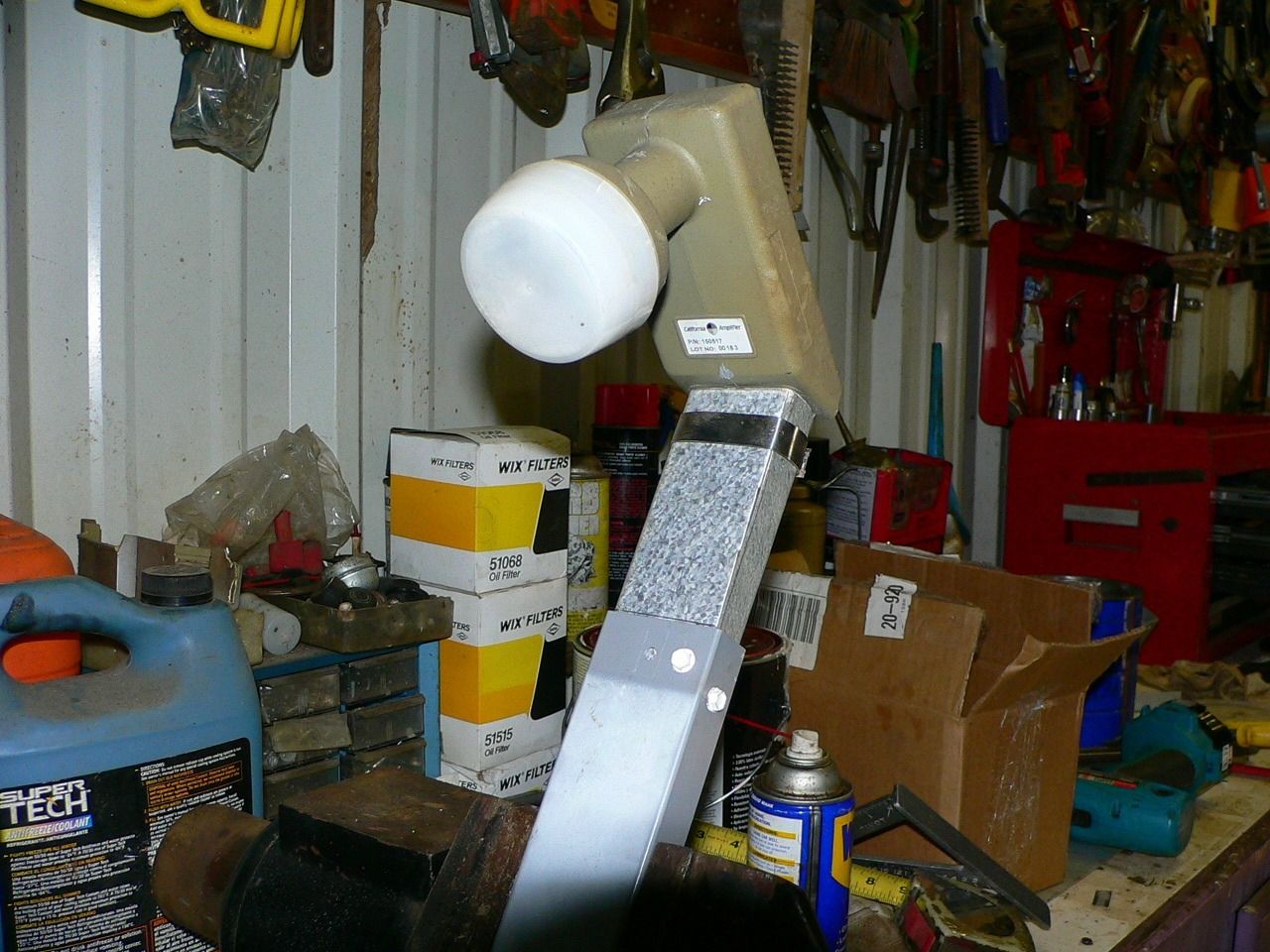

Here is what I did to take a Dish 500 and put an old legacy LNBF on it for use on 148W.

Very Nice Pictures phlatwound!
Love that it is on that tower!! :cool:
