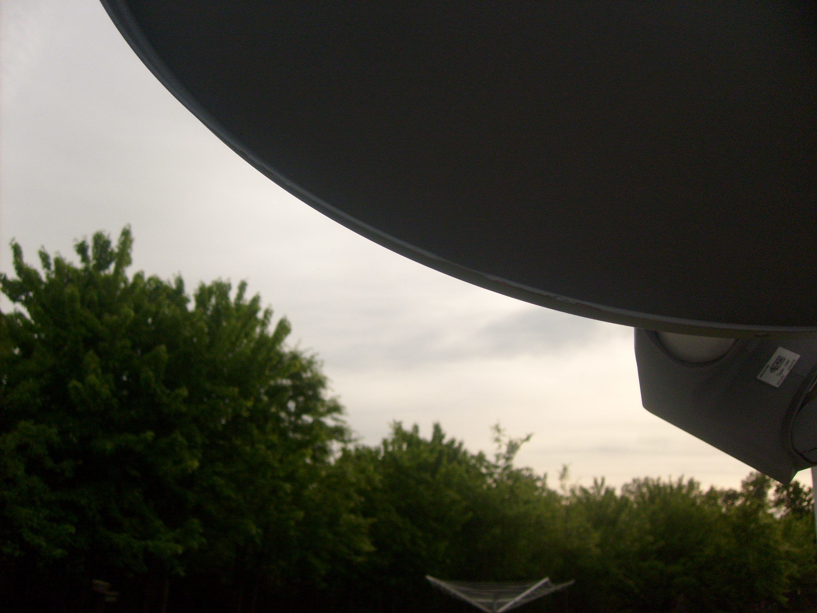

This question may been asked before so sorry to bring it up again! I did try to search the forums today for it but the OS I am on now is not the normal one I use for the site and it was giving me fits today, I am stuck here in the office today and the computer in here is not too friendly on the forums! Bear with me please!
Is it even possible to get EchoStar 148 W on a Dish 500? I have seen threads on it working on subscriber boxes in the DN forum, want to use one to point there for the ITC stray things over there from time to time FTA.
I have a Dish 500 with a PLUS LNB on it on the backside of my house that was given to me a couple days ago so let's put it to use if it can be done!
It is mounted on a wooden crate on top of my utility trailer by my office.
I used to get it on the 80CM but there are tree growths now that is limiting the LOS to the bird. Going to set the 500 back a bit (Clear LOS) for a possible try!
One thing I did notice is I need 9.5 degrees elevation for this and the dish only goes to 10 degrees but I think I can work around that with some rigging.
Anyone done this with any results and can it be done with a 500? Can the PLUS DP LNB be used on it for FTA?
If it can be possible I will start to try this in the afternoon tomorrow weather permitting!
Possible great, not worth using the 500 and use another type, that is OK too! I just don't want to waste time trying!
Thanks for any suggestions!

I was just scoping a shot of my LOS out this morning too for 148. ;)
I loved trees until I got into satellite dishes....

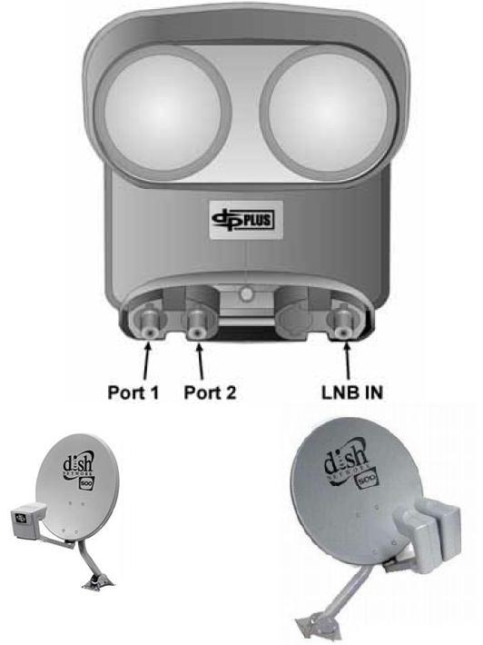

- "middle LNB"?
I think Tony meant that the middle connector inside the PLUS.
It has Port 1 - Port 2 - Extra or Second Dish LNB In ports. He meant the middle connector.
I do believe both ports have the 110 & 119 locations though.
Anole, I have a Dish Legacy LNB separate Y yoke off another 500, better to use that instead of the PLUS Head?
If OK or a better way what side of the yoke to use the LNB on?
At the Skew set to 90 Degrees would it make a difference?

ah crap I was thinking something else...thinking of the 110/119/129 LNB
you would use the LEFT (from the pic above) eye...that is what is normally 119

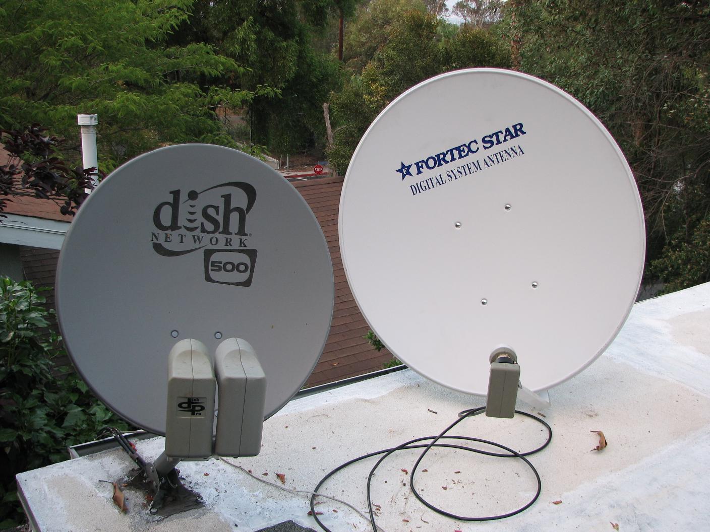

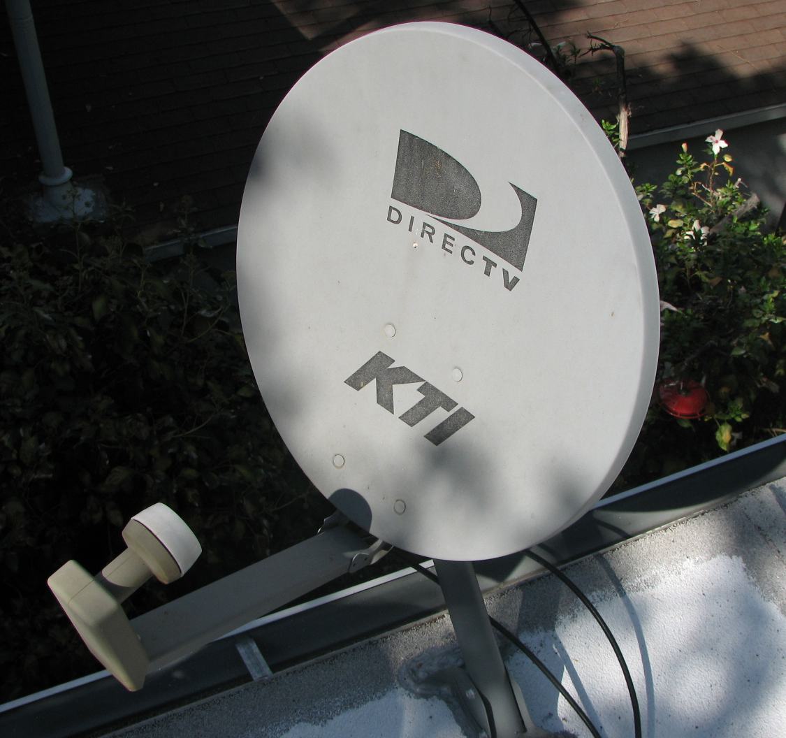

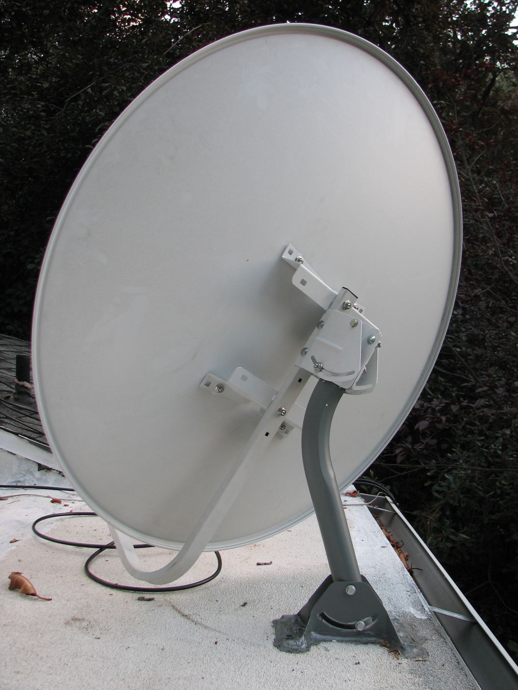

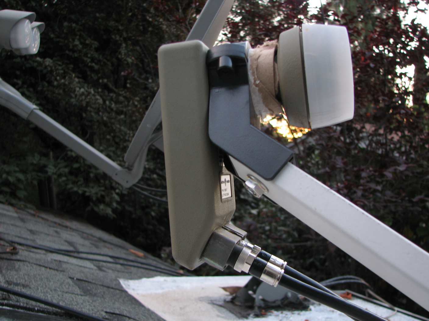

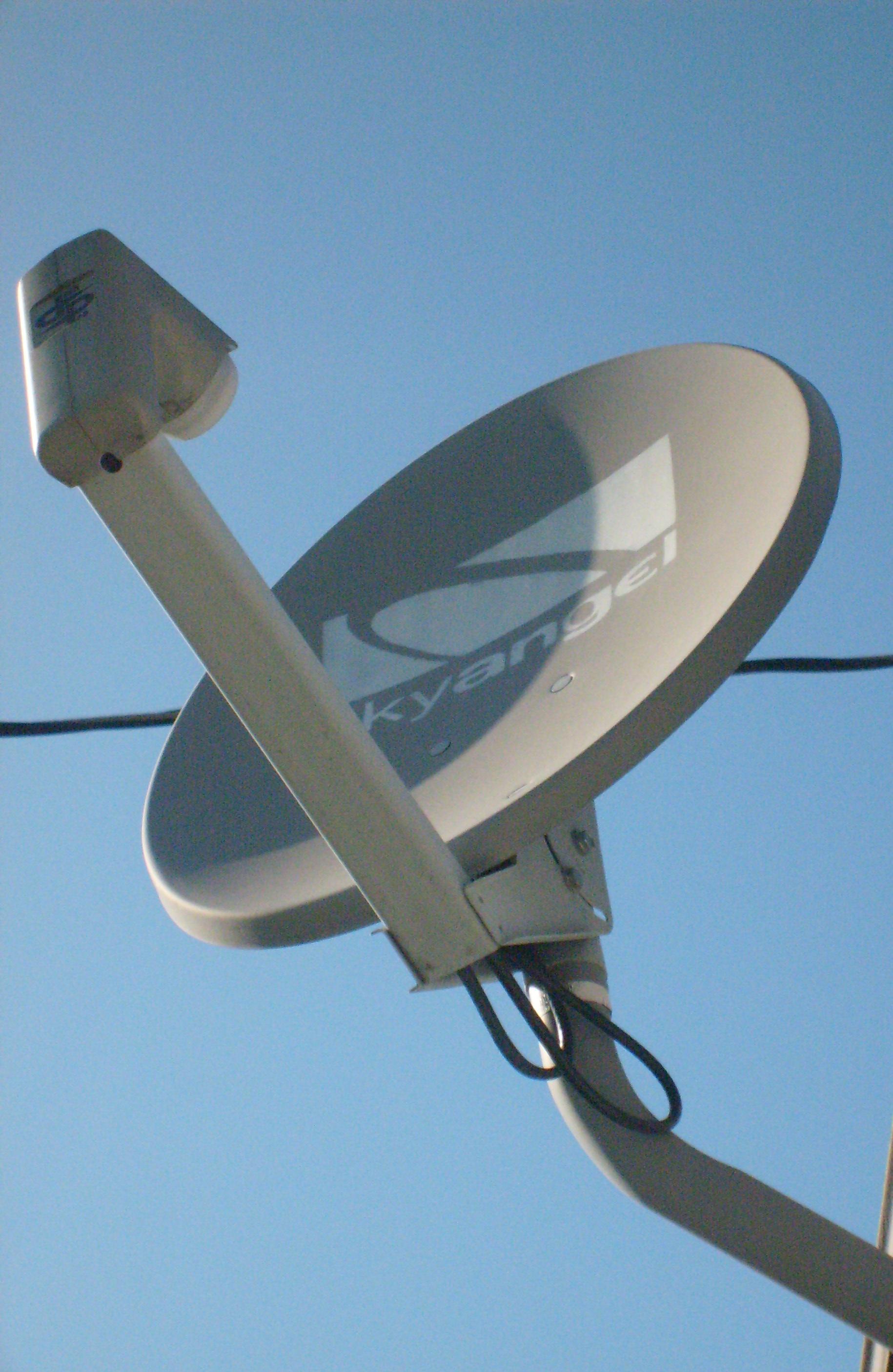

An 18" dish should even work for 148W. The first picture is of such a dish, and as you can see it was partially obscured by trees (I took that during a solar outage, which you might be able to deduce from the LNB's shadow). That dish worked fine last summer, but this year after the leaves came back the transponders I wanted were right at threshold. I think about 40 percent of the dish was obscured. I took the dish off the pole and put a Dish 500 there instead, with a single "legacy" LNB in one of the ports of the dual yoke, and the signal quality was better than ever. I'm always surprised at how well they work, even with the offset LNB.
However, it's probably all a moot point. EchoStar 5 is being moved to 148W, and is expected to replace EchoStar 1. I'd rather see it moved to the bottom of the ocean where it belongs. :D It remains to be seen how it will perform at 148W, but when it was at 129W a lot of people needed 75cm or larger dishes to get a reliable signal from it.
I happened to have a spare Fortec 90cm, so I decided to get ahead of the game and put it where the Dish 500 was. The Fortec's pole wouldn't fit on the DirecTV roof bracket, so I had to improvise a little with the existing pole. You can probably guess what I put around the LNB's neck to make it fit in the holder. :o

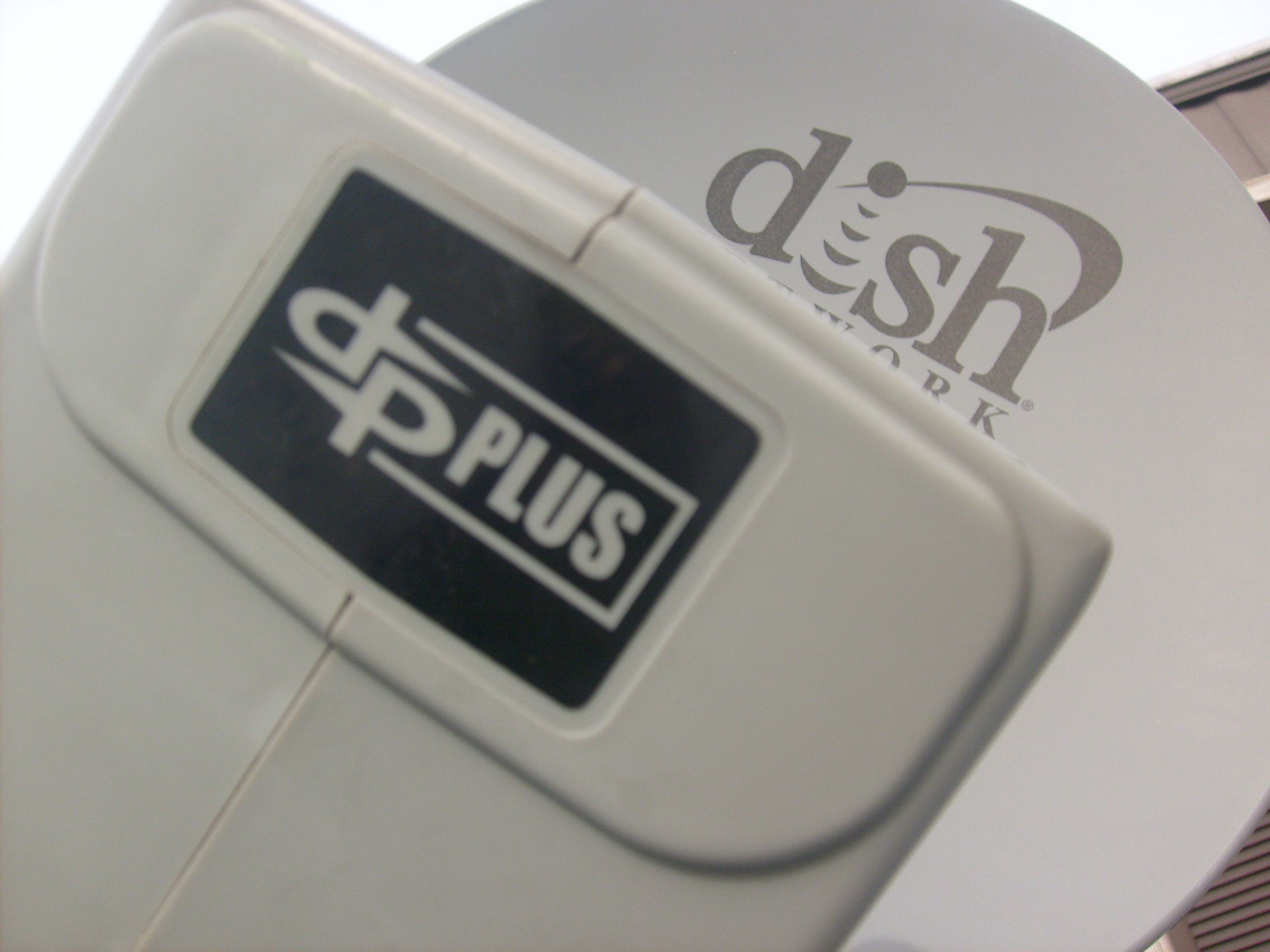

Ice, at 90 would it make too much difference which port to use?
no. But the left one seems to work better from what I've tried.
