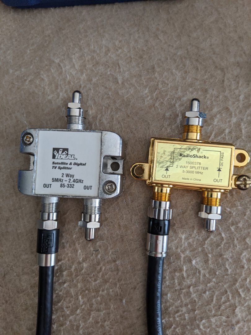

EmCommSat The dual port LNBF maybe doable but i would have to run a second line of coax into the RV. I think if i just use a spitter at the ingress before the Edision one leg goes to Orby the other to Edision i should be fine since i won't be using both receivers at once. I think either one of these would do. The ideal one is made for this sort of thing the radio shack should work its in the right range and has the DC pass thru. Half the fun is trying things out and not letting the smoke out ;)

I take that back these spitters will not work -_-
I added them in line between the Edision and the dish motor. Made sure the open leg was capped.
Moved the dish from 116.8w to 67w
It went to 0....
then just nothing. Same when i switched out the splitter for radio shack.
So what can i use to split the signal and use the motor? A physical switch? A/B?

Capped a port? If a resitive load terminator, that will mess up the signal passing.
No need to get so elaborate with quad LNBFs, multi-switches, swapping coax, etc....
Simply use an all port power passing splitter and be sure the Edision OS Mio is on 116.8w and vertical polarity when watching Orby. That is all. [emoji41]
Titanium I put a terminator cap (see the photo i attached earlier)on the empty end if the splitter since i don't have the Orby receiver yet. I just want to see if the motor would still work with the splitter in place. You are right i did not try it with the cap off, the A/V cabinet for the RV it small so let me get my gear back out and will test. Thanks for the advise.
Yep neither of my splitters work.
Does anyone have a model they prefer?
I think the 2 i have pass power from the outs to the in but that's it. Unless that is what you meant by all port power passing splitter? It did the same thing as before. Say I'm at 103w tell it go to 97w it goes to 0 and just stops.

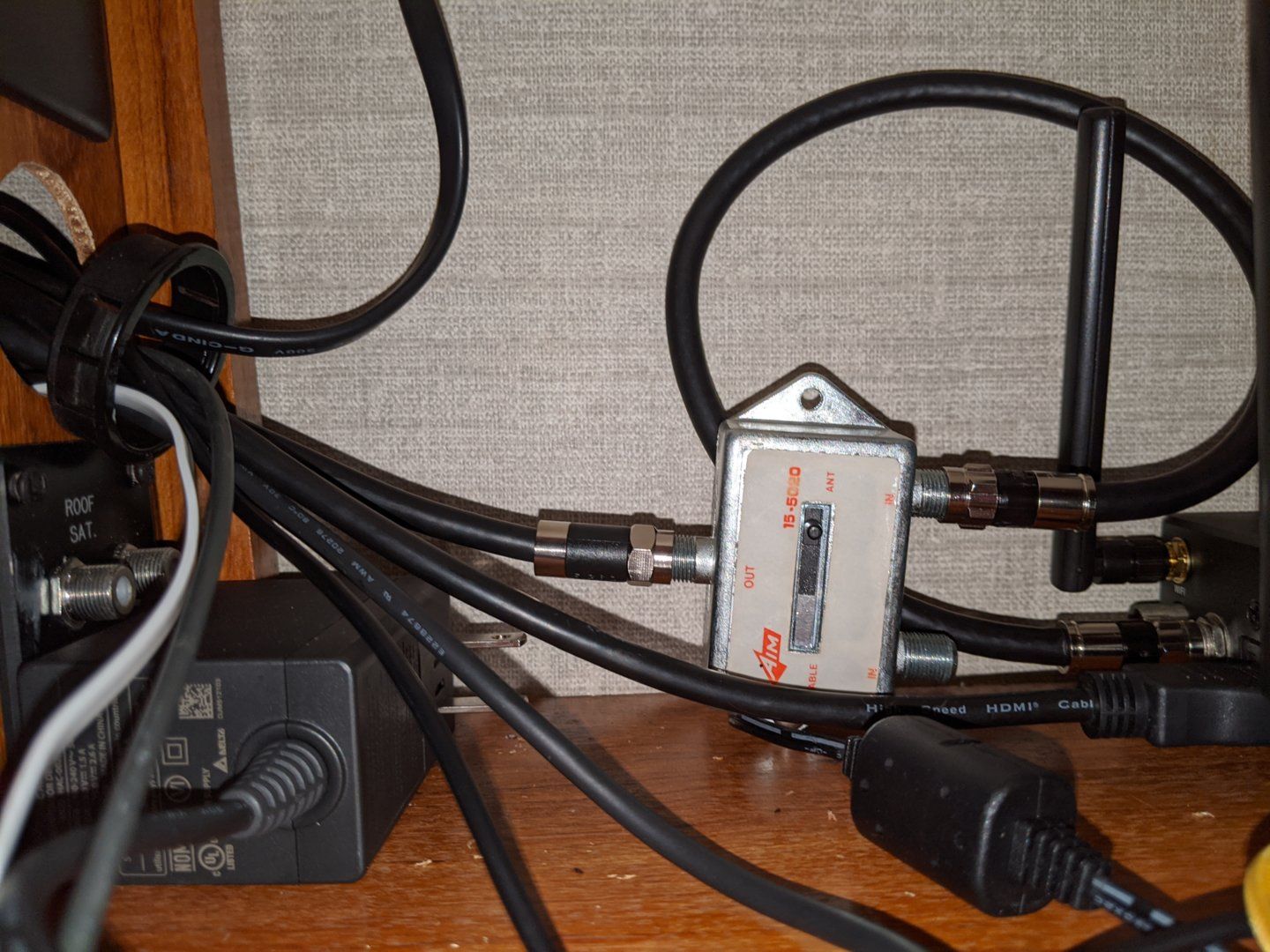

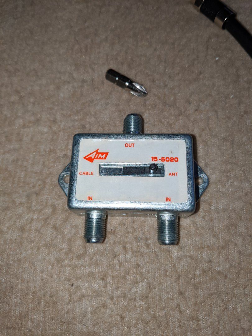

Work around success! Found this old switch. Just connected it to the Edision and i was able to move the dish and change the switch the Edision loses the signal now will be sure when the Orby arrives later this week. I don't see any clear markings on the Mhz it supports but it allowed me to view a HD station so that's good enough for this test.
