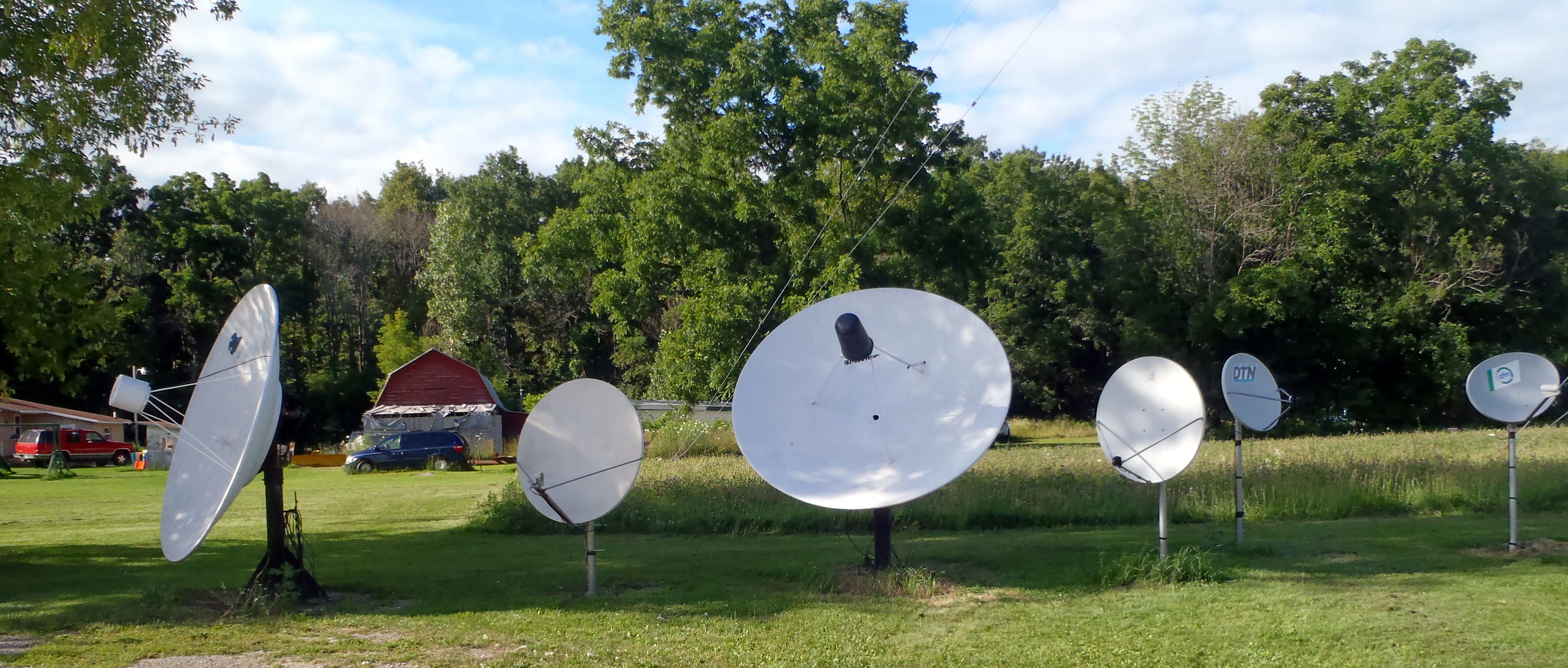

So, finally...all of the "farm" is in use:
From Left to right, ALL functional...
137W fixed for Alaska PBS and others
103W fixed for Cozi-TV
Birdview C/Ku with rotor for sky scanning
1m Channel master (finally tonight) fixed for PBS on 125 (new today.)
.75m DTN dish for 72 West NBC/Weather/CNBC or MSNBC
Newer DTN dish for 97 W (mainly Ebru TV)
Moving tonight to a dedicated 125w dish helped reception immensely! The PBS on the 1m actually performs better than the PBS on the Ku side of the moving Birdview. The scan tonight brought in Montana and OETA with others, and so far, all perform even if quality jumps around quite a bit. I aligned using the transponder with the lowest "Q" and one which jumped quite a bit. A total of 15 "clear" PBS feeds are now available to me. Well worth the work (switching to using the fixed vs. the combined/motorized Birdview feed.) My .75 meter Channel Masters didn't work this well for PBS but the 1m does well. Amazing the difference in one Channel Master dish to another. The neat thing about this dish is that it came from a former radio station I worked-for, was used as the AP news printer feed via a computer. Never thought it would land here with me!

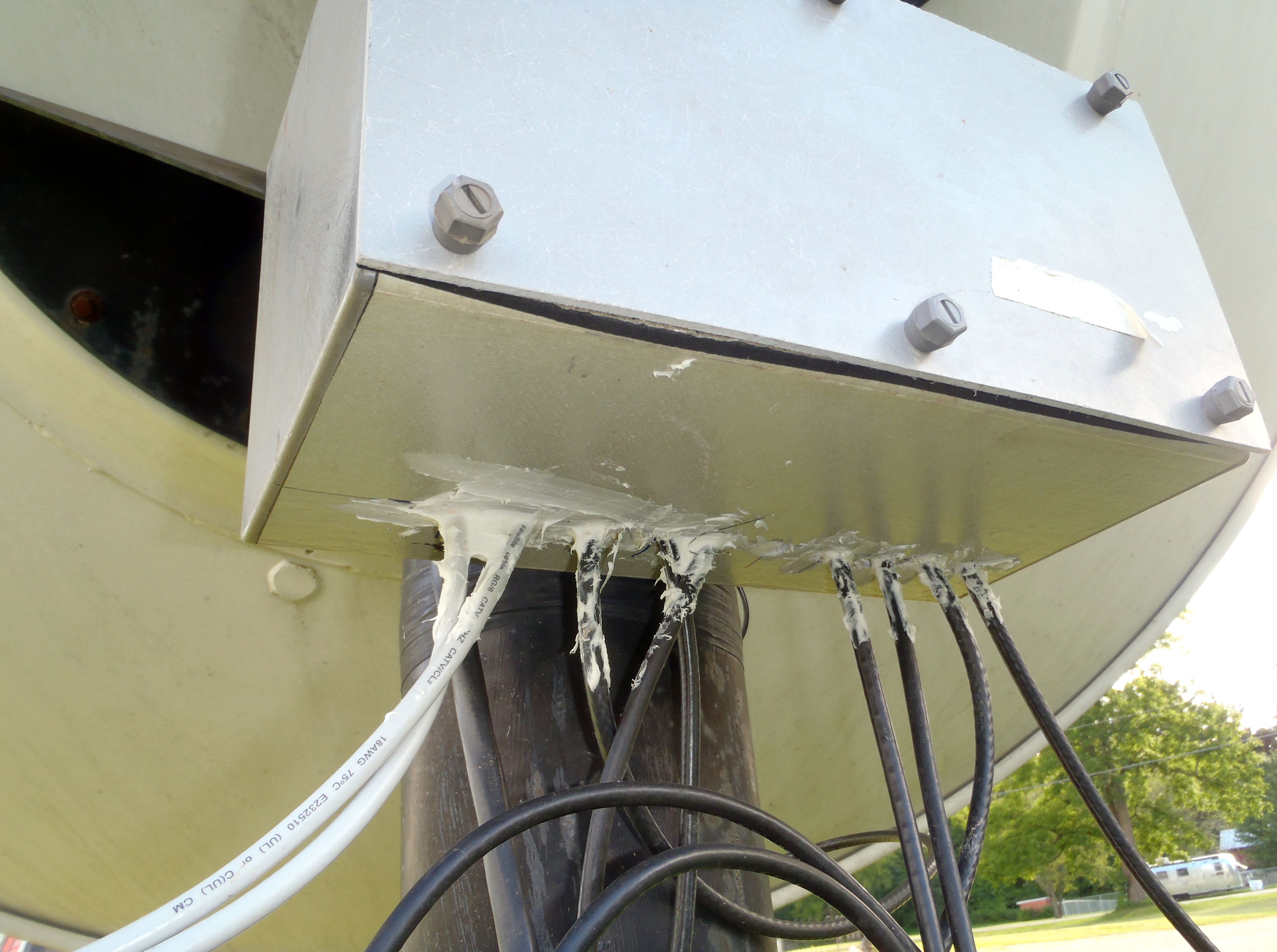

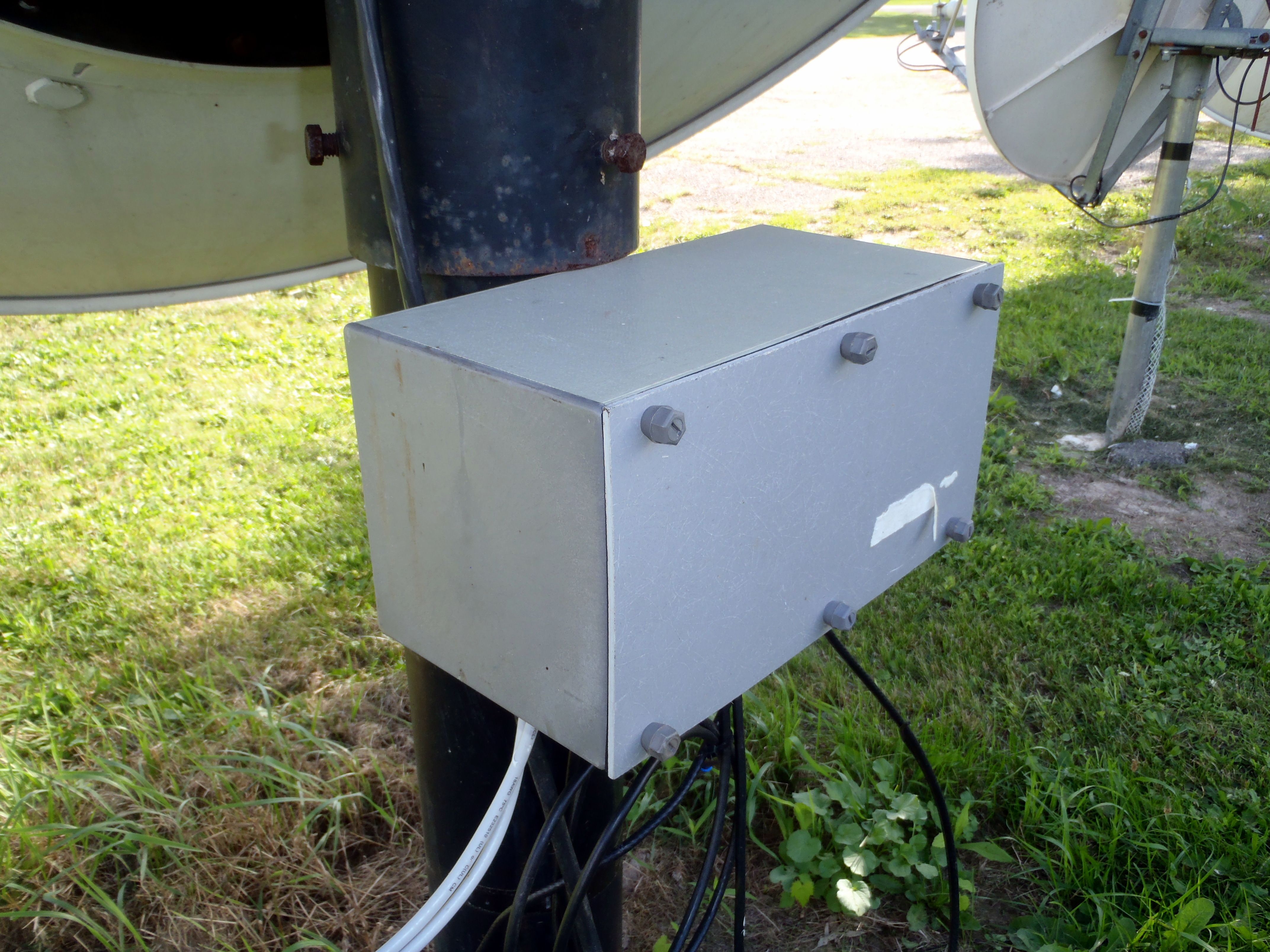

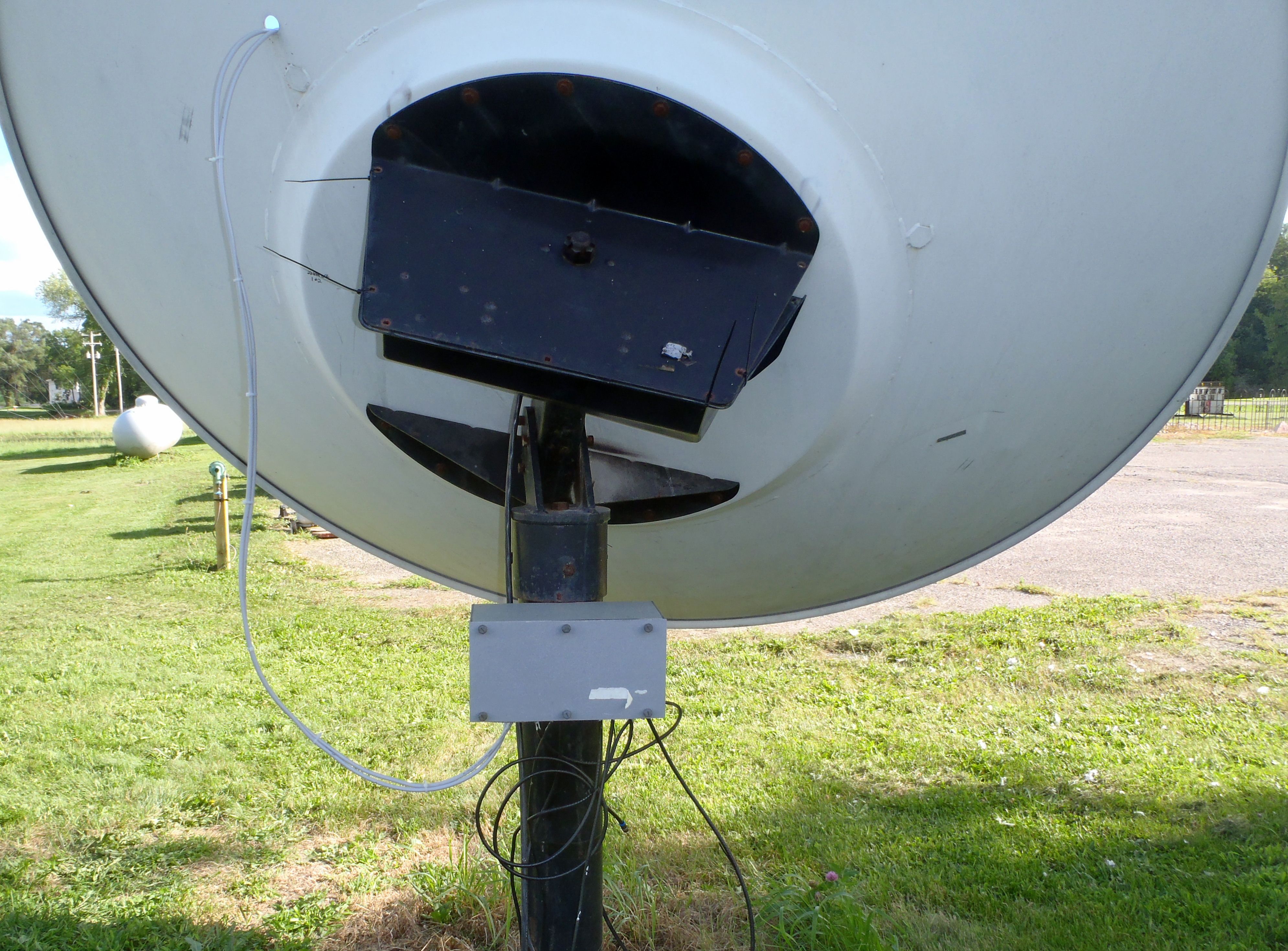

A friend of mine came over and tapped/threaded the back of the main Birdview to hold a fiberglass box, drilled for cables attached to switches inside. It was time to get them out of the weather. I quickly found that we had to seal the bottom holes (ugly, though it is) because small crawling, fast-moving bugs of a very thin variety (I'm no expert) had moved in within a day. The box has thumb-tightening screws for quick access to switches for change-out or expansion.
