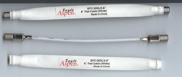

That flat cable at sodoun looks exactly like the crap ones they sold me at P10. they had 1 GHz barrels in each end, and a flat "filament" for lack of a better term. If they get twisted or roughhoused, they are done.
These are the last ones I picked up. I disected one in the name of science (why not? Its only 65 cents!). I hooked one up with DPP. Made sure the CX was aware that they were NOT approved and were NOT going to be covered by me under any sort of warranty. One of his TVs that he wanted the 625 hooked to was in the bedroom and one was in the living room with a sliding glass door. I explained to him that the ONLY way I was doing the install is if the 625 went in the bedroom and the TV 2 cable went around the baseboard and under the carpet to the living room. No way I am running a flat cable through a sliding glass door. Anyway, it works. If you try to jam an RG6 under a window, you are gonna get check switch errors like crazy.
I sort of wish that E* would decline apartment dwellers.......It would help completion percentages. :D
with no further delay, I present to you the flat cable that I use (unnofficially, of course). And pretty much only in my zipcode. I sure as hell won't use these if there is a chance of getting QC'd! The barrels on the end are 3GHz, and the filament is a round wire, not that flat crap in those other "flat cables". I would like to know how these are a fire hazzard. It seems to me that if they were, EA would not put their name on the line like that. I don't know if this is the one they are testing, but it is a heck of a lot more durable than the stuff I used to get from P10.
