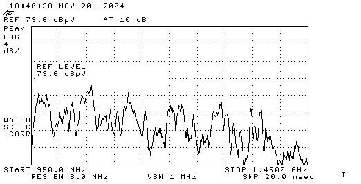

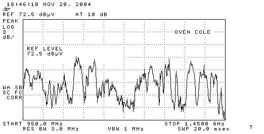

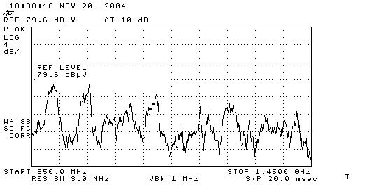

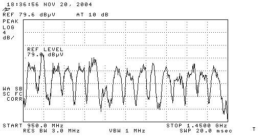

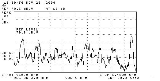

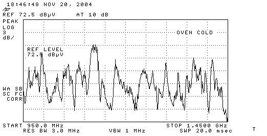

Here are G10R Ku, G3C Ku, and IA 6 Ku.
Tall skinny transponders would be analog, fat haystack like transponders are digital. Spectrum starts at 950 MHz and ends at 1450 MHz.

It didn't put the file names on there,
If they are in the order i attached they will be
G10R H
G10R V
G3C H
G3C V
IA6 H
IA6 V
