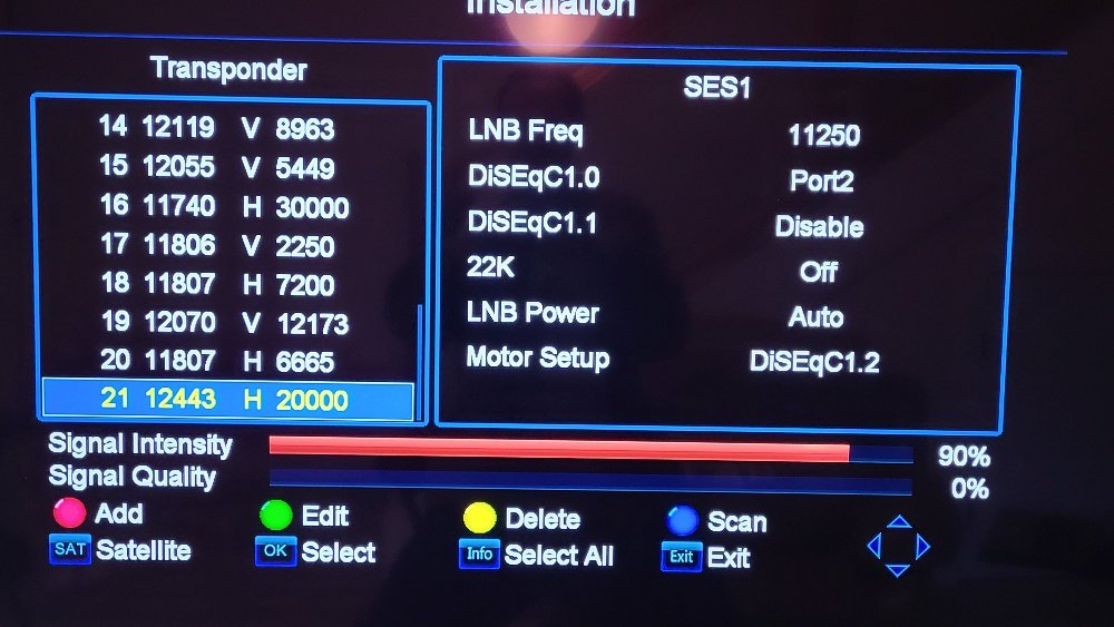

This V9 Prime receiver is great, but I can't figure out why it's scanning feeds out of range like all these H 19999 feeds. k4otl does your unit do this?
Yes I get similar TPs scanning in, I just figured they were data and thought nothing of it. I use a Geosatpro Standard PLL LNB on 99W and 101W, which is what locks WPR. Additional news, I manually entered in the "Liberty" mux that's SR 370, it's a bit more reliable, probably a function of being closer to the nearest 1 Mhz.

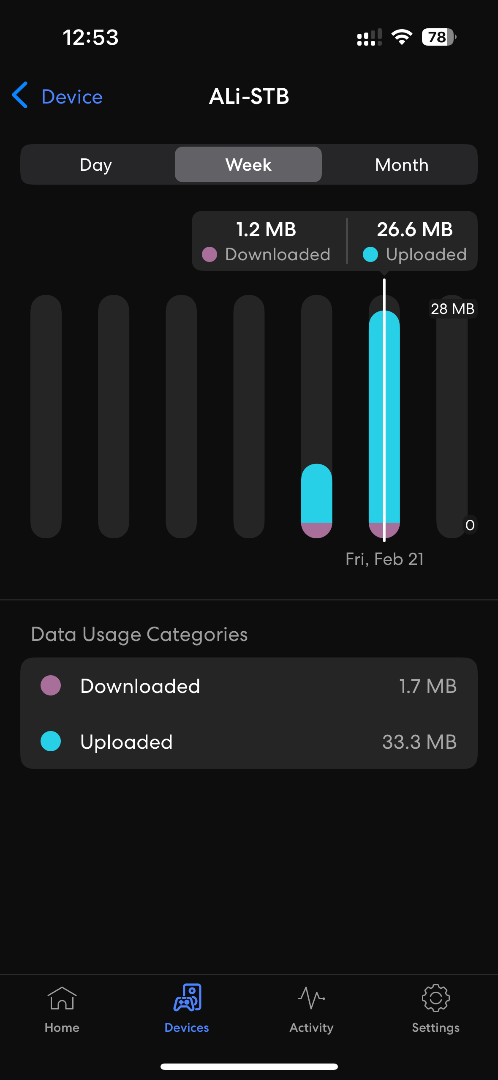

The other thing I wonder about with this box is it's data usage.. it uploaded 27MB of data somewhere earlier today. Where? What is it uploading? For now, I've disconnected it from the internet.
Glad you like it! I got an Amiko Mini 4K in the mail this week and I think the v9 wins the cake, definitely better remote. I need to get used to the Amiko but I switched back for now. As far as data usage, idk, I don't have it connected to the internet (not much in my house is), looks like I won't ever if that's the case. Maybe it's "calling home"?

I'm just going by Lyngsat. They appear to be circular tps on a similar frequency mapping as the Dish tps on other satellites. Not unbelievable that strong pay TV signals are bleeding over from 101W to 99W. All encrypted (Videoguard) of course. Maybe don't lock since they are too weak.
Here's what I see looking at 101W using a circular LNB. I'm not sure why I can't lock.
I have used a 10750 MHz local oscillator setting with a conventional Ku-band LNBF, and it can quite often receive the lower end of the DBS frequencies (12224 upwards) in a blind scan. Unless in the first part of your above pictured scan, you used 10750 on a regular Ku-band LNBF to scan the first 20 channels, and then connected a DBS LNBF with 11250 local oscillator to then scan 12443 frequency in a second scan.
I have an Invacom QPH-031. So I can scan linear or circular tps using the same dish. I use Port 1 on the linear side of the LNB most of the time. But if I switch over to Port 2 then I can scan circular tps. Channels 1 - 20 above were scanned in on previous scans using the linear side.
Yep, to China. I just worry what the message is 😆
I replaced my dead Edision OS Mio with an Octagon SF8008. After I ordered it I found out that it uses a Hauwei SOC and had instant buyer's remorse. Hauwei is not a trusted Chinese company. Needless to say, I have not let it connect to the internet.
I could put my network tap (a hardware device) on it to watch when it phones home to China, but decided not to bother.

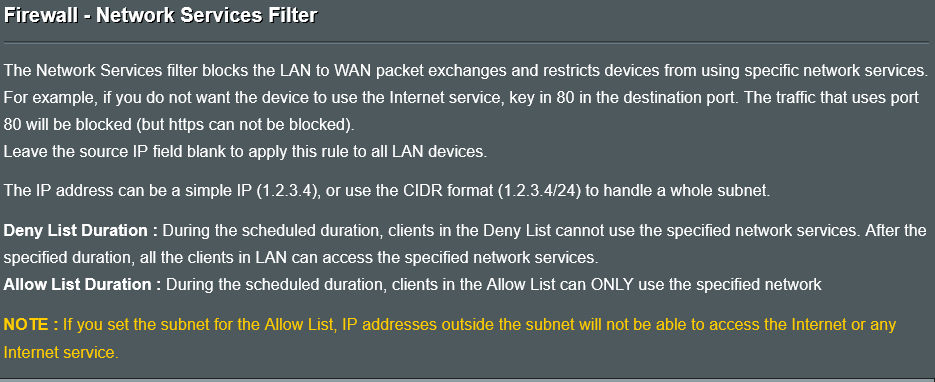

Mine is connected with an Ethernet cable. I see no WAN traffic from it at all. All traffic being able to be seen from within my router's management interface and cable modem management interface. That's a good thing, huh?
Here's hint. Takes 5 minutes. Testing included. If Slap the receiver on a VLAN. There are ways to keep packets inside of your LAN.
I didn't test it. Might work. Give it a static IP. Don't give it a gateway or DNS. Ya never know.
