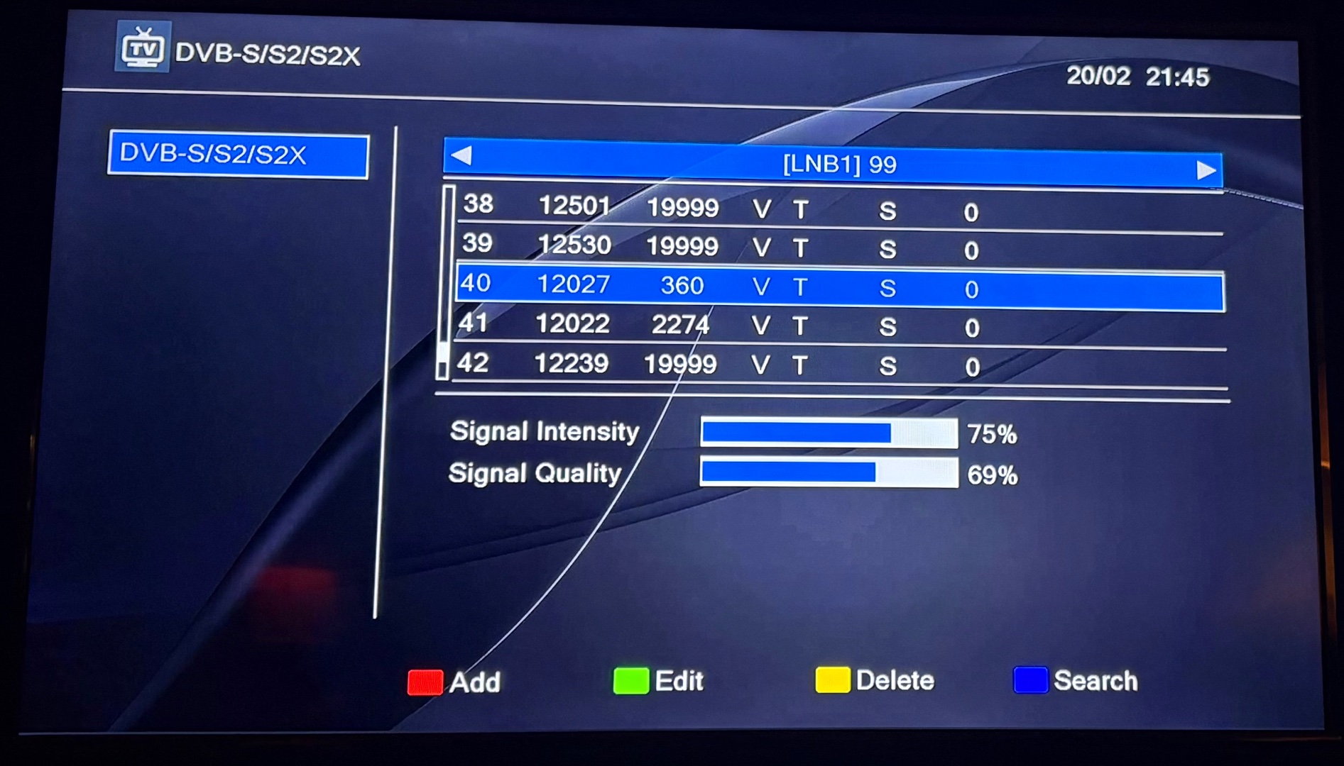

Yes, that I've tried. The others at 370, <360, etc would not lock, maybe they're weaker or maybe it was the time of day I tried. I haven't retried the others since I first posted about it. There's an audio feed at 1075 SR that locks reliably, it actually blind scanned in. I haven't seen anything blind scan at less than 1000 SR I'm pretty sure.

One thing I thought of why low SR feeds are hard for normal sat receivers is because you can't fine tune the freq other than the nearest 1 Mhz. The feed I'm able to get is pretty close to a 1 Mhz increment, if you were off 500 Khz and the bandwidth is that or less, you wouldn't be able to tune the signal. Would be interesting if STB firmware could be modified to get to a 100 Khz increment, would be close enough for a lot of the feeds.

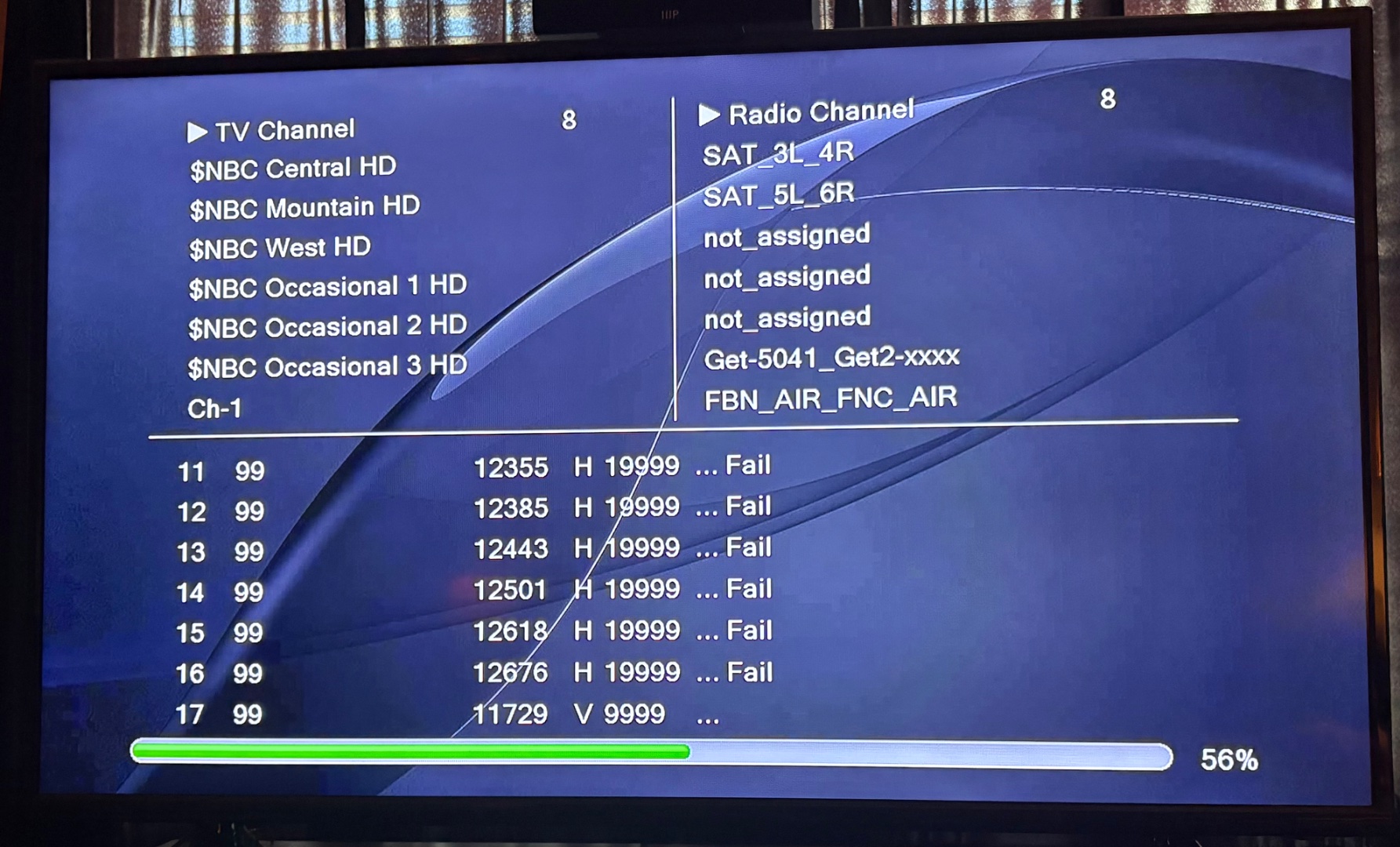

This V9 Prime receiver is great, but I can't figure out why it's scanning feeds out of range like all these H 19999 feeds. k4otl does your unit do this?

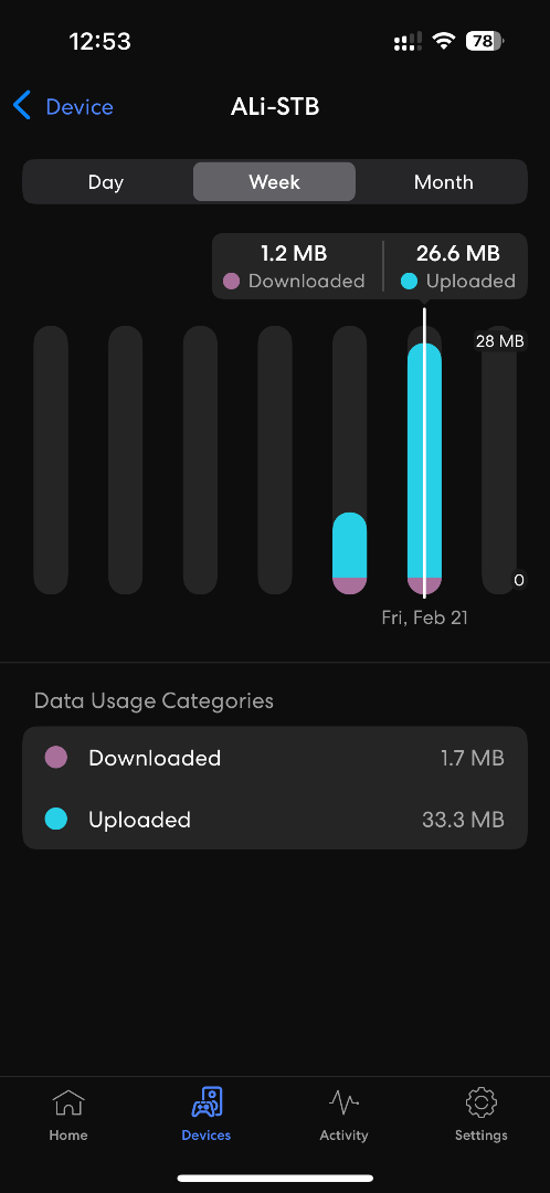

The other thing I wonder about with this box is it's data usage.. it uploaded 27MB of data somewhere earlier today. Where? What is it uploading? For now, I've disconnected it from the internet.

How is that possible? I've never seen that before. They don't lock in; are they regular KU signals?
I'm just going by Lyngsat. They appear to be circular tps on a similar frequency mapping as the Dish tps on other satellites. Not unbelievable that strong pay TV signals are bleeding over from 101W to 99W. All encrypted (Videoguard) of course. Maybe don't lock since they are too weak.

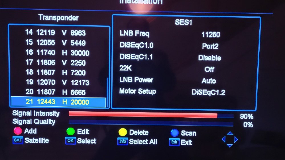

Here's what I see looking at 101W using a circular LNB. I'm not sure why I can't lock.

Directv uses its own format for the stations. Not DVB or DVB-S2. So that's why they won't log a signal on your receiver
