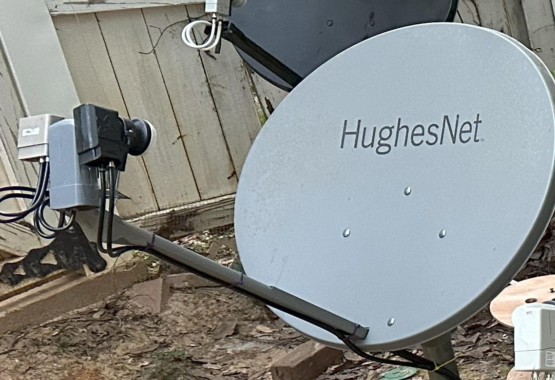

I finally got my Ku-band setup running a week ago, I had acquired a used Hughesnet dish (36") for free, bought lnb with holder and a GT media V9 prime receiver, and 8 months ago or so gave up as I could not lock SES 1 (101 W) or G19 (97W). I finally got back to it a week ago, thinking I'd never line things up but latched onto some sats, then fine tuned to SES 1 and then moved over slightly to G19. This website and all the forums provide VERY good info for those starting out and I'd like to thank you all. And I'm in my 20s, so not all young people are averse to a technical hobby like FTA. I also wanted some more free TV above and beyond my DVDs and OTA (people do look at me like an alien sometimes when I say I don't stream TV/music).
One observation I will make is that while Dishpointer is helpful at getting a general direction/elevation for a particular satellite, DONT TRUST THE GOOGLE MAPS IMAGE! Trust either a magnetic compass or a phone's compass for the correct azimuth, I was probably 10-20 degrees off when I first tried it. Anywho, thanks to everyone! I've been enjoying some SAT TV, mainly Positiv TV on G19 right now. I think I've caught the FTA bug, I'm already wanting to attach a second lnb with either a 22k switch or diseqc switch to try and get 101 W off the same dish as 97W haha. C-band is currently a "who knows?" for me, I get a lot of channels OTA that would be on C-band, although getting Grit TV in HD would be nice. I've been scouting for old C-band dishes if for nothing else to save for later. I guess whatever you need to justify it haha.
Another thing I'm curious about, I was given a bunch of "swm splitters" and "4x2 multiswitches" from an old Direct TV installer, as well as some other stuff like cables and such. Are these swm splitters and the multiswitches any good for FTA things? I've tried looking up but am not too clear as to their function.
Another thing I couldn't find a whole lot of info on was the v9 Prime reciever, and I can confirm that you can edit the channel lists to add the "hidden" music channels. I haven't tried them out (need to move the dish over to 101 w) but at least you know you can edit. I used the 'Ali DB editor" and can also confirm it works on a 32 bit Windows 7 PC. Anyway, just some additional info for anyone who cares. Thanks again, these forums have been super helpful.
Congrats on your progress! Those HughesNet dishes are great, I have one pointed at 97/101/105. You can stack LNBFs on either side of the center one and get satellites 4 degrees apart easily with that dish.
To combine them, I'm using a DiSEqC 1.1 8x1 switch (around $20) and WB68 multiswitches to combine two dual-feed LNBFs into each port of the 8x1. Those 4x2 switches will do the same thing basically but the WB68 will pass the 20kHz tone which is required if you're using the upper half of a Universal LNBF.
I'm not sure if the SWM splitters are good for anything though.

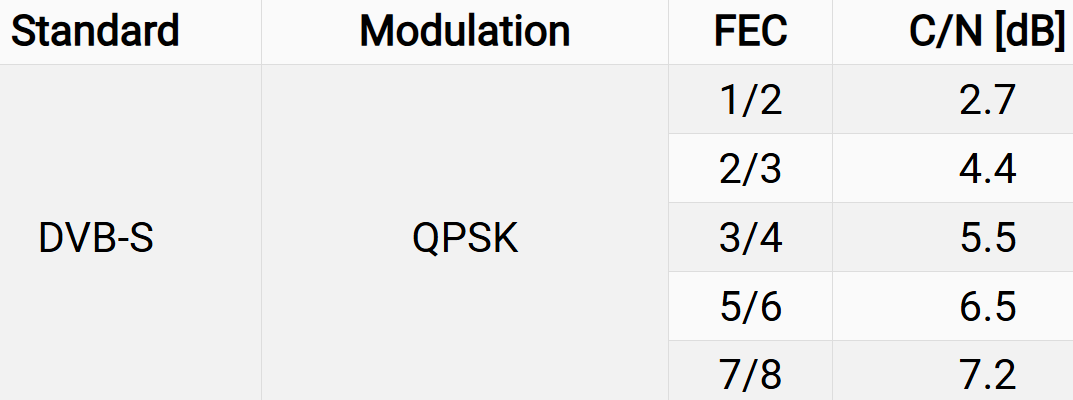

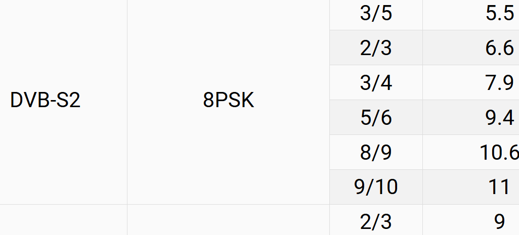

Some additional questions/observations:
1. I've added a second LNB (with diseqc switch) to recieve 97W, I have the "main" lnb on 101 W. (I don't have any more lnbs to add right now lol). 97W is substantially weaker (101 W has ~80-85% quality), 97W is in the mid 60 percent range. I know these numbers are semi-arbitrary but should the offset lnb have that much less signal? Once it warms up outside I'll try some more adjustments. The DVB-S2 TPs don't like <66% quality on my receiver, the DVB-S TPs have a little more headroom it seems, although breakup occurs occasionally (~twice an hour).
2. I've got 2 unused ports currently on the diseqc 1.0 switch I've got, currently they're just open (nothing screwed on). I've got several of those 75 ohm mini-loads you put on a CATV splitter for the unused ports. Would it help to put those on the unused ports or can I leave them alone? Or will it damage the switch? Just curious.
3. I bought a 22k switch as well and was going to use originally it but it wouldn't fit in a weatherproof enclosure I had. Anyway, it's a Geosatpro I got on ebay and it does pass the 22k signal, since one of my lnbs is a universal (the other is a standard) and it does switch it to the high band. Figured somebody might could use this info.
Thanks!
So, aim the dish at the weaker 97w with the main lnb, and get the stronger 101w off the sidelobe.
1. ...The DVB-S2 TPs don't like <66% quality on my receiver, the DVB-S TPs have a little more headroom it seems...
To explain 1. take a look at these charts. The C/N values are minimum signal required to lock the transponder.
3. Traditionally, I've been taught if you have a universal LNB then don't use 22 kHz switches since operating them would conflict with the 22 kHz switch in the LNB. But I always say if it works, then do it and figure out the why later. I've always just used diseqc switches. Maybe your configuration will work sometimes but is not reliable?

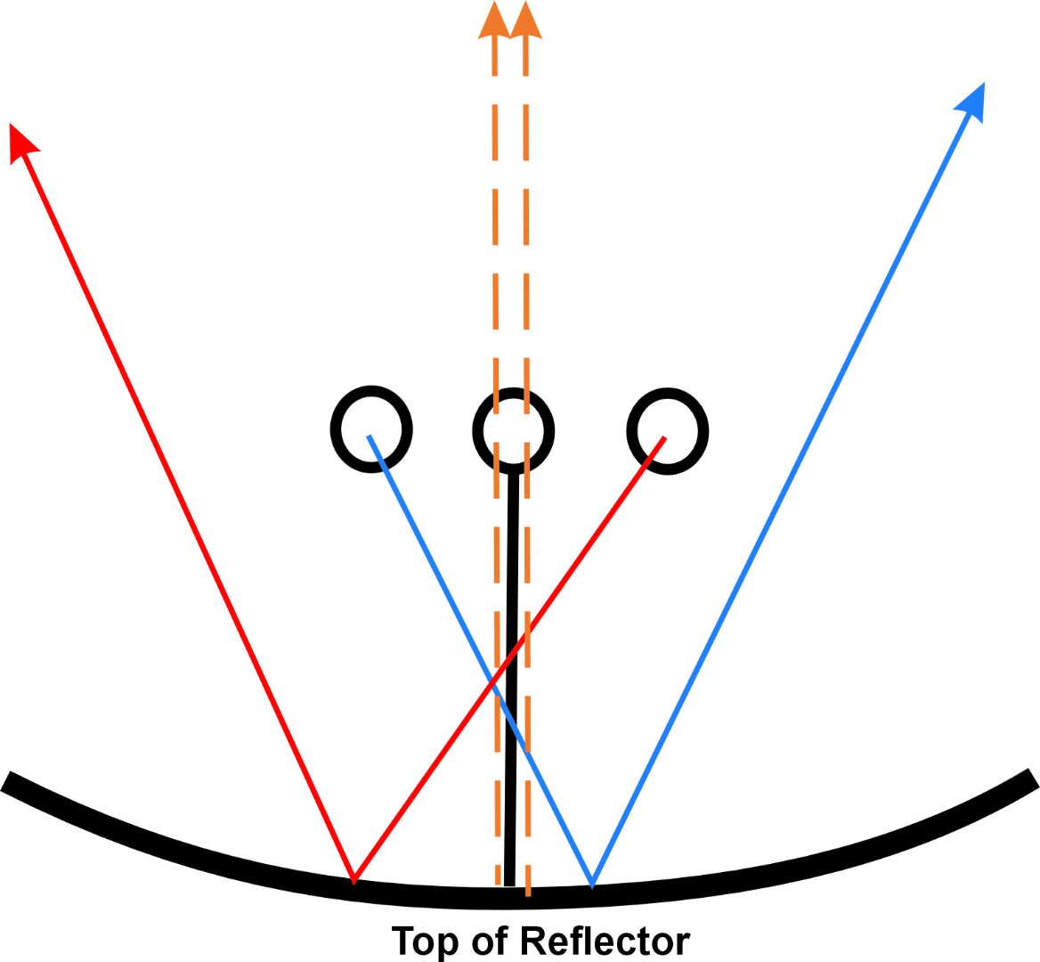

Just a few thoughts from the school of smack the big guy first.
Your diseqc switch needs to have any unused ports open. You can cap them. But don't use terminators.
If they get terminated with 75 ohms. If a port happens to be switched for any reason. A data glitch, whatever. A load will appear across that port and present a load on your receiver.
When using multiple lnbf's on your dish. Take a peek at a neighbors DN, DirecTV dish with a triple lnbf. See how the entire dish is skewed?
You want to keep your feeds aimed at the dish centerline. And skew it accordingly to gain maximum signal. Your phone AR app looking into the sky should demo the arc between sats. Work around getting the center lnbf signal peaked. Then skew the dish instead of moving the feeds off of center. Make sense?
Me and tone switches just don't party well. Haven't had much of any good luck with them. If an lnbf requires 22 kHz to switch bands, then that's the way it is. Stand alone switches? Not a fan. Opinions differ.
