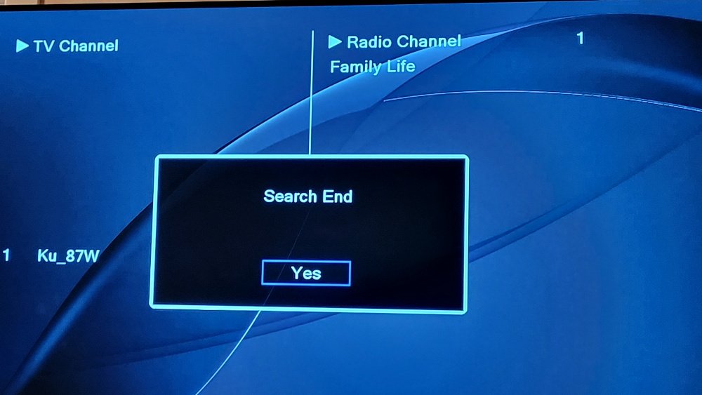

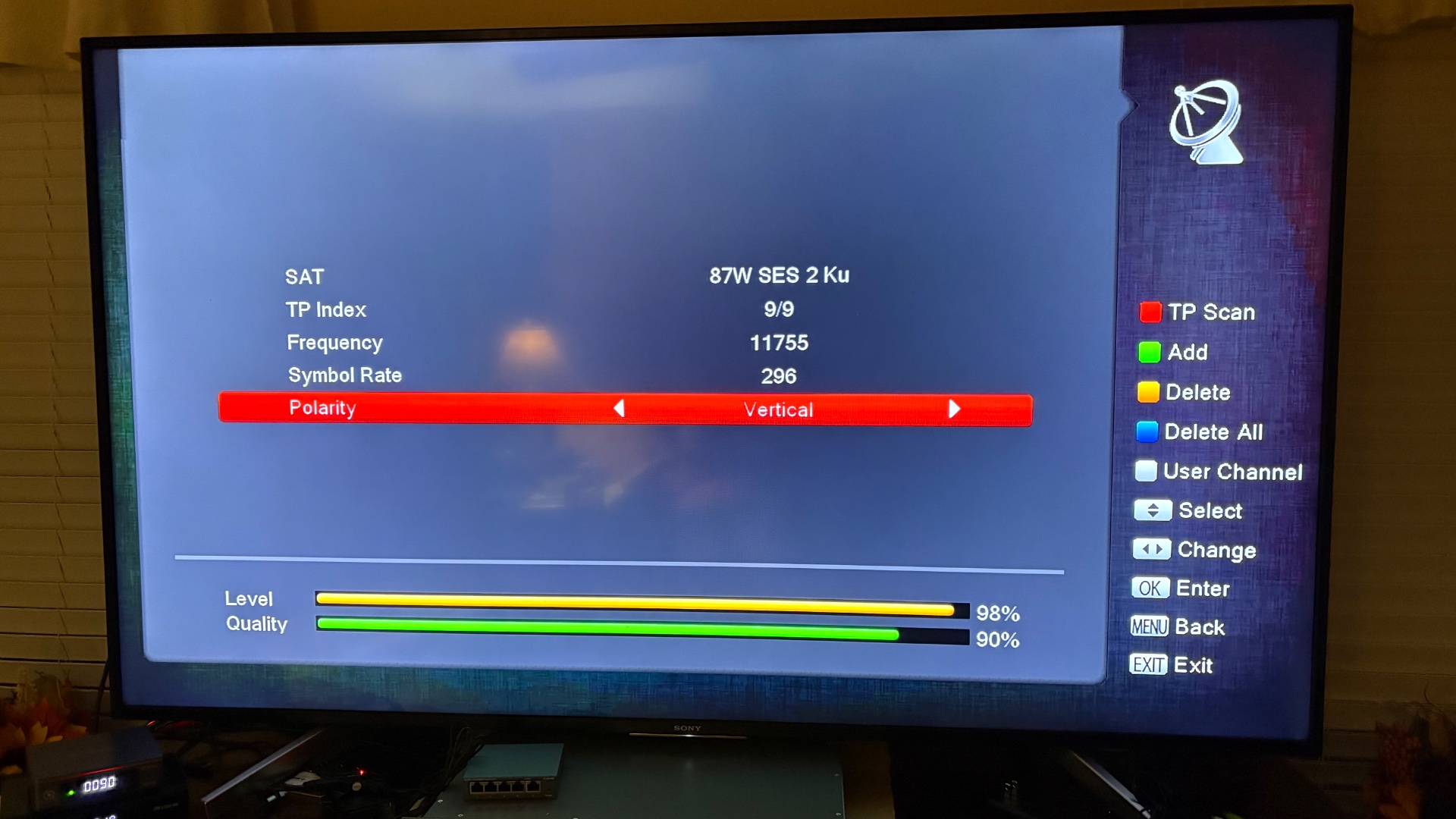

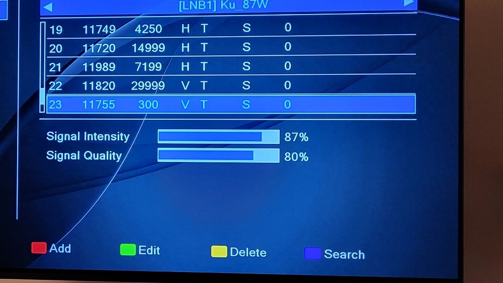

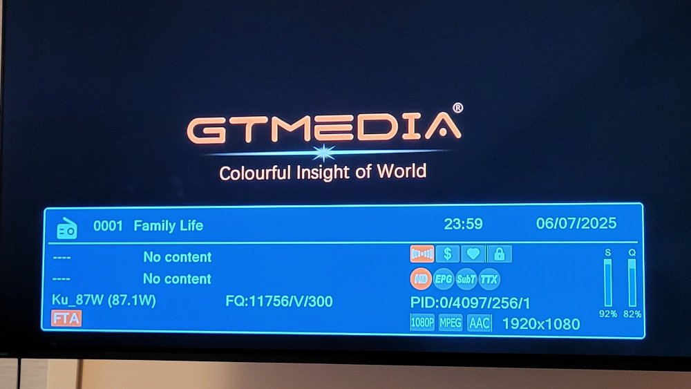

Locked a low SR on the Amiko on 87 KU-
This is using an Amiko non-PLL LNB, which is remarkable. However, I do not know the audio PIDS for this feed, which appears to be the "Family Life Ministries" mux.

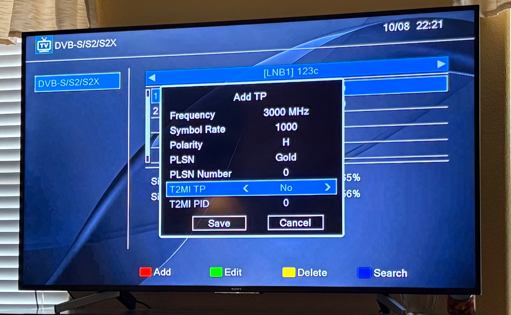

Low symbol rate finds on C-band. All of these were located using a V9 Prime with the T2MI toggle "ON."
97- 4022 V 373
97- 4050 V 444
99- 4161 H 1040
99- 4162 H 1040
