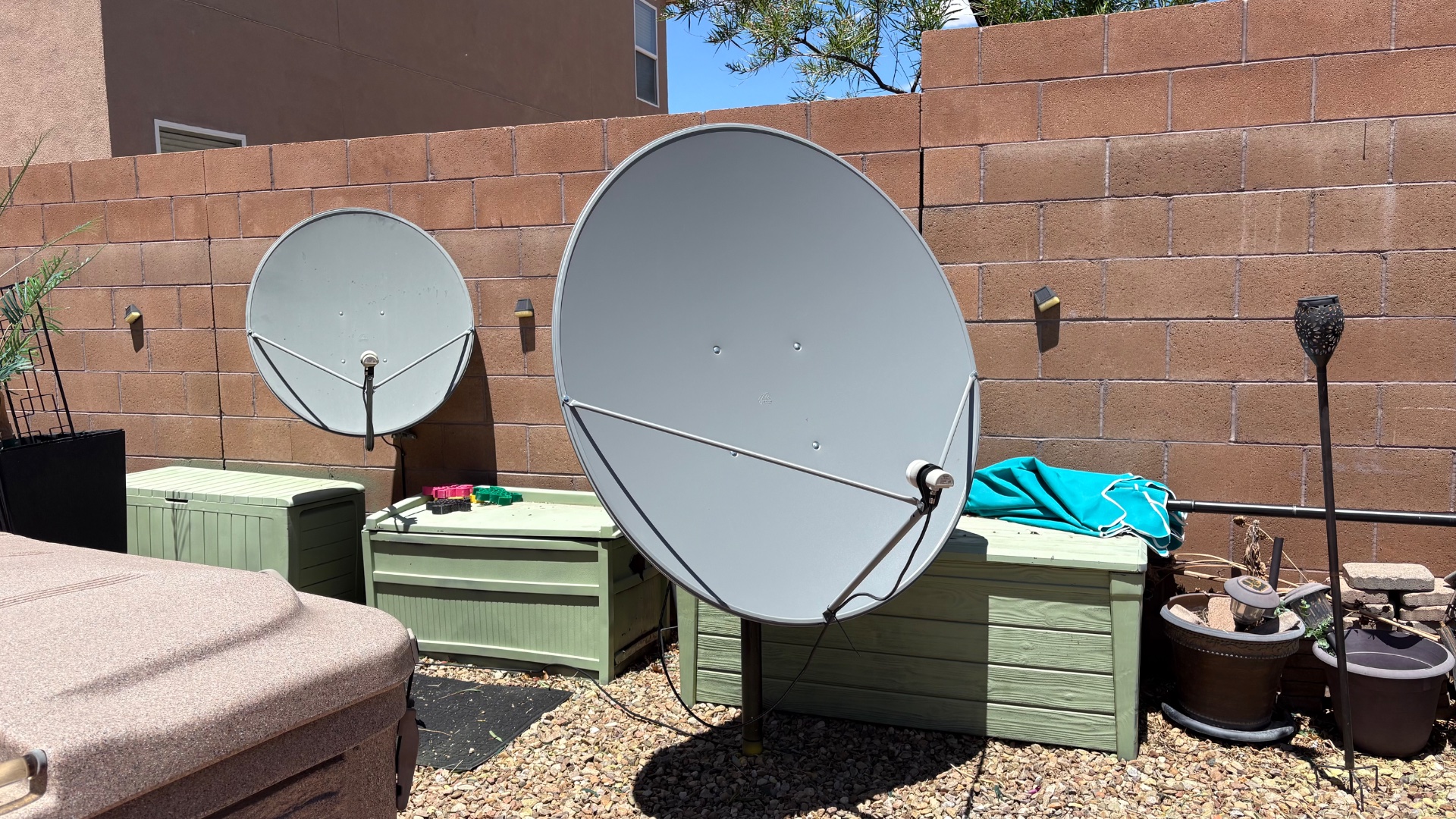

Got my GeoSat Pro 90cm dish I brought with me from Kansas City mounted on an old Dish Network J-pole today. It's fixed on 101 for audio and wild feeds. My roommate bought and contributed the 1.2m dish, which is currently fixed on 99. Both are running Maverick LNB's and have dedicated feeds (no diseqc switch).
We have the following receivers active:
Amiko h.265 (for 101) using Hyper Casey new firmware
GTMedia V9 Prime
Edision OS mini 4K
Tandberg RX-1290 (for 4:2:2)
We acquired an 8 foot perforated steel dish from a Satguys member in Santa Fe last week and will be installing it soon.
Might motorize the 90cm at some point.
