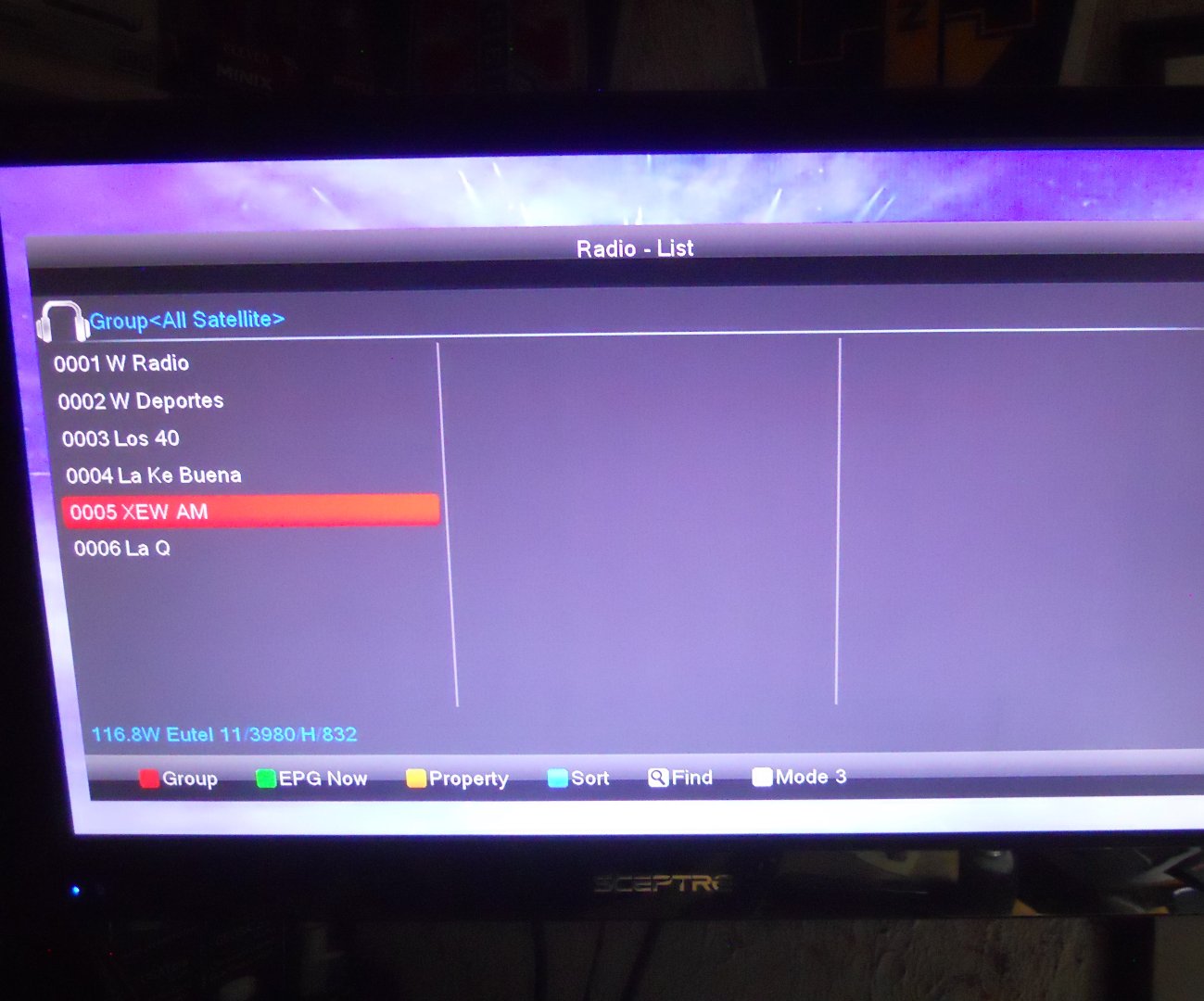

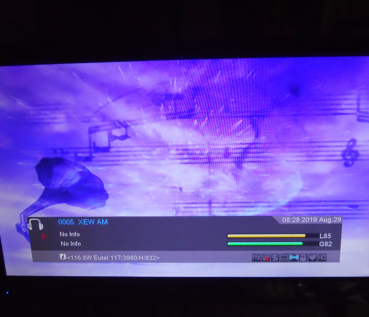

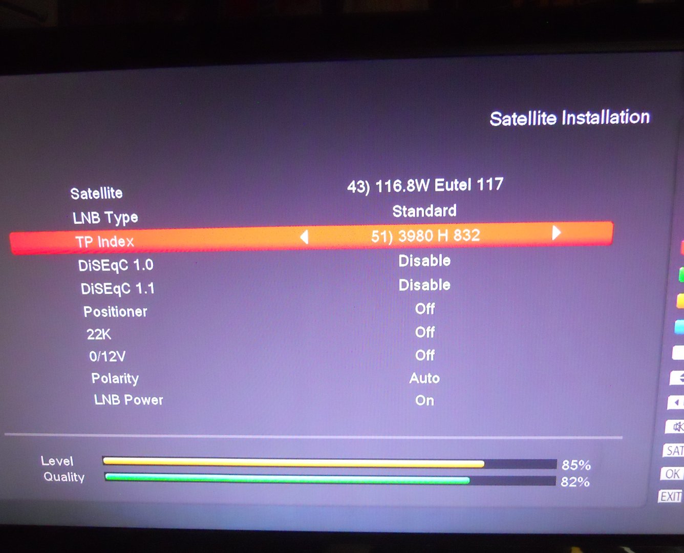

Using an Amiko MINI 4K UHD with V1.0.69 Firmware and a Titanium C138-PLL on a 10 Ft Winegard i am able to lock 3980 H 832 and scan in the 5 Radio Channels. Took like 30-45 seconds to lock in the signal, but had to do a manual scan to get the channels. No sound on any of them though. According to TVROSat Charts they are BCT Secured. Is this correct? I also was able to lock a good signal at 3938 V 674 and 3930 V 667 but did not find channels yet. And i have run out of play time for the day. Can anyone confirm to me there are ITC Radio channels working on these 3 TP's? This is fun trying.

Reactions: Brct203 and FTA4PA
