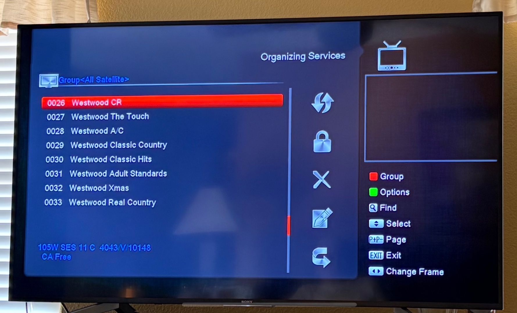

I used the Amiko to manually program in some of the Westwood One syndicated radio channels on 105 C. I remember hearing these are going away soon (hope that isn't true).
The Amiko works great for radio.

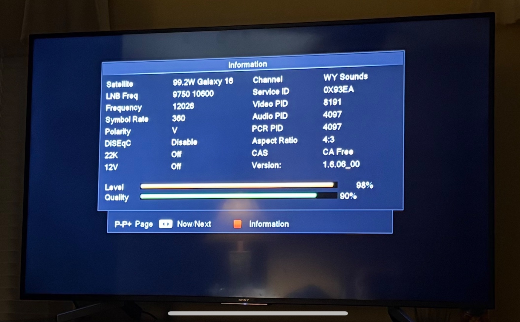

Listening to the low SR WPR mux (12027 V 360) on the Amiko.
Program in the TP in the settings, let it lock, then add "User Channels" for each feed with APID's 4097, 4098, and 4099.

I revisited this. My Edision even when using the so-called T2MI driver with Low SR still can't lock this tp. The best it can do is show an SNR of 0.5 dB. My GT Media V9 locks readily and plays all three audio PIDs mentioned. SQ is 80%. WPR Classical is a good station to listen to.

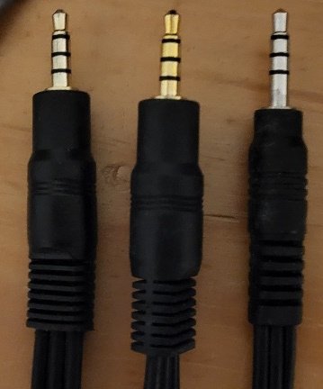

It's a cable like this: 3.5mm av cable
I haven't used it myself
Notice that the 3.5 jack plugs of these two links have different lengths (one has a longer sleeve, than the other)!
I had this issue with a receiver myself; I needed the longer plug, but that was harder to find (at that time).

With my "SAB Sky 4800 mini" receiver the pinout was (from tip to sleeve): Right - Left - Video - CommonGround.
I needed the long version of the plug (see my post above).
I once tested a normal length audio 3.5 jack cable in the receiver, and it didn't output R. Just L and Vid.
Every "ring" is about 3 mm, so I would guess that by inserting a jack plug in steps of 3 mm at a time, and checking the outputs, you can discover if the sleeve is meant to be 3mm, or 6mm.
I don't remember if I actually tested it this way, or that I first found a picture of the needed long plug on the SAB website.
This checking method would not work, I realize by now, because the GND would not be connected properly.
What might work: insert the jack plug only 6mm, and check at the tip and ring1 connections of the cable if sound or vid signal is there. If so, the sleeve is only 3mm. This method assumes that GND is at the sleeve, or at ring2 (of the receiver), though.
Sorry if I caused confusion.
So the easiest way might be trial and error, with some cables, after all?
