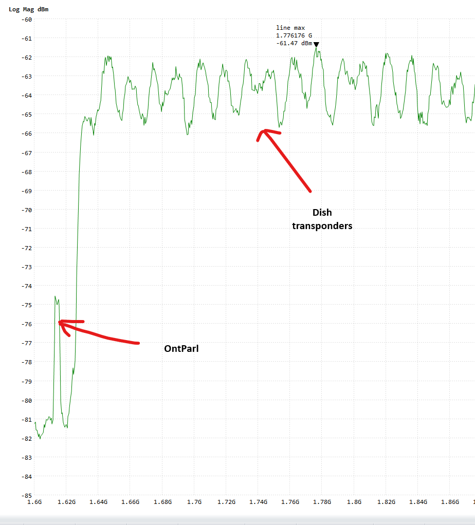

Can you not receive it? If not, then I guess it's on the Canada beam despite what Lyngsat says. Anyway, it's about as exciting as one of those Nexstar colour bar channels.
I can but it's much much weaker than the other transponders (by about 7dB if I remember correctly). So unless it's just a very weak transponder on CONUS beam, I'm thinking it might just be that I'm a bit outside of the footprint. The spectrum plot below is taken with a linear LNBF, so of course a proper circular one would look slightly different.
You must have a non-FTA receiver also. From memory, I don't think I receive any other tps on that sat, I assumed, since they are Turbo.
my receivers indeed won't recognize those Dish transponders, even if I use a circular LNBF, and I can only see them on the spectrum analyzer and judge the difference visually on the spectrum plot. And yes OntParl is also the only thing I receive on that satellite.
