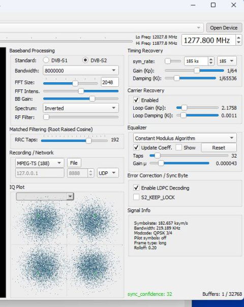

This screen shot was taken using another LNBF, so freq is a bit off.

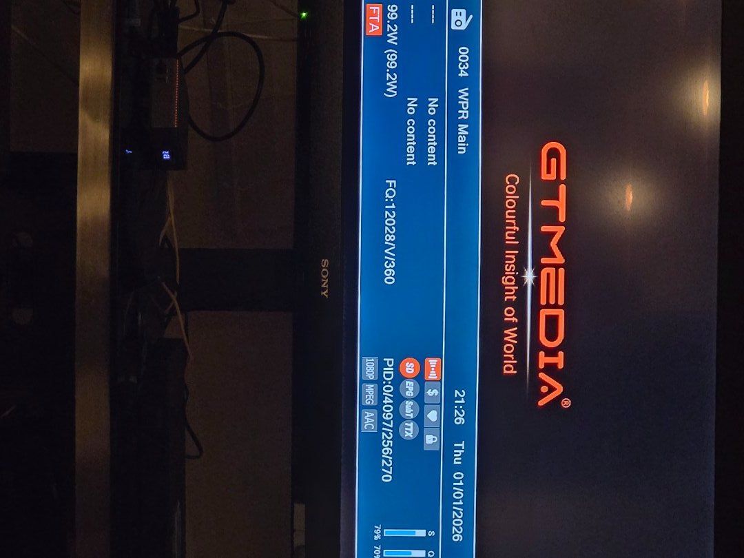

Now I noted my Gt Media won't go below 300 KBs for trying to get Las Vegas station.
Is there a way to get around this or just go to SDR route? :rolleyes: :hatsoff2
Just FYI, the Octagon SF8008 v3 Supreme (from Rick's) can tune low symbol rates. With the dual tuners, I would say this receiver is a formidable competitor in the FTA market. Running KU on one tuner and C-band on the other. Current image (four slots) is TNAP 6.1. Credit and thanks to El Bandido for his help in getting this working.
Does it do 4:2:2? And what C band LNB are you using for low SRs? I use the Titanium Blue LNB (5G filtered) and was unable to lock any on my 10 footer with the V9.
It can stream 4:2:2 to PC. For C-band we are using the Titanium C140.
