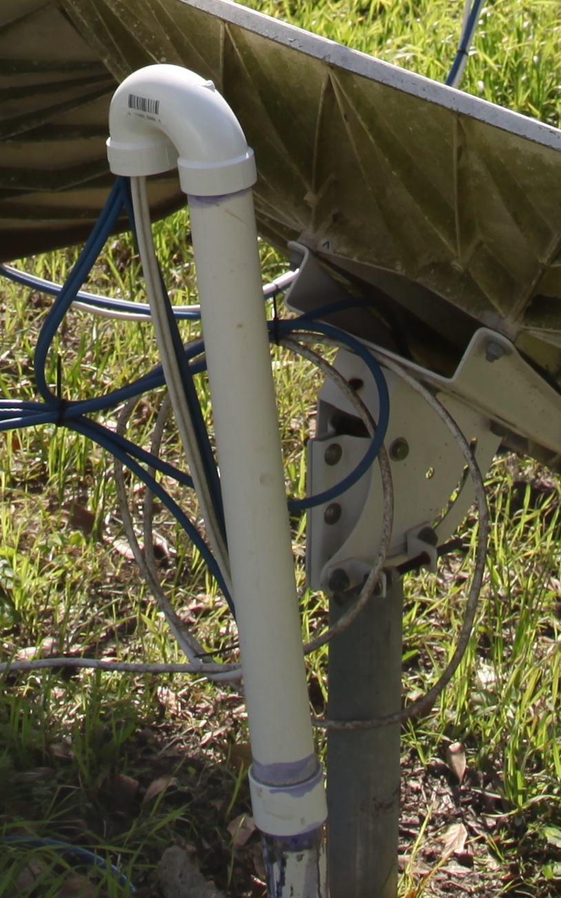

So anyway, I went to Lowe's and I bought a fish tape, wire pull lubricant and a roll of string.
One thing I'm going to do, when I pull the new wires through the tubes I'm going to leave another string inside the tube so that if I have to pull more wires through it again in the future, the string is already there and I won't have to do the fish tape again. I watched some youtube videos on how to use fish tapes. :)
Pulling additional wires into a conduit is nearly impossible unless it's a short run. What happens is the fish tape will twist around the cables and when you pull the new cable in it grabs the existing cables (especially in the bends) and bunches them up and damages them and halts the effort. The preferred way is to remove the ends and pull out the existing cables as a group with one of them joined securely to a pull wire. Then attach all the existing and new cables to the pull wire (just wrap electrical tape around all of them making sure to wrap the ends) and you will have no trouble pulling the bunch back in especially if you use the lube. It helps a lot if someone is pushing the cables into the conduit as you pull them through it.
That sounds like a good plan but it would be pretty hard for me to go through all that. The tube underground it runs through is 1 1/2" pvc plastic so I'm hoping that it won't be too impossible.
As it is now, one wire comes out of the tube and goes into the box where the discque switch is. But the other existing wire comes out of the tube then is reburied and runs over to the big C-band dish.
They are twin siamese wires, it's a RG6Q that has paired to it a category 5 ethernet wire. The ethernet wires are being used as control and power for the two C-band dish motors. I would have to disconnect those and dig up that second wire. Plus cut the connectors off and put new ones on them again. Now that would be a major, major pain in the backside. I do understand what you're saying though and I can see how it could be a huge problem if it goes wrong. But I'm going to go ahead and try running it as is for now and see how it goes.
If it doesn't go right I can always pull the new wires out and try again or if all else fails, pull ALL the wires out. Pulling everything out is going to be my last option because it would be pretty disruptive and a lot more work.
But thank you for mentioning this to me as I had not considered this potential problem. I will more attentive to the process now and if it gets tangled and hangs up at least now I'll know what it might be and what the solution is.

Now I've got everything a mess out there, plus to make matters worse, it rains every other day and it's bloody cold in the morning and bloody hot in the afternoons. And the mosquitoes are out of control. :mad:
It's so hard to make any progress with things like that going on. I have one of those ground fault plugs that I run an extension cord from when I was testing my DN tuner and my dish conversions. That was pretty scary because there was standing water out there, I stayed out of it and put the cord where it wasn't in the water but still.. :eek: I still need to buy some rain boots though. I'm tired of muddy, WET sneakers.
The forecast has it raining every other day for the next week and the ground is saturated so there's no chance it's going to dry up back there any time soon.
And I still need to run another wire for my DN system. I'm lucky in that when I did repairs to the old tubes and ran new wires about a year or two ago, I had the forethought to NOT glue on the curved things on the tops of the tubes (to keep rain out) so that I can slide them off and push the wires straight through.
This one comes apart near the ground, the one next to the house which is also buried right smack in the middle of my rose bushes, :eek: the curved thing on top comes off.
I figured that it would be impossible to push future wires through the curves so I left them where I can remove them.
However, I'm seriously thinking about digging the old tubes up and putting all new 2" tubes with gentle, roundy curve elbows instead of the sharp 90 degree elbows this one has.
I would have lots of room for all the wires I could ever need and it would be easier to pull them through a larger tube with round elbows. And I could also leave three or four strings in it for future use.
