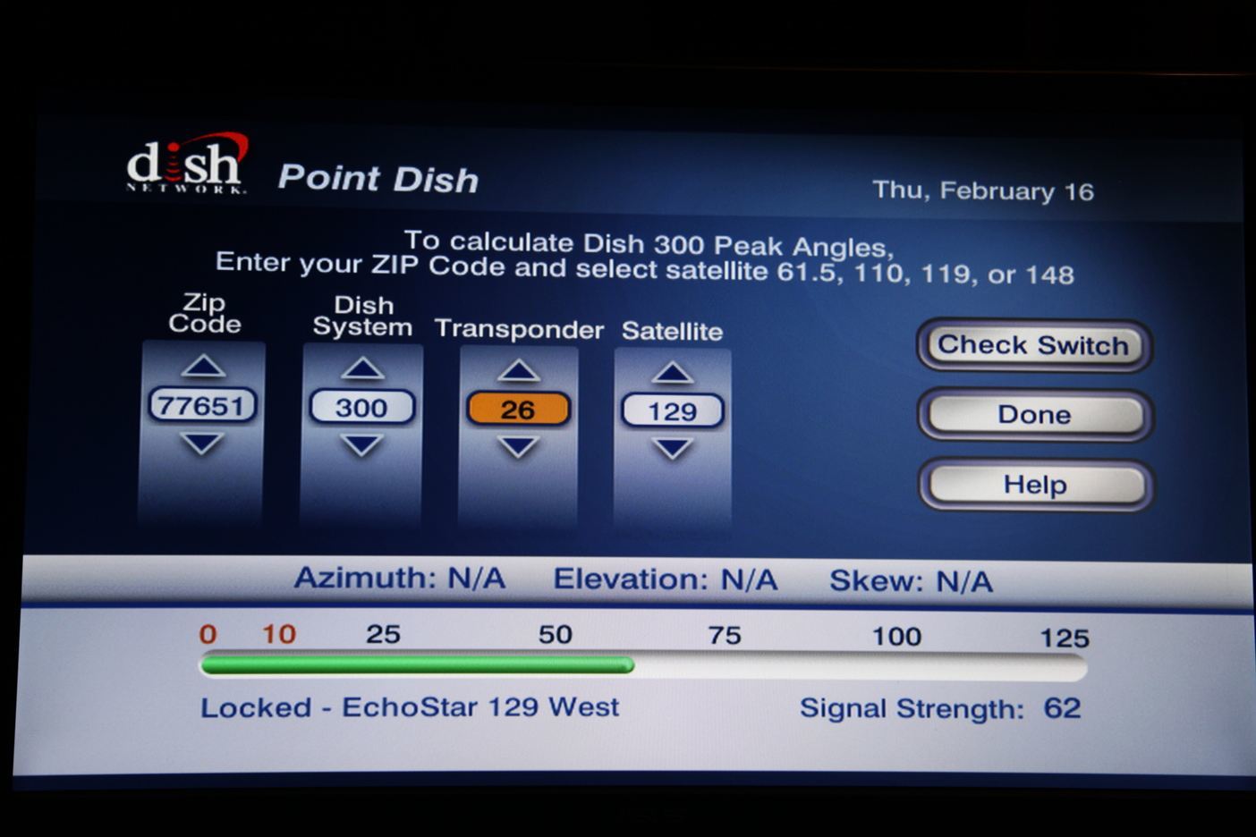

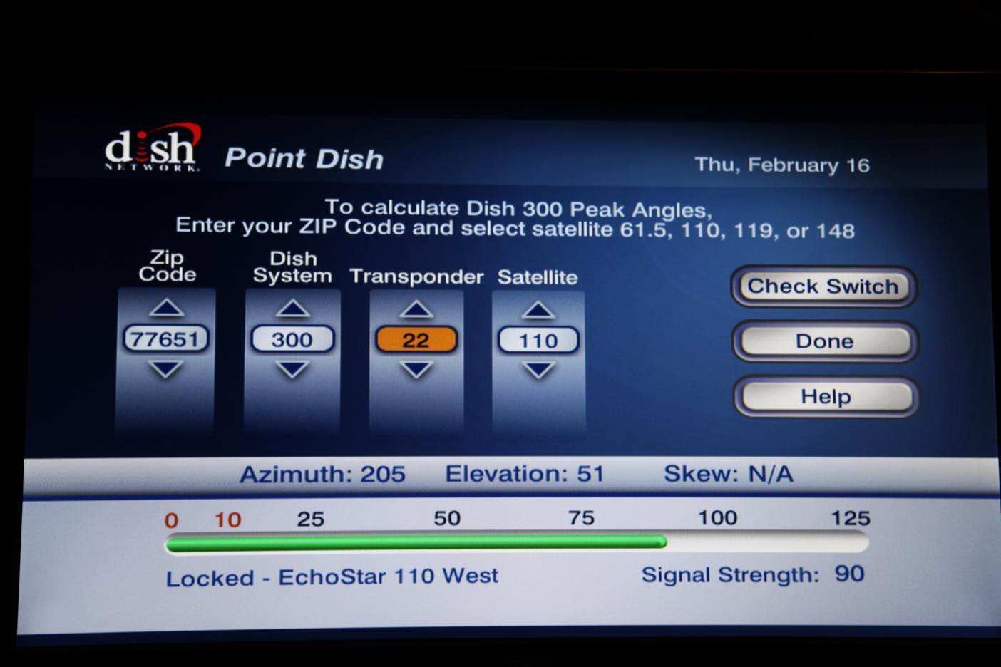

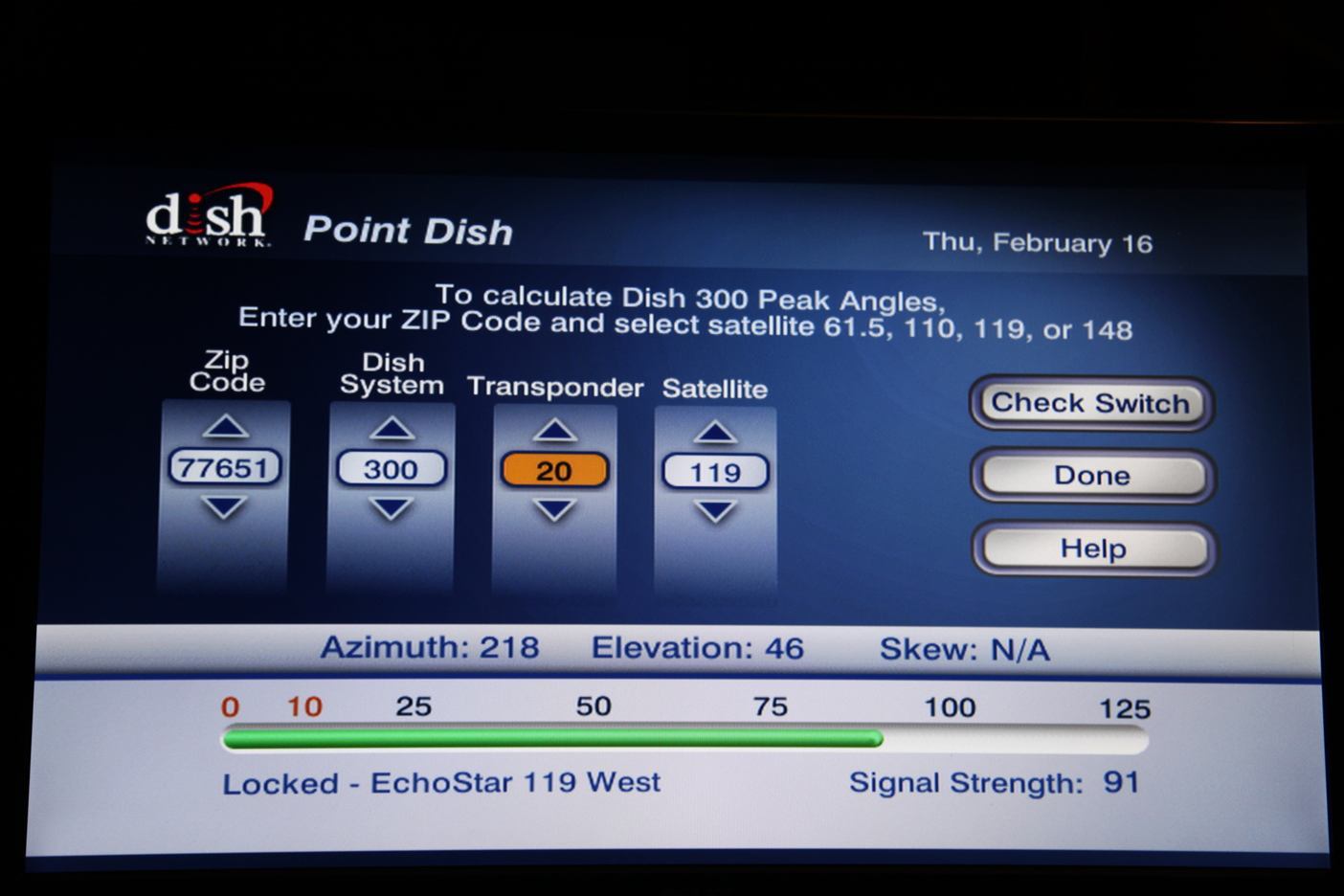

On the 2nd pic I was worried you didnt have all the channels but I see "my channels" listed which would be the freebies. If you hit the "guide" button it will cycle through all, my channels, HD and favorites which you can set up (so you coudl remove those shopping/ppv channels)

129 is a little low. I was pulling mid-upper 70's on transponders 17-32 (1-16 are spotbeams so most will show 0) with a 36"

a very small tweak of 129 should bring up the numbers. 50's and low 60's is what a smaller dish gets (I showed those on a Directv Phase III). Elevation might be a smidge high (or low)
