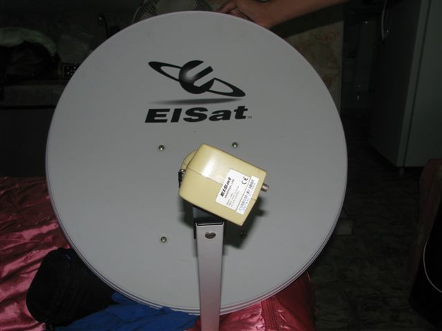

He had a 90cm dish in Africa , but because he was entering Cuba with a dish in his luggage he needed it to be smaller so he may have gotten a 60 cm or even a 45cm , I know that is small for FTA but he's hoping to get marginal signal , he's using a Universal LNB.
Here's a pic of his dish , looks small to me .

I know that the signal is much better on 123.0 nowadays , but does anyone think this is possible with the dish pictured in my last post. The more I look at it the more it resembles one of those tiny DTV dishes

I agree, that dish looks like the basic size of Dss dishes, if its there will not hurt
to try, he may want to consider somekind of adapter that attaches to window
where he can hide the dish inside the dwelling. use google and search, or
someone here can elaborate more on this issue, good luck.
