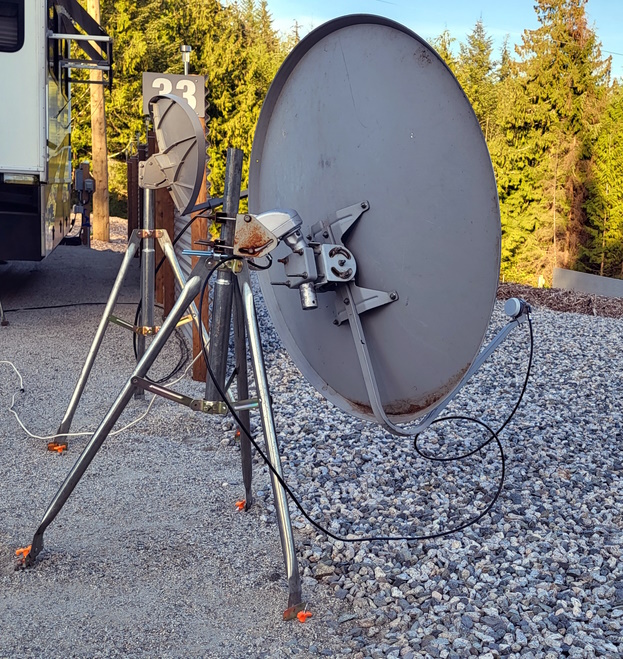

A short tripod (3 feet tall) is the way to go. A small 30" dish would sit nicely on this tripod and you can bang some spikes available at any hardware store into its feet to hold the tripod in one position. I gave up on pallets a couple of years ago once I tried these.
