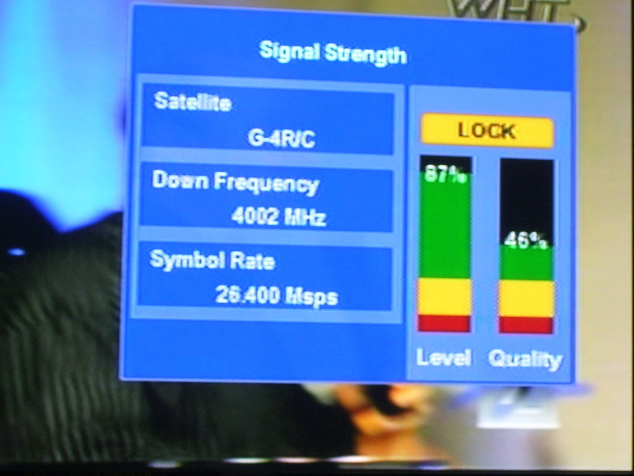

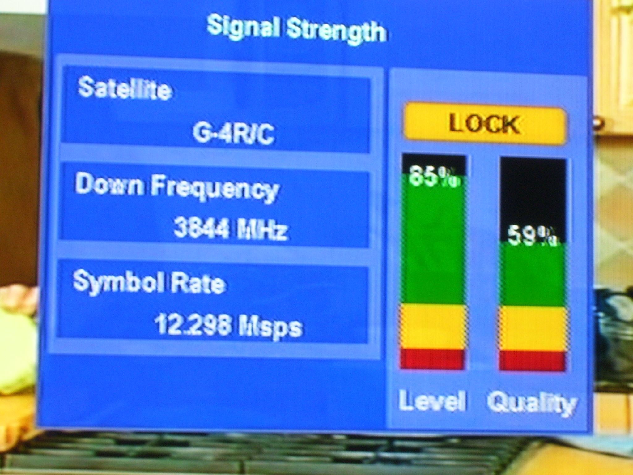

also since you are using a smaller dish (1.2 I assume) You may have to compensate one signal to gain another. You mention 75 quality on WHT but 0 for the nets. I had same issue and I learned to compensate. On my 1.2m dish I had HIGHER results on Nets versus World Harvest
see attached
yes they are horizontal
see attached
