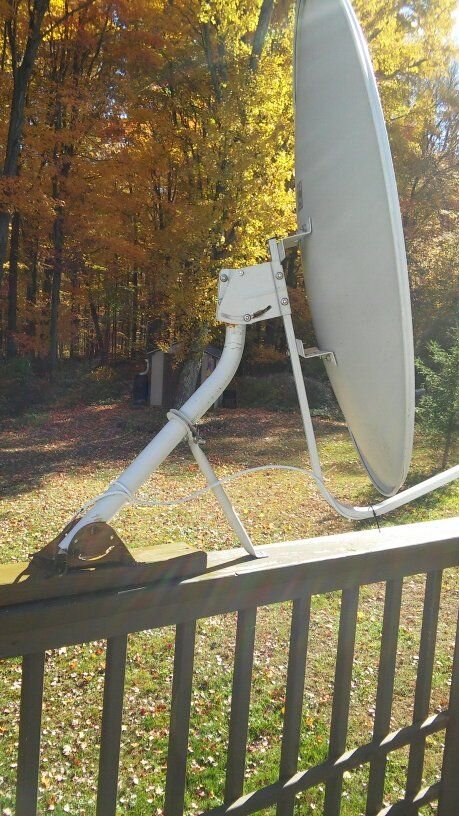

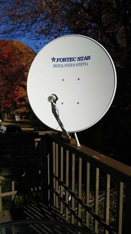

Well I abandoned my attempt to receive FTA signals from Galaxy 19/97W on an old 20" DISH (echostar).
Found that I could not lock in an adequate number of transponders and the picture quality wasn't good enough.
So despite several hours of searching and adjusting the dish, I resorted back to using an old 90cm KU dish. I wasn't having much better luck even with the big dish until I skewed the LNB properly after getting strong signal on my meter. I also learned that I really didn't have to disconnect the meter when viewing images on the tv!
Anyways next summer I still may try the same from an old directv oval 24" dish.
One weird thing is , I had to raise the elevation on my dish about 8-10 degrees from what satfinder calls for.
Maybe it's got something to do with the dish being used or the placement of the replacement LNB. The wife doesn't want the dish on our deck railing too long but getting strong signal/PQ for nearly all 175 or so chs. my X2 IV pulled in. about 72 PQ. See photos.
