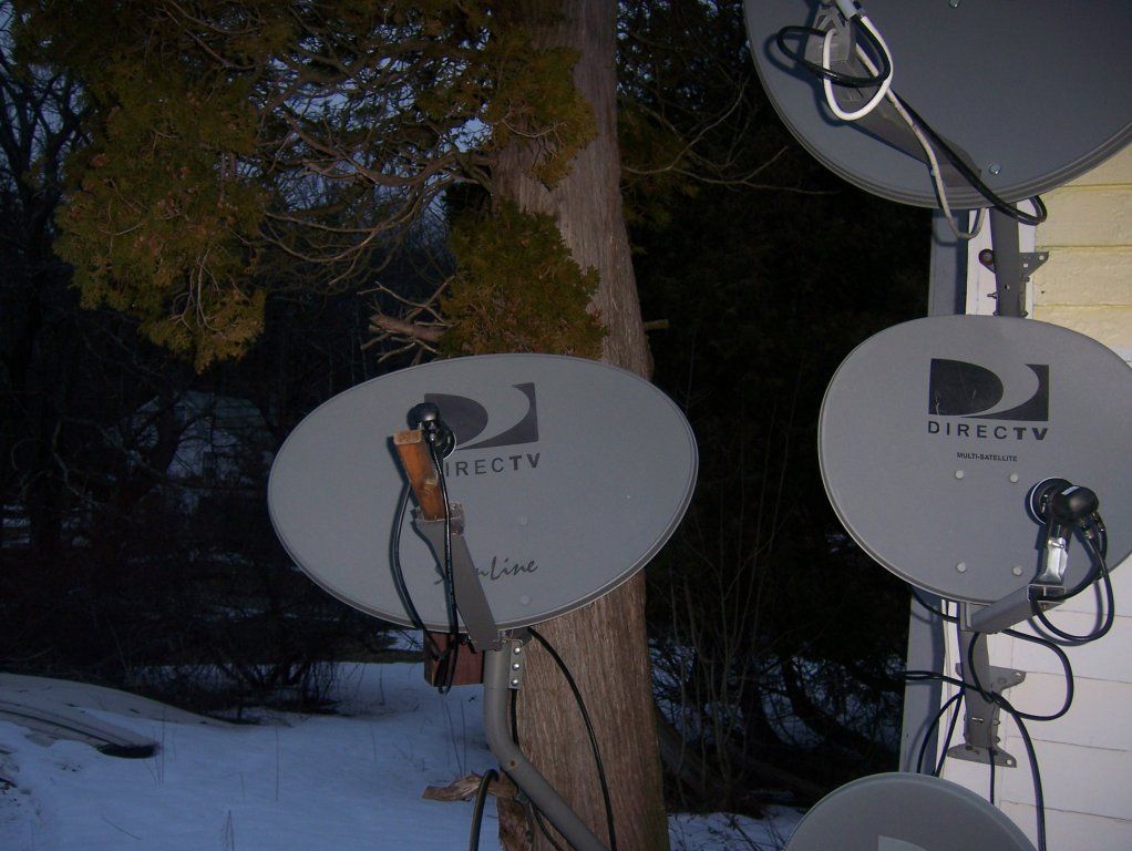

For that small of a dish, just get a universal mount like this:
Amazon product ASIN B002NHEZZ4
and definitely use a PLL Ku LNB. The PLL LNB will increase your chances with a dish that small. I have setup 97W on a 18'' dish with fair results, have a 20" on 95W, a Slimline on 121W, a few other small ones. It doesn't look as pretty setting it up with this type of mount and you will have to drill a hole, or stick a piece of wood into the feed-arm for mounting the mount, but it will work better. Cheaper too.

You can see how it can easily be done, in this picture above, as I tried telling you before. Trying to do it with a bolt on LNB exactly as original will probably only be a exercise in frustration. Even with a good PLL LNB on a 24'' dish, you will not get all transponders available and might not be satisfied, an original bolt on non-PLL LNB will be worse.
