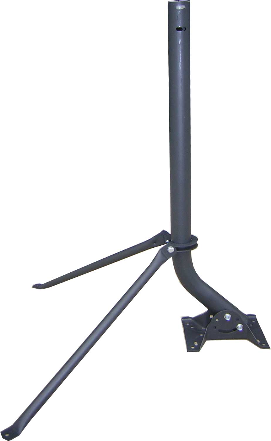

GeoSat 90cm Mount
mr.crane
Brian, or anyone has use this with an sg2100 motor. My question is will the
mount hold the motor without any movement. Or should a steel pipe be used
instead.
I have used this mast / support legs with a motor and 90cm for the past four years. Plenty stable when the base and tripod legs are securely mounted to rafters, studs, etc.
Thanks for answer Brian, still not sure if I will use a pipe, I do not want to flush mount to roof, as it is new
and not sure where the rafters come out. Also, this is a Mobile home, and the plywood under shingles is very
thin, and lag screw will not work. Tried it before I installed the new roof. If I use the pipe would a fence pipe
be sufficient? My neighbor is a welder and says he can make me a customize steel plate, where I can attach
the mast, but not sure where I would be able to secure the tripod legs.
2" or 2 1/2" pipe works very well for motor mounting. Galvanized fence posts can be used, but thick wall pipe will better withstand the crishing pressure of the motor clamps.
Had you given any thought to using a non penetrating roof mount? NPRM units would spread the weight and wind load forces over a large footprint. The are several styles including flat roof and over the peak.
Definately do not use a mast and tripod support legs without structural support. Even if the sheeting were heavy, it is not a good idea to only lag into sheeting. Lag bolts quickly work loose in sheeting.

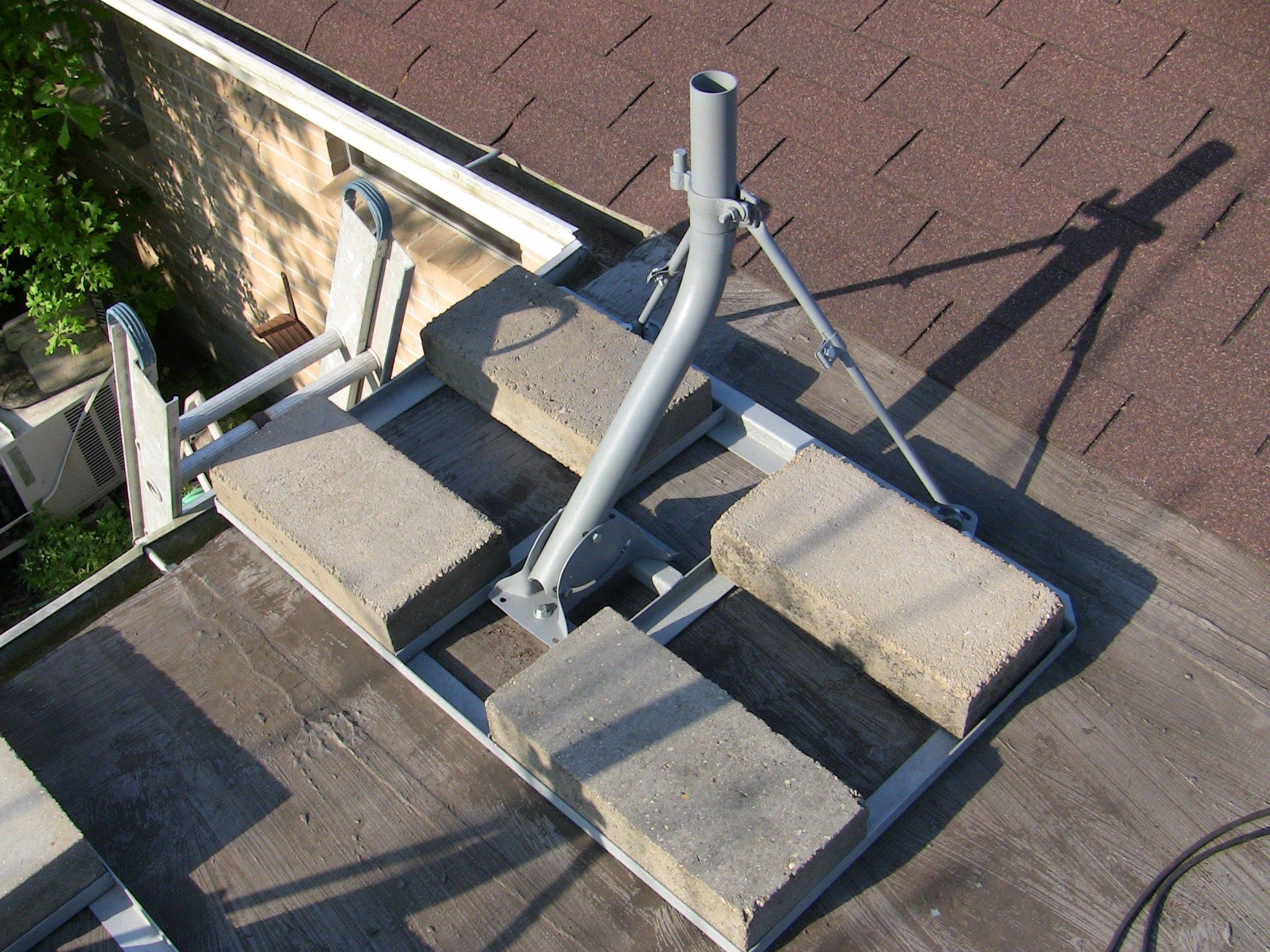

I am now using DirecTV Slimline J-poles and struts for my motorized dishes. Best, most sturdy mount I've ever used! Best of all, they are VERY easy to level.

The base and mounting pole/struts were purchased from separate sellers on E-Bay. The base is a rather common NPRM base used by Dish and DirecTV installers for Superdishes and Slimlines. The J-pole and struts come from a Slimline package. The only requirement is four 4 x 8 x 16 solid blocks. If the carport can support that weight, you should be okay.
