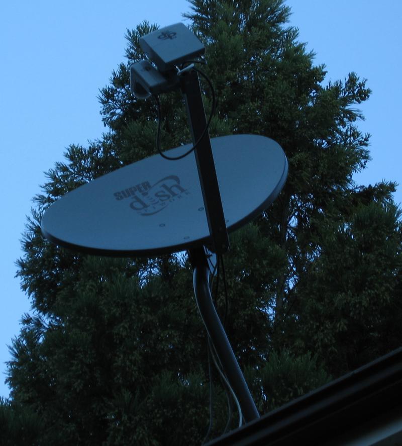

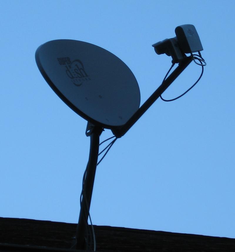

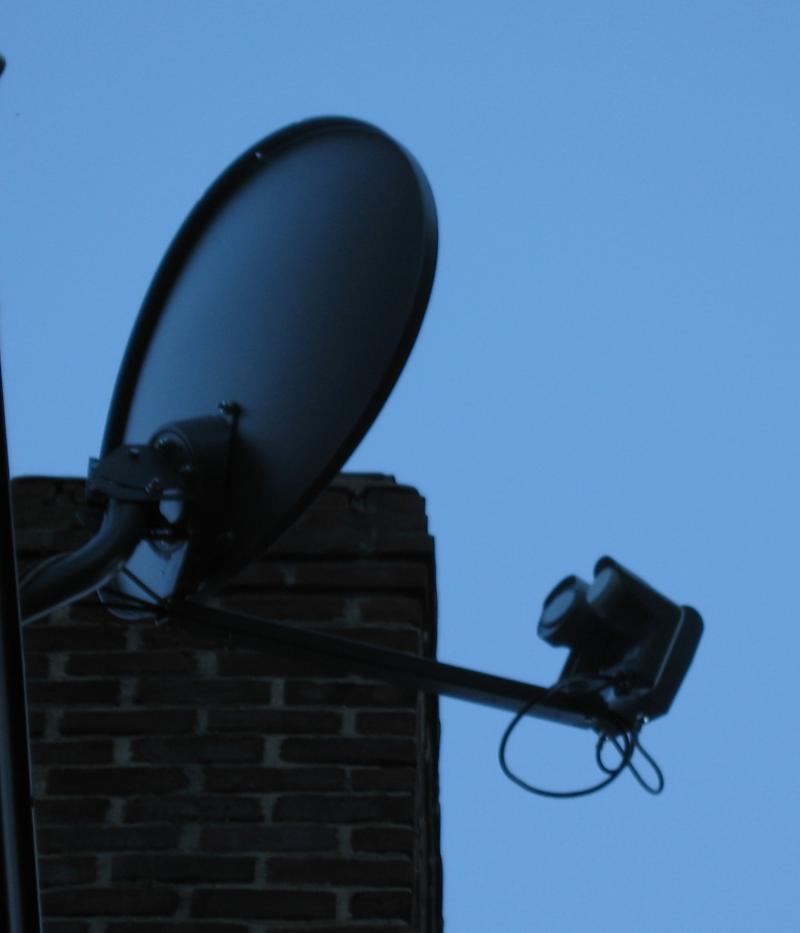

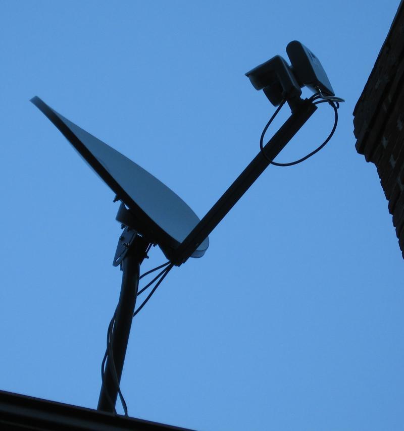

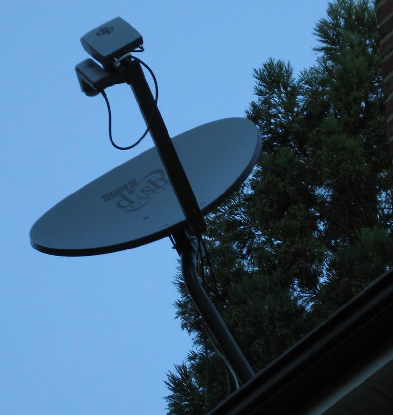

Here are some pictures of the SuperDiSH 121 with repoint kit which has no real fancy name, so I call it the SuperDiSH Plus.
The installers tossed the 121 LNB parts down as they pulled them off. They said that Wachovia is the only 121 hold-out.
It required skew, elevation, and azimuth adjustments due to a non-plumb pole (I rely on installers for roof work). They grumbled about missing struts but adding them requires moving and more holes (each hole had a lag bolt so we were comfortable with it).
Getting the 625 and 322 receivers to work took a while--they only really worked when the "scanning for satellites" message appeared after pressing Test on the Check Dish screen. The 625 was instantly working, but the 322 took a really long time.
Pictures are attached. I did not have enough light for detailed shots of the LNBF assembly.
When I grow some courage I'll stuff the cables a little more neatly.
The box with the repoint kit is labelled (paraphrased) "SuperDiSH Repoint Kit with 129 Bracket."
It appeared to have come with the 110 LNBF pre-installed on it and I'm assuming the 129 bracket stayed in the box. I did not ask them to leave any parts because the work order indicates the old/unused parts are to be returned.
The work order also noted that this was a Chinese subscriber and that translation is available via telephone through "silent option 3."

Yeah with the loopy 110 cable I'm not sure why they didn't pull the slack. It was loopy on the 110 LNBF on the original 121 assembly, too. It's a messy installation but no matter how you look at it the service was free and I don't have a 28-foot ladder (and btw neither did they, they did lots of acrobatics to get up there).
Which reminds me--is it physically impossible to feed cables through the mounting pole these days?
I always feed through the pole. It's just nicer.
Am I missing something peculiar about the SuperDiSH pole?
Keep in mind I don't have the 28-foot ladder yet.

It's a 118.7 repoint kit....I did one the other day..For SUN TV..South Asian...The Chinese Pack is being migrated form 121 to 118.7..Your tech made abig mistake if he damaged that 121 LNB. In order for us to get paid for the reepoint kit install we have to RA the 121 lnb back to Dish..Oops!!!![/I]

sloppy sloppy sloppy...Where the heck are the support struts?

We junk the shroud. Don't need it. The new LNB assy's are all weather. Besides, that shroud was the worst engineered, worst designed POS contraption.
If I were in your shoes I would call Dish to complain about the missing struts. Demand they come and install them. Trust me on this. You will want them..
