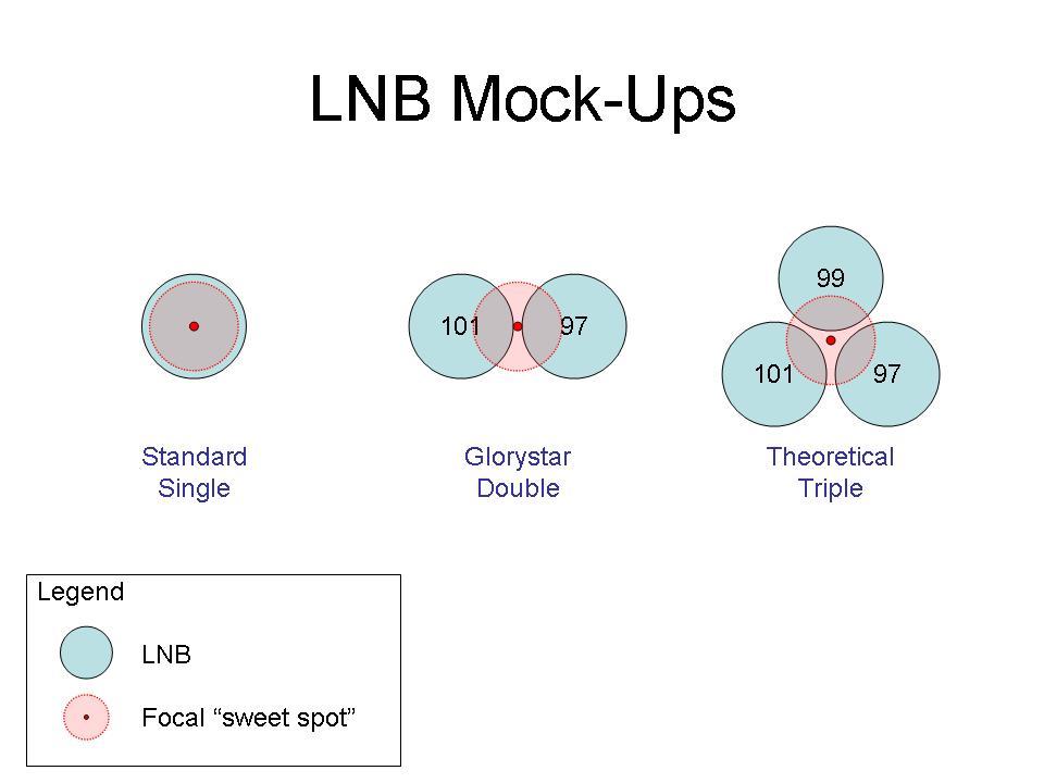

Can you tell me where my thinking is off? I figured I could draw a picture better than I could describe what I am thinking of. Please take a look at the attached image and tell me where I have erred. Admittedly if it worked, this would qualify as a "mad scientist" approach and would require modification of the LNB arm to attain proper alignment as proposed in the graphic on the far right.
Thanks,
Red
EDIT: I forgot to mention that I envision using bullet LNBs for this due to their small size.

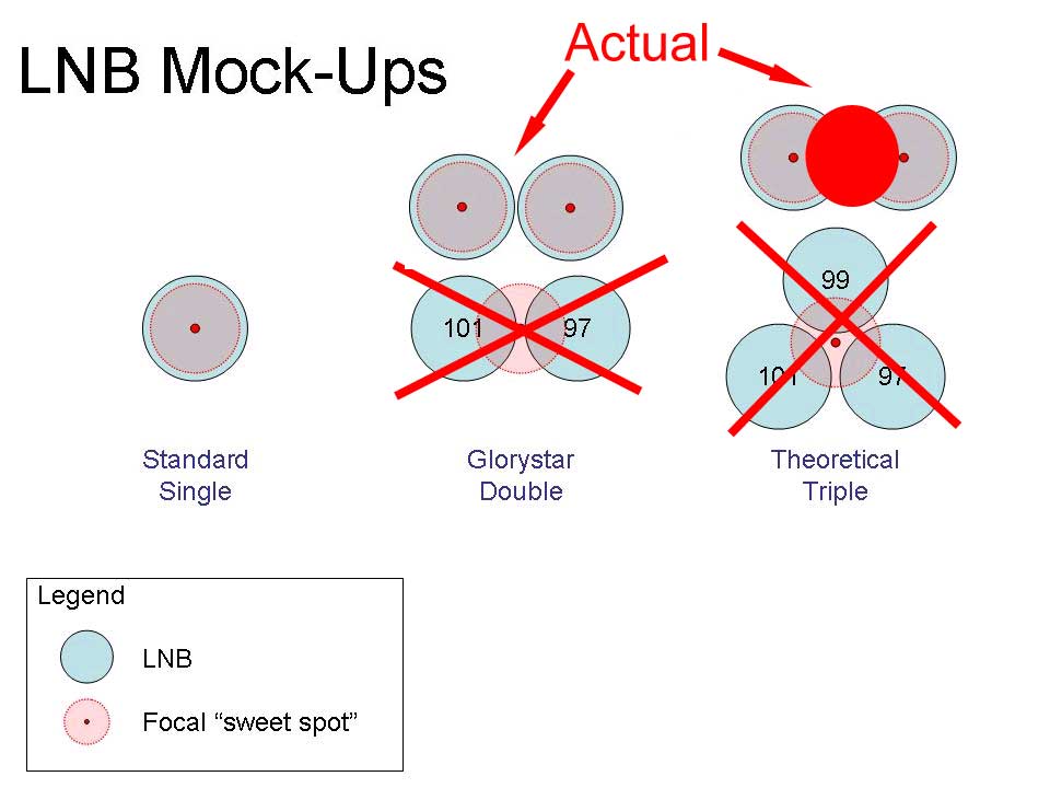

Incorrect assumption. All satellites do not merge into one focal point. Each satellite is reflected into the feedhorn of the opposing LNB.
Example: satellite located on left will reflect into the right side LNBF, right side satellite will reflect into the left side LNBF and the center satellite will reflect into a center LNBF.
I see. I guess I should have realized this from fiddling with my D1000.2.
I have seen multi-LNB dishes (not reflectored like the T55 and T90) various places (including here). How do differences in horizontal alignment figure into this?
Either way, my idea is defunct until someone figures out how to beat the 4 degrees available with the bullet LNBs. Once again, I leave disappointed in my original misunderstanding but happy with the education. :D Thanks - really!
