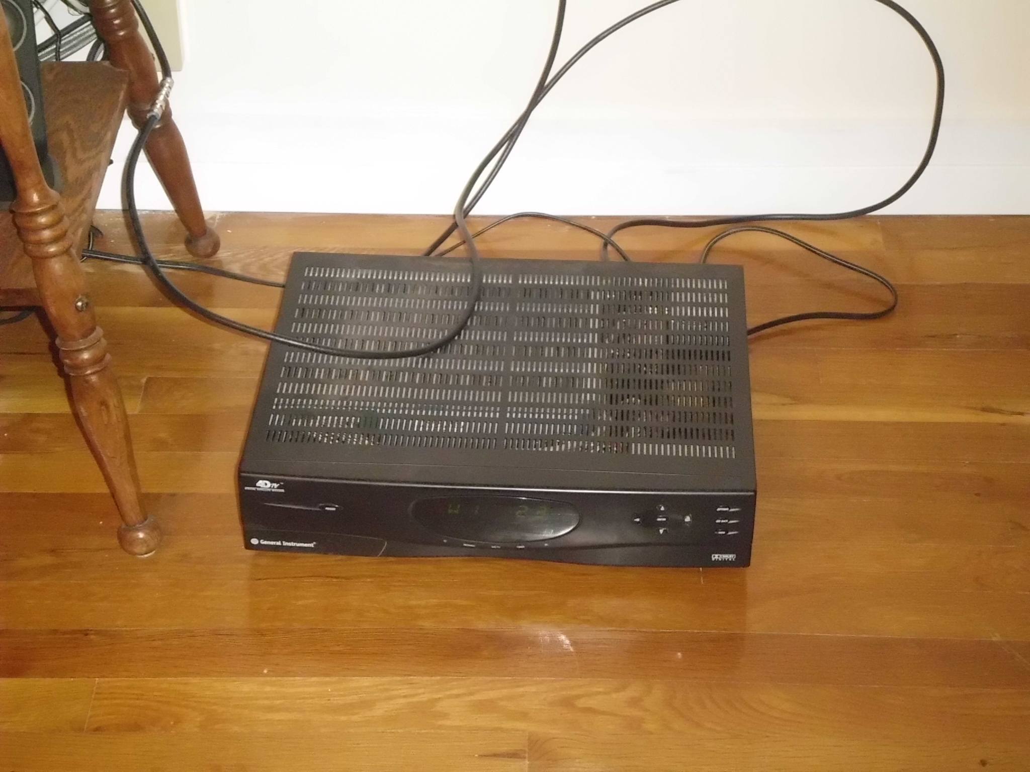

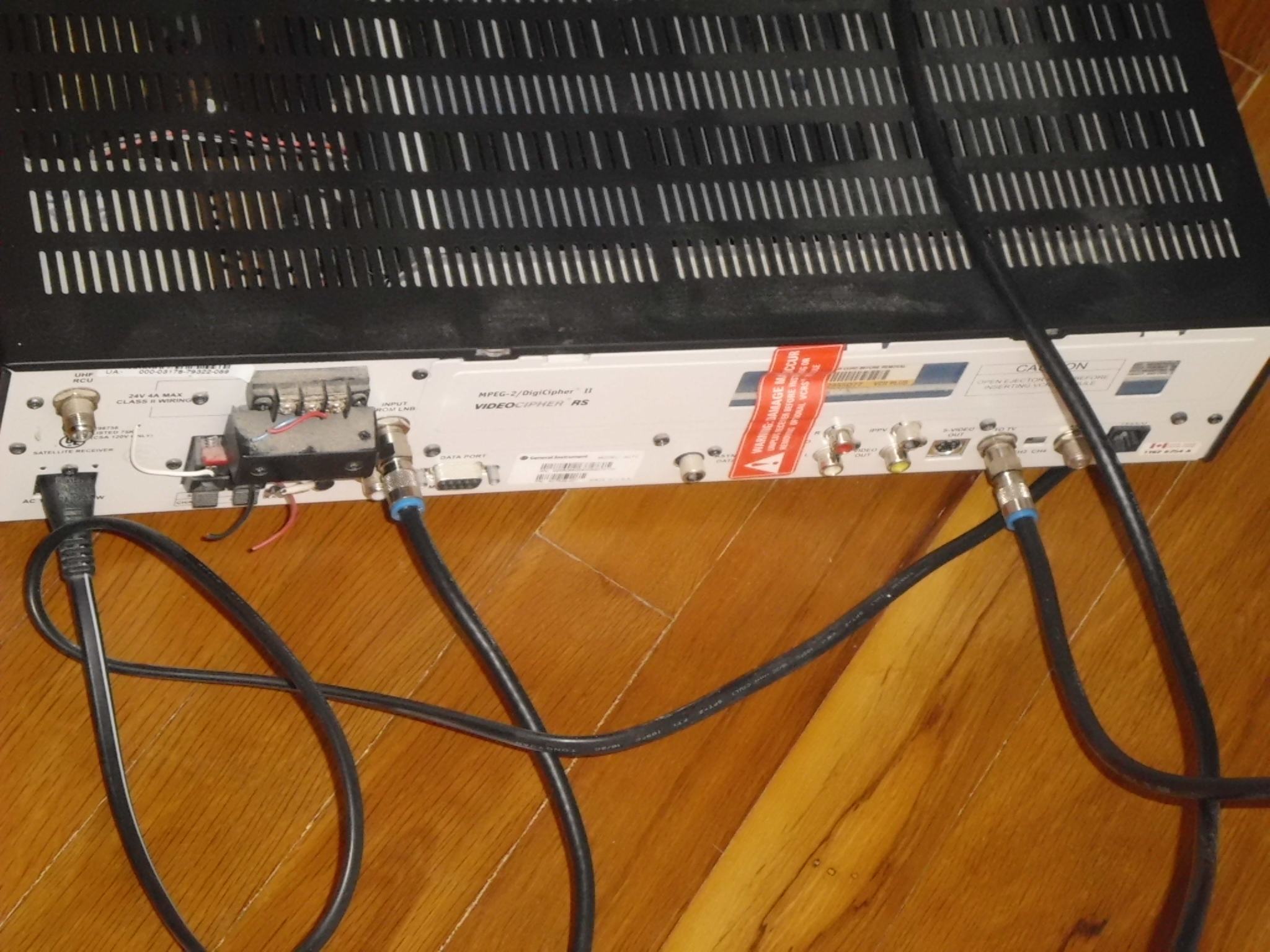

Does anyone know how to program this General Instrument receiver? It has vc 2 plus installed. I know how to use my Manhattan receiver with a 7 1/2ft BUD with no problems but I'm lost on old school receivers. Can I update the software install? How do you check the battery on the receiver?

To check the battery first you can go to the system settings screen and check system status. Verify that the receiver number in that screen matches with the back of your unit. In order to check the voltage on the battery you would have to remove the cover and check it with a Voltmeter. You may be able to read the date on the battery. If it is a red one it is probably very old and you should replace it asap. The mapping program is available through the links in the cband section. With that program you will be able to update your maps in your receiver.
Receiver number on system status match the back number on the receiver. System status current version 0000006D.
Pull the VC2 Cart ASAP!!!
Check the system status screen to see if the UA # 000-etc.... matches the label on back of unit.
In case you don't think of it-unplug your receiver before you try removing that VC2 descrambler module, it could possibly do some damage otherwise. It should just slide out once you gain access to the module.
