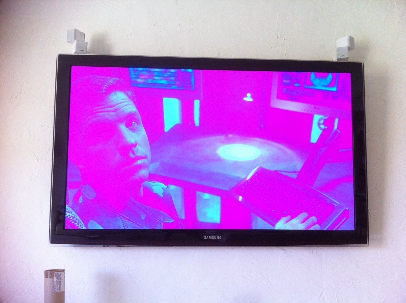

Pink Screen
Often when changing channels or bringing up guide, menu, etc., I will get a pink overlay to entire screen. Turning DVR off then on will fix it. Tried reset, no change.
HR-21-700
Often when changing channels or bringing up guide, menu, etc., I will get a pink overlay to entire screen. Turning DVR off then on will fix it. Tried reset, no change. HR-21-700
havent seen that. Using HDMI? maybe a handshake issue? try unseating and reseating the cable or a red button reset.
Tried all that. No change. It started doing this immediately after the CE download Friday night. Guess I'll have to go back to NR.
Finally determined it would only give me the "pink screen" image when a channel change also changed the display resolution. Changed native resolution setting to "off" and now no more problems.
