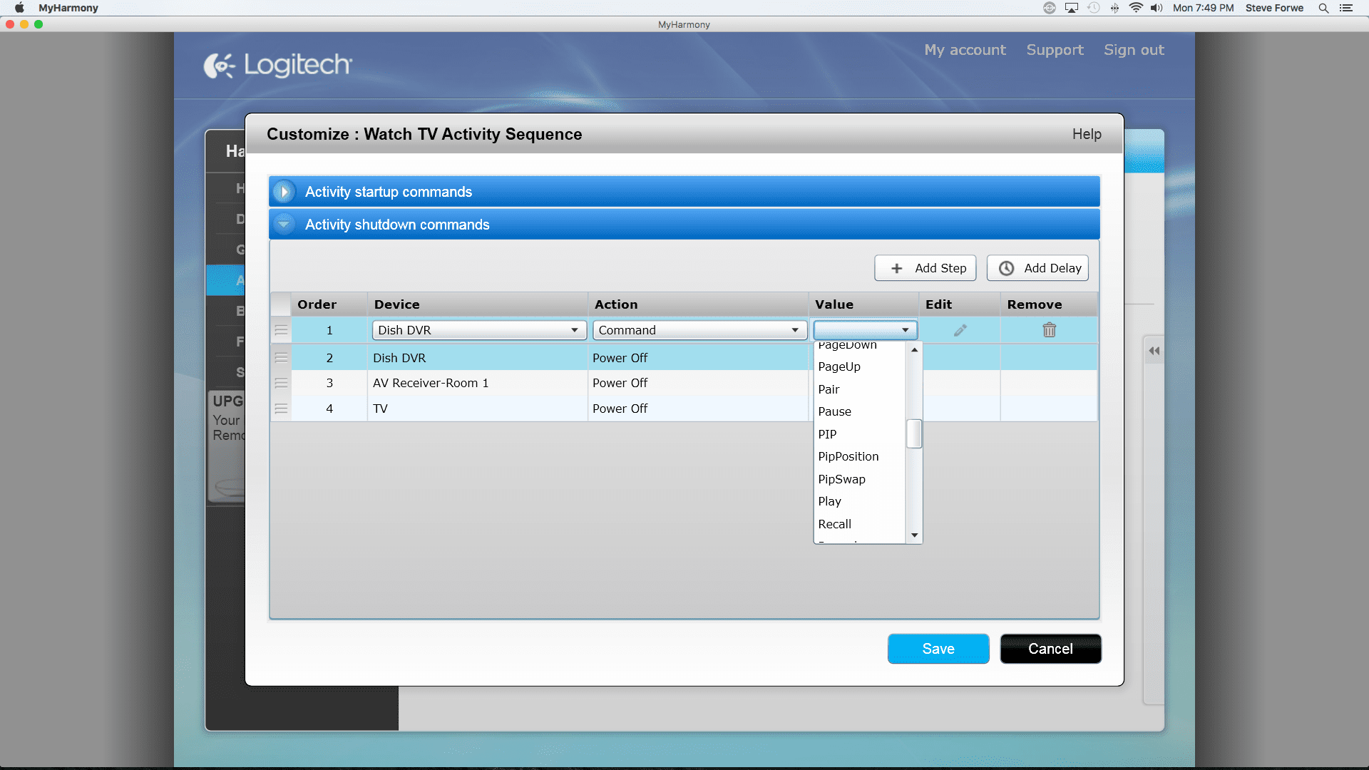

Do you have HDMI-CEC enabled? I found that same thing when I had a 722 and also a Hopper 2K. I turned that off and all was well....
I don't have a Harmony so I don't know how it behaves or how it's programmed but I do know the POWER OFF command is messed up, both on H2 and H3. For H2, POWER OFF worked fine until some software update, then it started working as a power TOGGLE. On H3, POWER OFF does a power ON.
It's possible Harmony recognized this and did as I did and programed power off as: POWER ON, delay, POWER (toggle).
I also programmed the power on sequence as POWER ON, delay, CANCEL. This gets rid of the home screen at power up.
The Power on trick works like a champ, but when I go to edit the Power off sequence, There is no Power Off selection.
The Harmony needs to be set to Toggle rather than Power Off.
I was just about to post I changed to toggle!!!!!. Not sure why it changed, or when it changed, but all is good now. I have another small issue I will test you on Bobby, but not tonight. I'm going to bed!!!! You da man!!!!!!!!!
