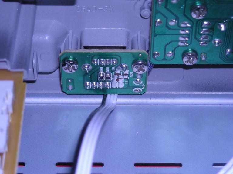

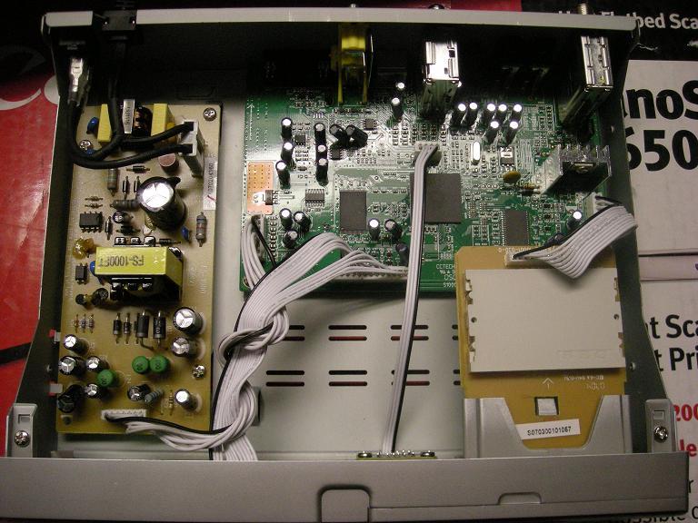

I love the Visionsat 200. I don't like the fact that the usb port is on the front.
I was wondering if anyone has peeked inside their box to see how the usb port is connected to the mainboard. If there is a usb socket on the mainboard, then it would be a fairly simple task to make a small opening on the back of the box and, using a usb internal cable, run the usb port out the back of the receiver. Of course this would void any warranty, but at least I could close the front door :)

My buddy emailed me photos. See attached pictures below.
I'm pretty sure I also took off the lid and looked for myself. :)
