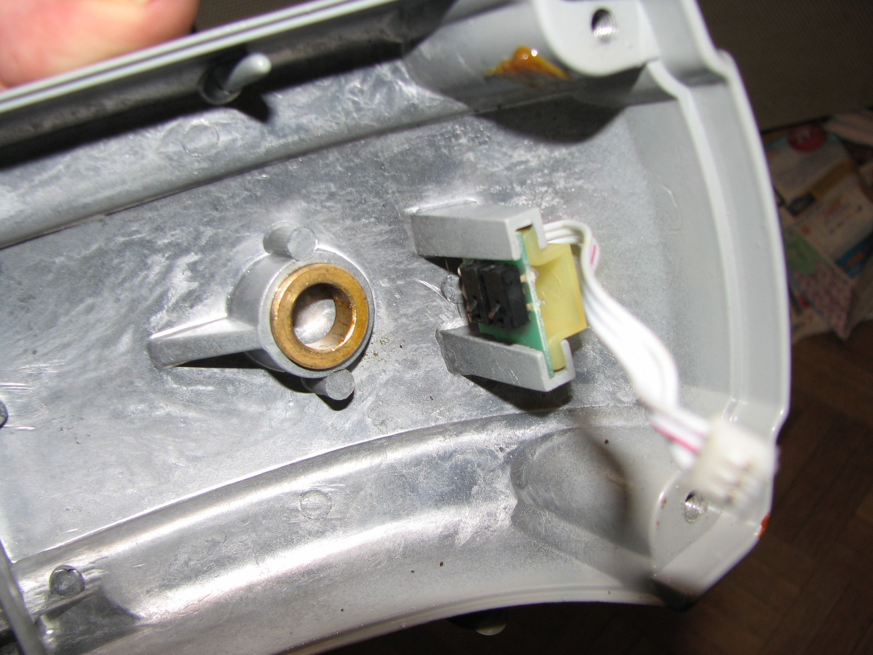

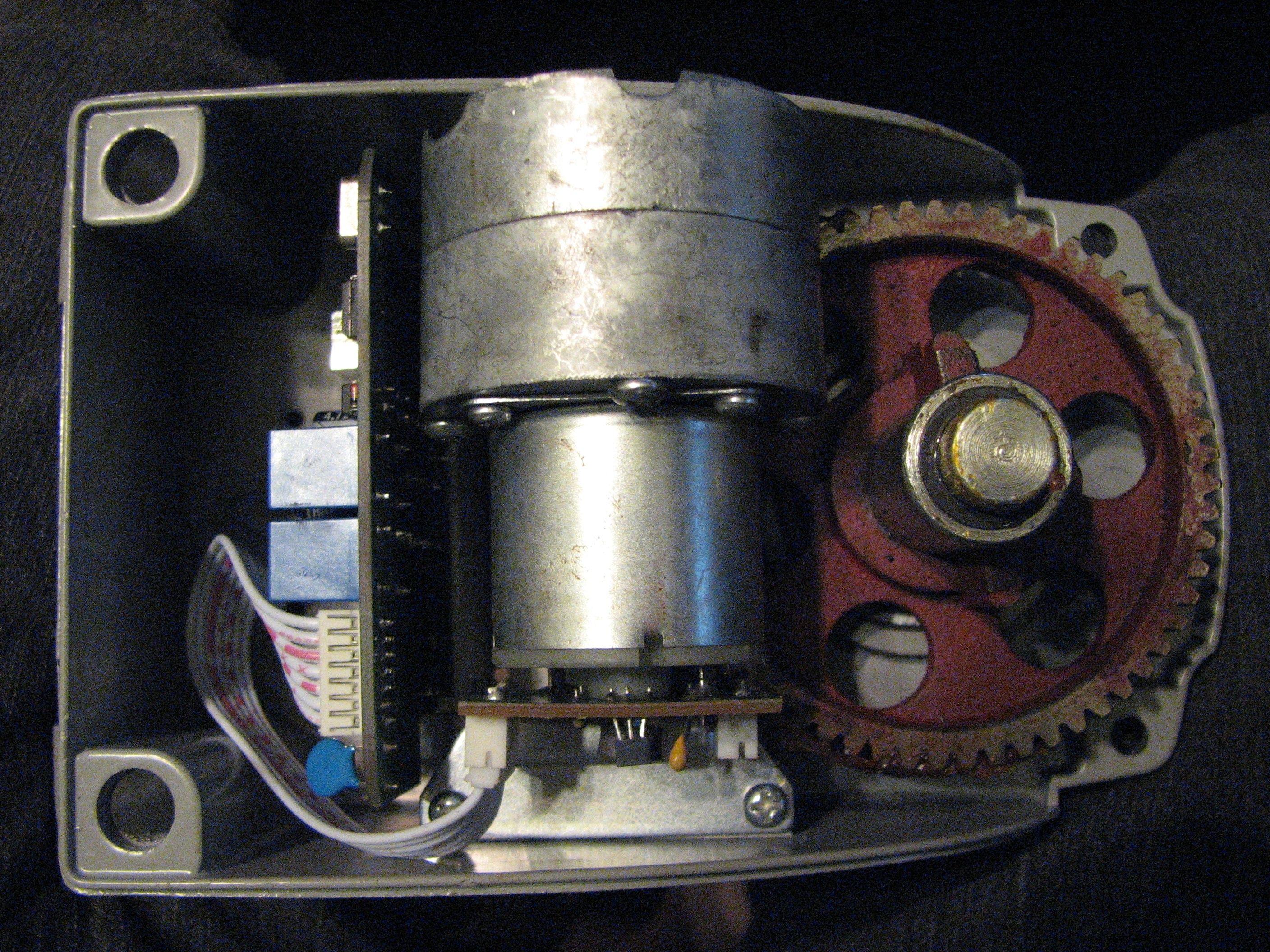

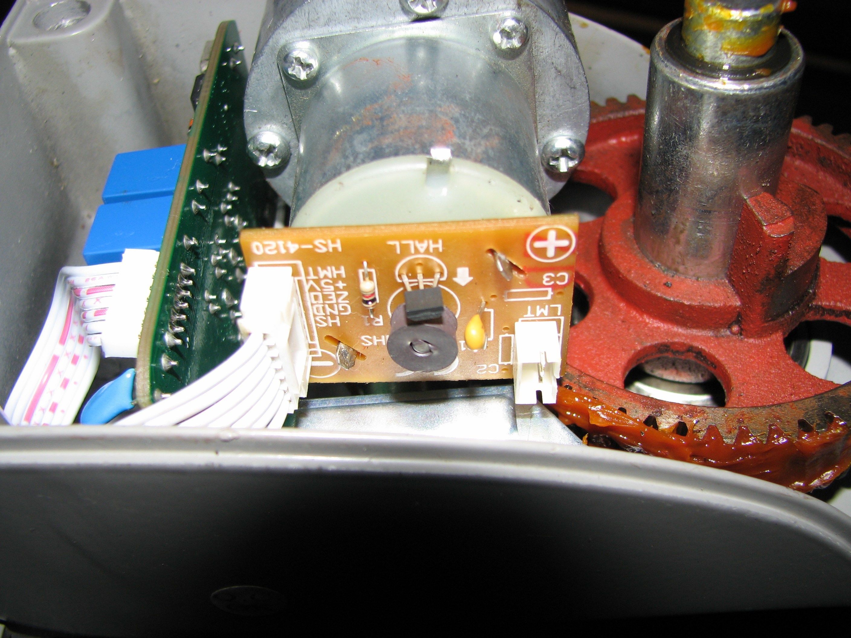

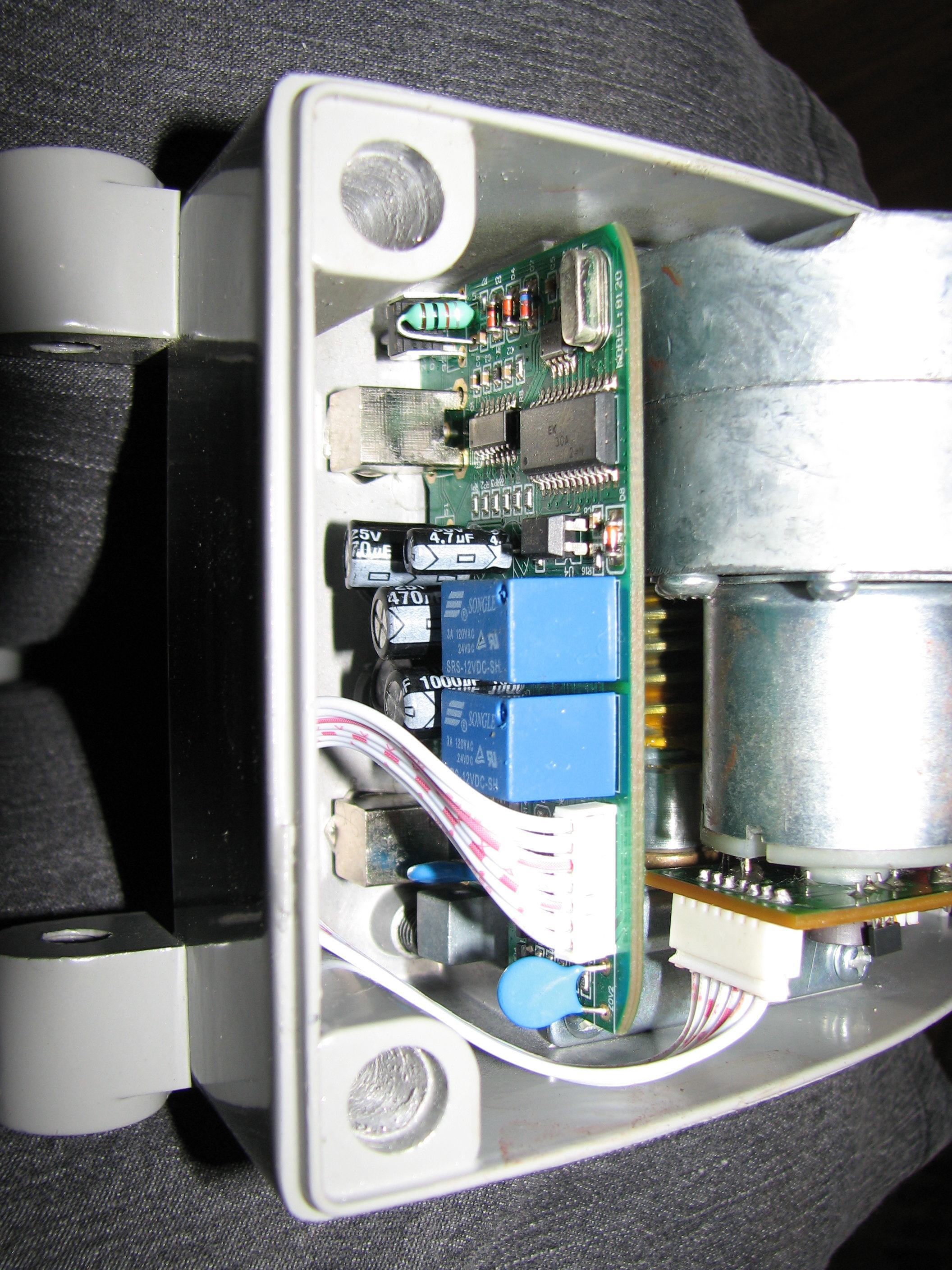

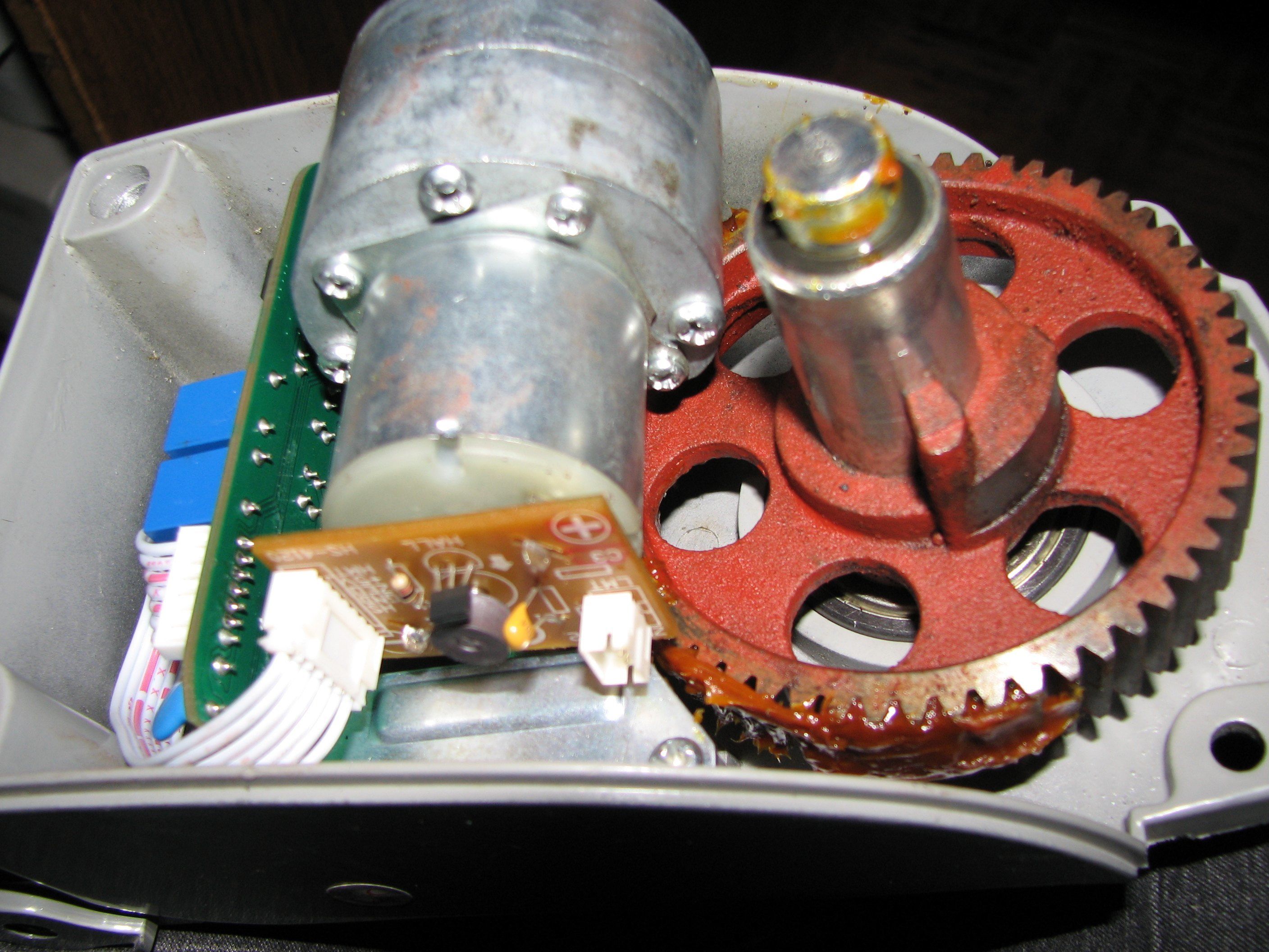

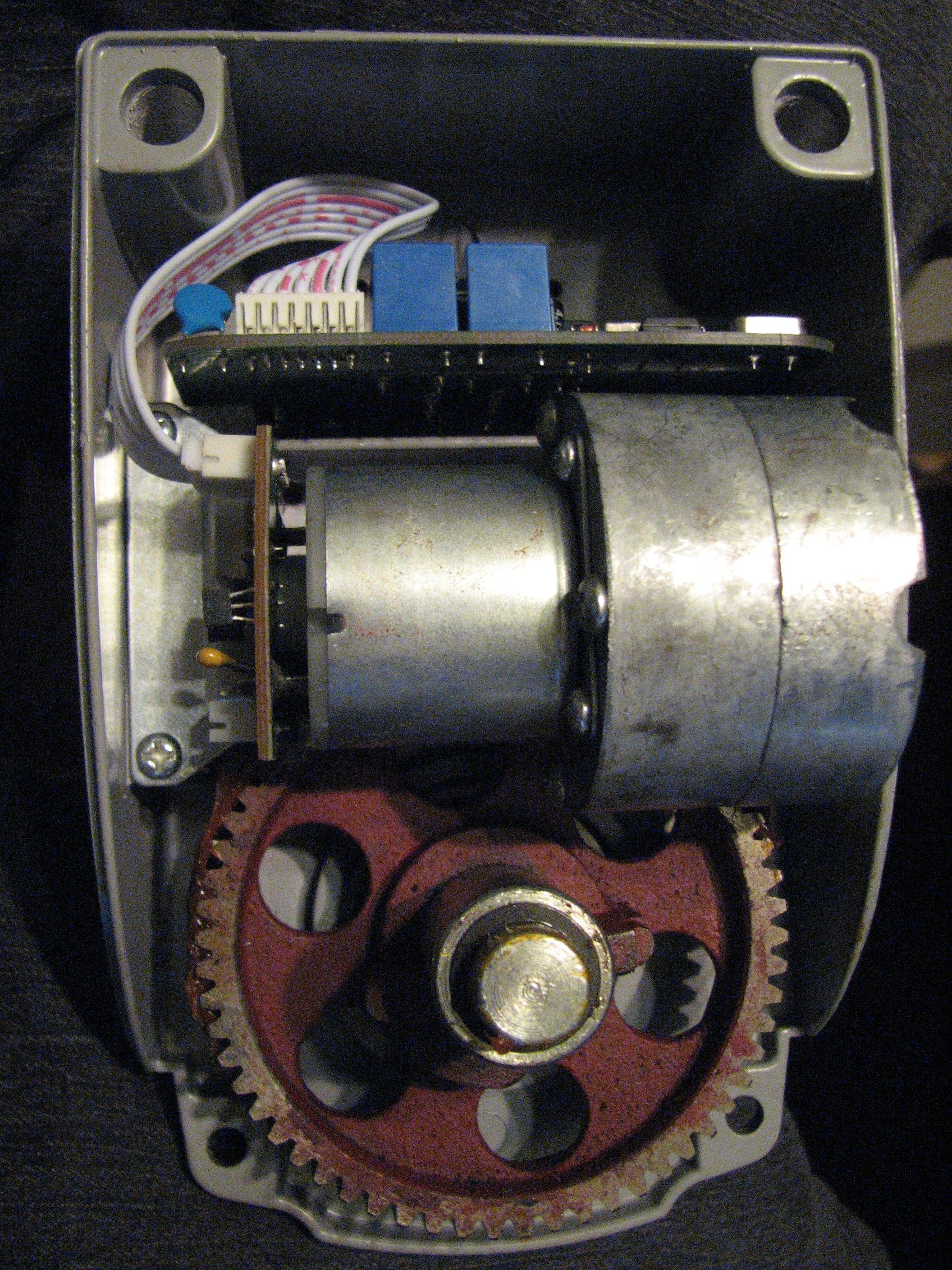

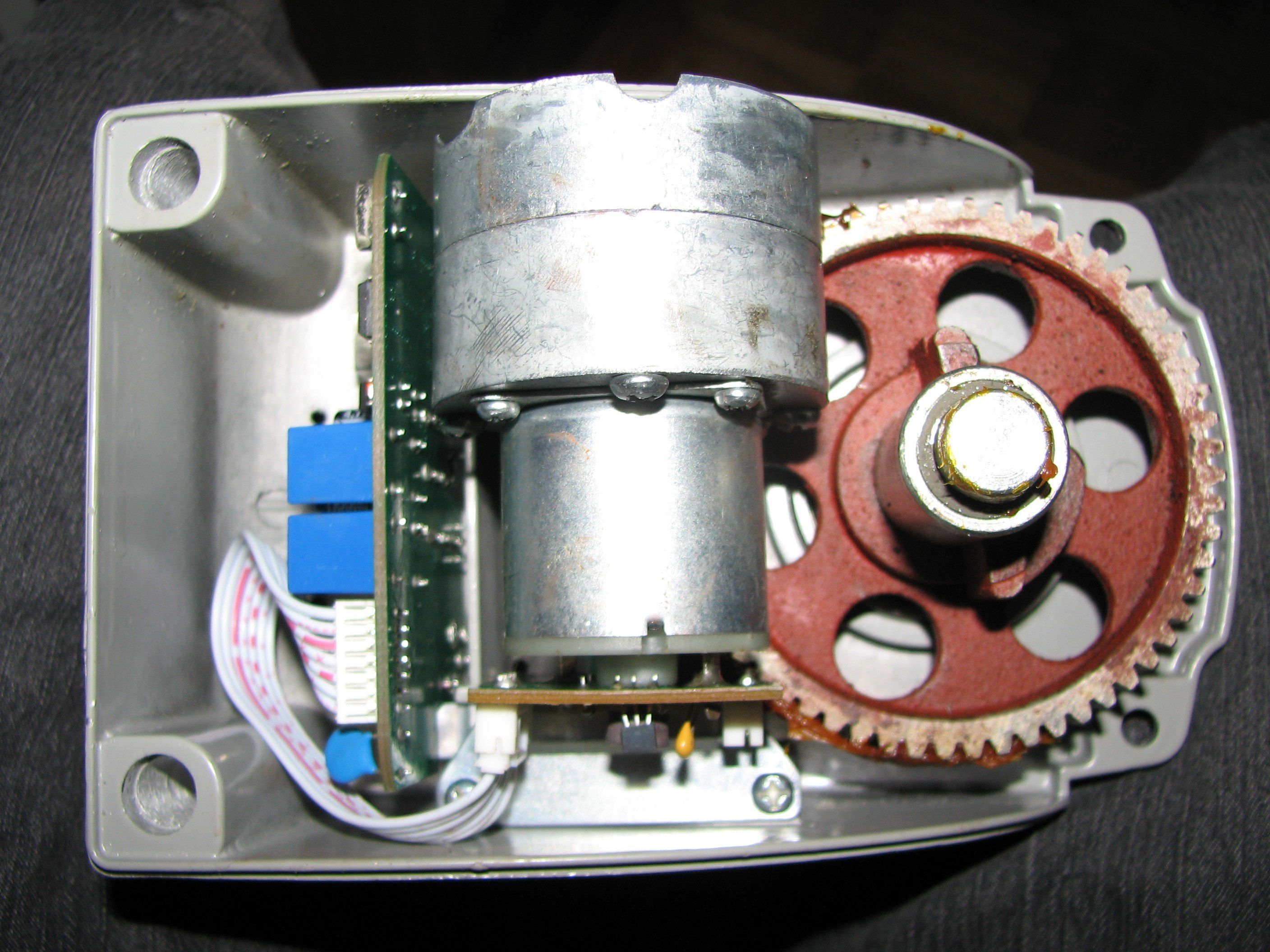

Out of frustration I have done the unthinkable. I'm sure this was a huge no-no but I don't care. Another reason was my dad has the same motor and it's wiggly and we tried to adjust it and that didn't work, he wanted to see inside my motor before he opened his. So............
Opening it was simple. Four screws.
The photos are LARGE so that you can see the details.
I have no idea what can be done with this but maybe you guys can figure it out, I know y'all are 1000x smarter than I could ever hope to be.
Maybe y'all can invent a way to fix this and my dad could add it in, I'm not about to mess around with the insides of this thing.

Not me, I'm not the genius that figured this out. I'm "Monkey See Monkey Do" kind of guy. :)

It's one thing to open something up and take a photograph of it but messing with the electrics when you have no clue on earth about the stuff, no no no no.... :rip:
Big Badda Boom.
Ok, tomorrow I am taking my HH motor down and opening it up for some super macro photos. I want to try to compare what's in my motor to the motor pictures in the "heart surgery" guide. I need this stupid thing to do something. I paid a lot of money for it and it's sitting there gathering cobwebs.
While I have it open I might as well have my dad take a look in it because he has the same motor and it has serious wiggling problems.
the motherboard in your motor will not be the exact same as the SG2100 in the PPT. The concept and the little blue relays are the same. If you could understand just exactly what this mod does and how it works you could apply it to the SG9120 motherboard.
