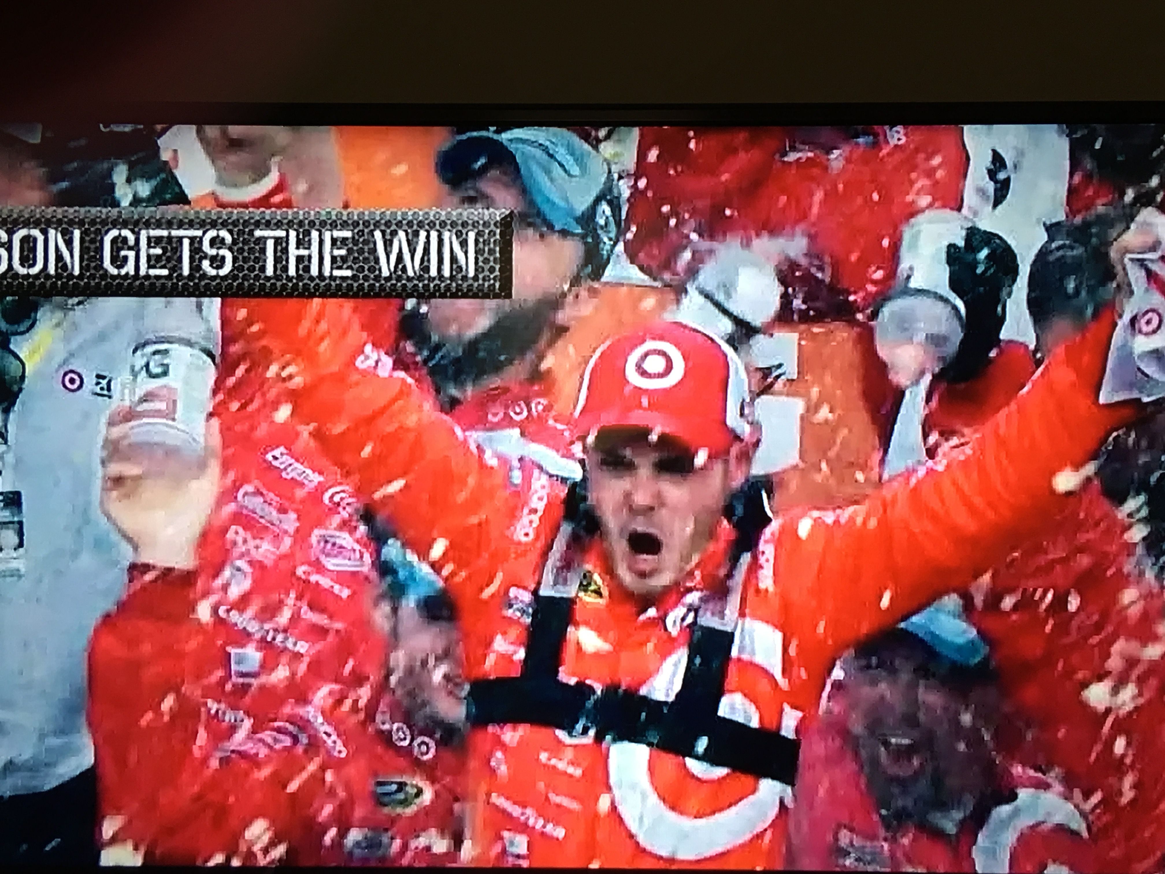

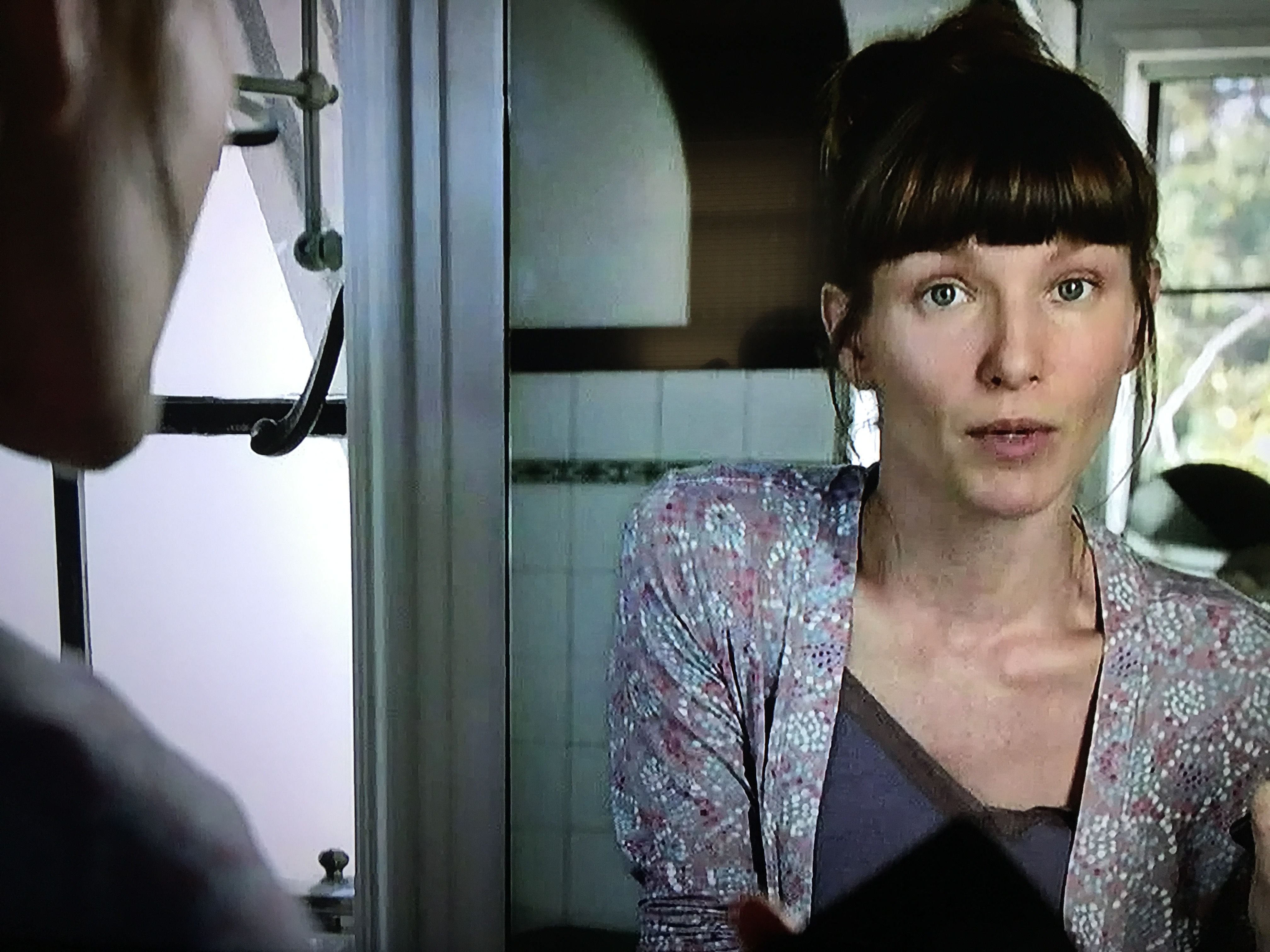

Hey guys, I did check to see if zoom was on and it was not. I do have the hopper set to 1080i and I have an expensive HDMI cable in place from the hopper to the TV. I tried to take a picture to kind of give you an idea of what's going on. I just continuously see artifacts, I don't remember the picture being like this on dish when I had them in the past, I would see it a bit on DTV but nothing to this extent. Am I just going crazy here? I know my dish is on the eastern arc I'm wondering if the signal is not very good. Does anyone know what dish and transponder i should check and see if we can get numbers and see if that's the cause?

Signal strength plays no part so need to worry about that. I see what you are seeing in those pictures. Especially the first doesn't even look like HD. Just confirming those are satellite channels, not OTA and are locals or not? The only way I see that especially in the faces is if I am right up to the TV, even then not as bad as your picture.
I always make sure I go for the HD channel, no OTA here. It's pretty bad I'm watching NATGEO Wild in HD right now and the picture is quite bad, I can certainly expect this from SD but not HD channels. :( The pictures were taken from satellite channels and the one with the driver was from the NASCAR channel
None of us are seeing that, obviously we wouldn't keep with DISH if the picture looked like what I see in the pictures you posted all the time. I don't have Natgeow but I just checked Natgeo and the channel I am presently watching and I can be arms length from the TV and there is no where near the smearing in your pics - in fact virtually none. I don't know what if anything in the set-up would cause that. Perhaps others familiar with a Hopper install have ideas.
