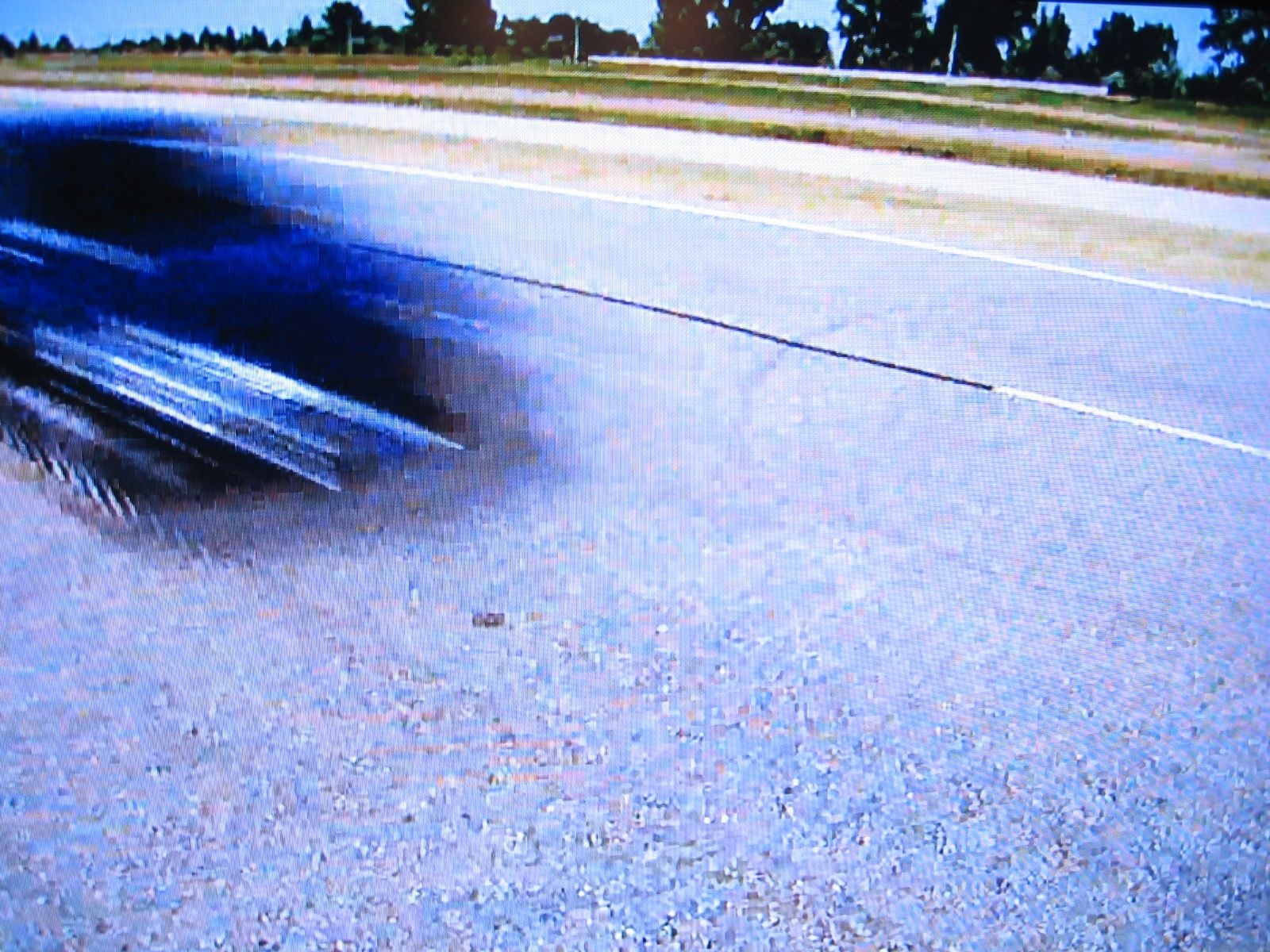

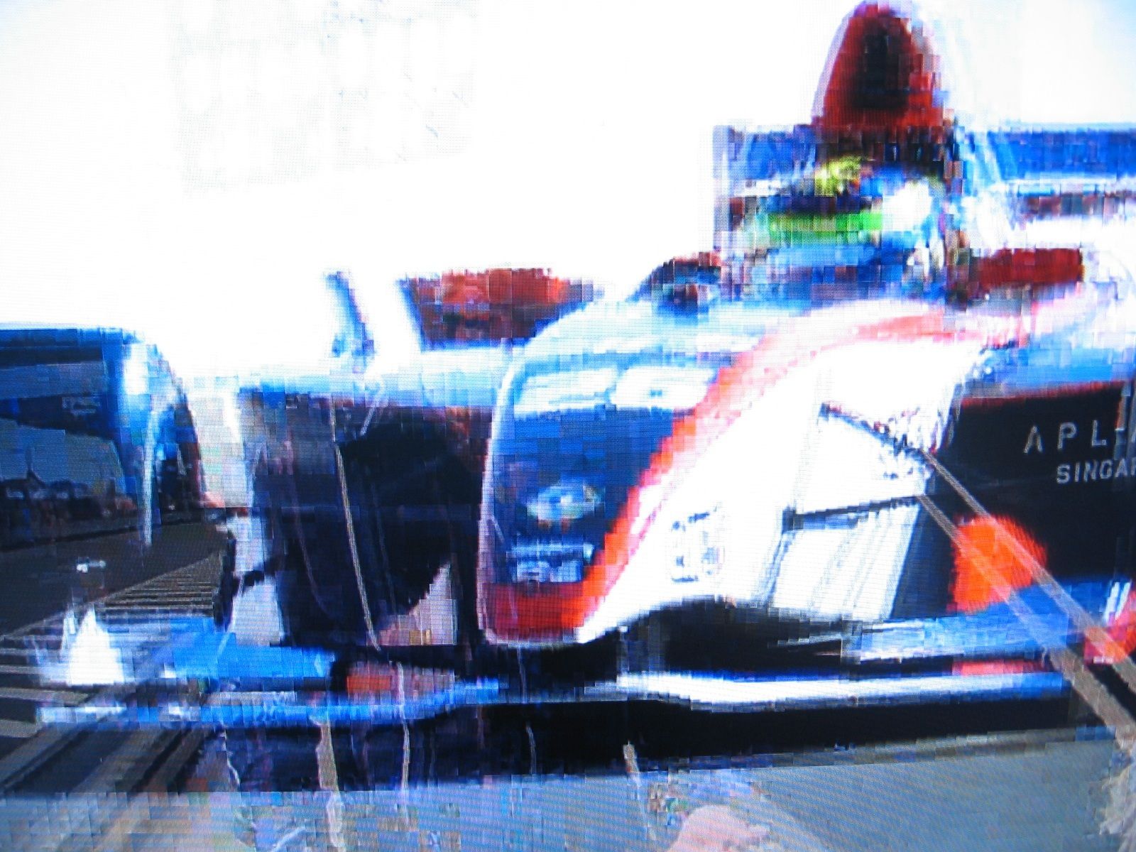

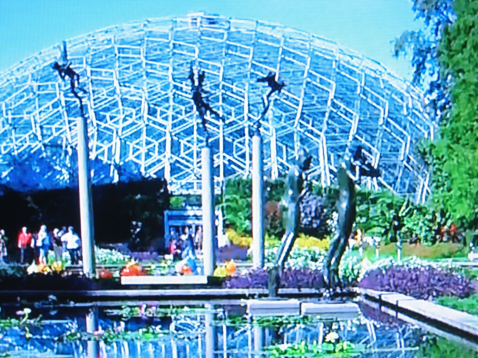

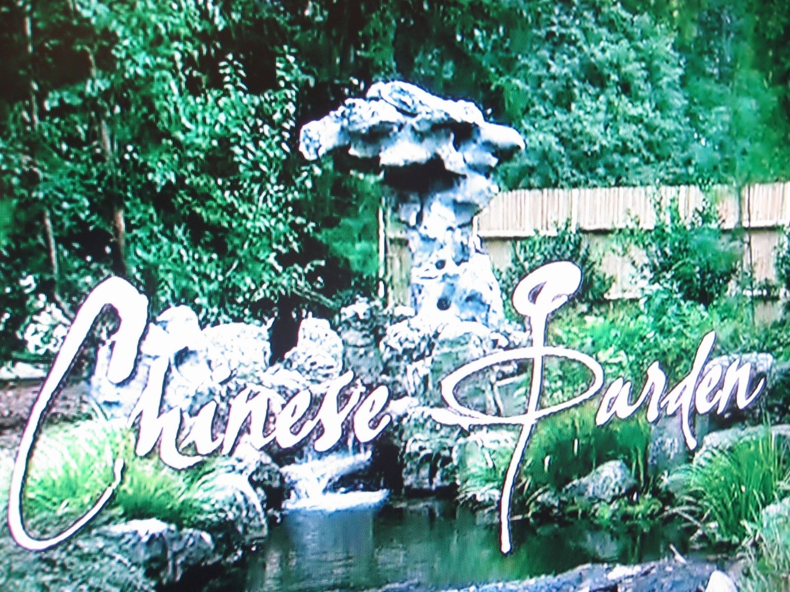

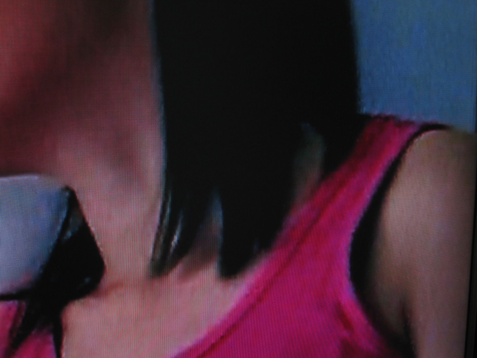

Lately my HD picture quality is just absolutely horrible. It's very pixelated on fast moving pictures, and very grainy on everything else. It's almost like having SD in 16x9. I've tried everything, including calling Dish out to check the satellite. Both TV's are showing the exact same issue. The 612 is hooked up via a Monster HDMI to the LG and the 622 is hooked up via component to the Samsung.
My signals are green for 110/119/129 and are all above 40. I have a dish 1000, but it shows up as a 500. The cables on the dish are ONLY hooked up to 1 and 2. There is nothing on the LNB in or #3. Both receivers are setup for 720p output.
I've attached some pictures to show what I mean.
Full Disclosure: I'm in a 1950's house with 2 wire electrical outlets. Nothing is really grounded but everything is hooked up via a power strip. When I was working on the living room tv, there was slight voltage coming through the component cables (enough to make your fingers tingle). I have not been able to feel that in the bedroom (where it has the same quality issues).
The attached pictures are coming from both TV's. I'm using the Equator channel as test bed, but all HD channels look this way. I'm also only signed up for HD channels.

Pics are bad. Any reason they appear to be 4x3?

Pictures above are from my digital camera -- hence the 4x3. Oddly enough, the pictures make it look BETTER than real life.
