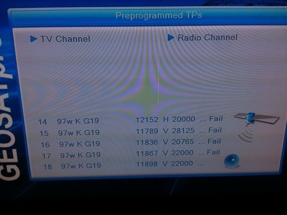

FAIL is my least favorite word right now LOL

I think I will uninstall the motor tomorrow and start from scratch...

do a satellite blind scan (not a transponder scan) and see what it picks up. Regardless of what satellite you have set up if it finds something it will log transponders/channels
Make sure you set up the motor on your true south satellite... Sacramento might be around 121W? Should some signals on that bird to line it up to. If all the rest of the geometry is good when you switch to 97W you should see the TPs light up when it gets there.

When I first unboxed my micro and connected it for the new FW download it was reading 97W on the opposite polarity for some reason. I did the download and reset and then it was reading proper polarity. I wanted to do that before scanning anything.
