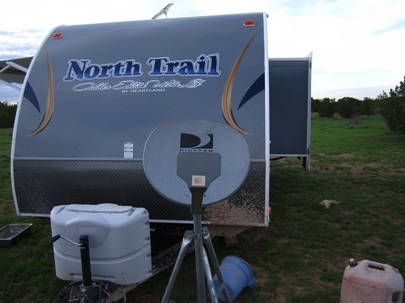

Kind of pricy ... this is the setup I use camping, I used to use an SL5 LNB but when I swapped to SWM I bought 2 SWM 3 LNBs and use a Phase III dish with good results.

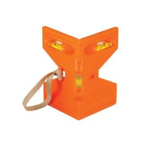

The only thing I would add to what you are getting is a post level from Home Depot. Chip mentioned this on a thread some time ago and I bought one. It really makes getting the tripod post vertical much easier. The cost is about $6.
Bob
This is what a post level looks like. They cost about $6 at Home Depot.
