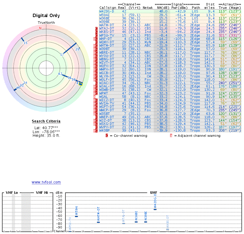

I'm much more rural than the OP. Here are my results from TV Fool. You can see they are clustered, but literally all over the map. My primary interest is the channels to the SW (24 ABC, 32 CBS) and the single channel (15 PBS) to the NW. Fortunately that one is strong and will come in even when my antenna (CM4228) is pointed to most other postions. I am also now getting translators of interest from the SE (42 NBC now, and 36/39 both ABC from another market and of interest when they convert to digital) 42 is strong enough from only 9.4 miles away that it will lock solidly even with my antenna pointed to the SW. I hope for similar results on 36/39 after they convert as they are co-located with 42. If I could at least get 32 consistently, or a repeater signal, I would have 4 of the OTA networks in HD fairly reliably. FOX is not available in HD in my area. My antenna is on a rotator and can be moved as needed, but right now I leave it pointed to the SW as those are the most difficult to get.
One strategy for the OP would be to use a simple fixed antenna like the VU-90 pointed at 60 deg. for the Phila stations he wants to get consistently, and have another, larger antenna on a rotator with perhaps with a preamp to get the rest of the fringe stations that are scattered.

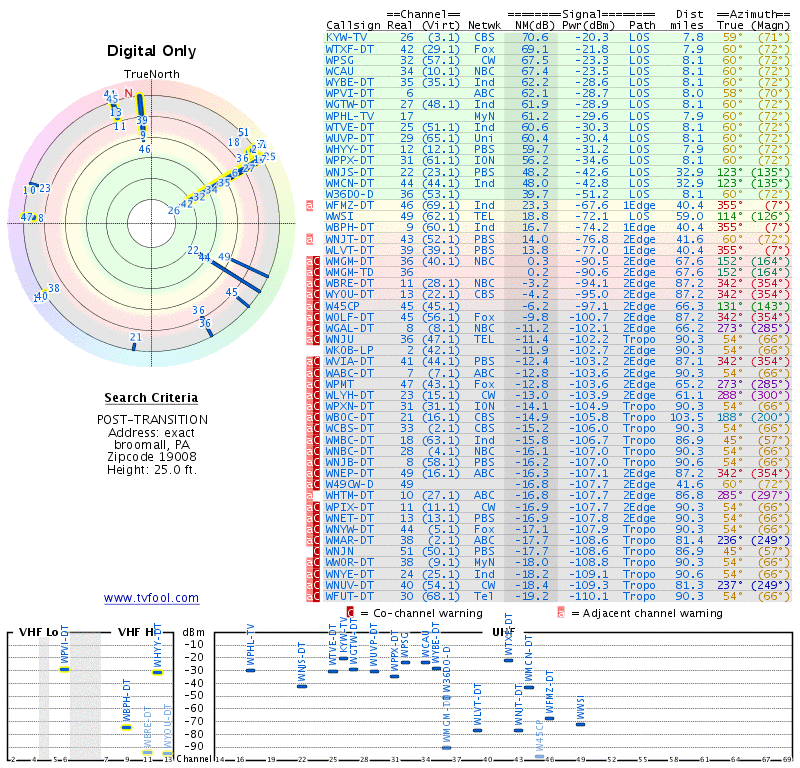

How did you get that image attached? It be nice if I could do the same so you could see the situation. Or just put in zip code 19008 and if you could do that. Thanks.
On the TV Fool page with your information appearing, right click on the image then save it somewhere on your HDD. Then in the SatGuys forum (this one), don't do a "Quick Reply", but instead click on the "New Reply" button below the last post. The screen that appears will have the ability to attach images (the paperclip icon in the toolbar). When you click on that you get a pop-up with multiple Browse fields. Use the first to find the TV Fool image you saved and upload it to your post. Add any additional text and a title if you wish. Voila!

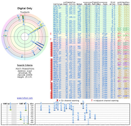

here is my chart
Look at what I get. Mostly the locals but any chance on the distants?
