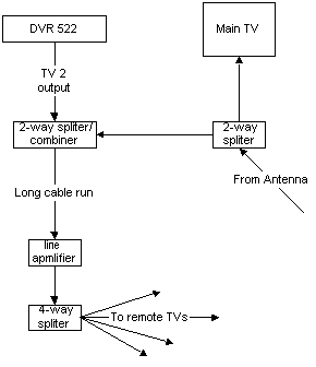

Diagram attached
Hi Simon
I attached a diagram showing where everything is. The combiner I'm using looks like a normal splitter but it says "Splitter/Combiner" on the case. I'm just connecting it like a splitter in reverse. I bet it does not block the signal from going back up the antenna.

Good diagram. I would put the amplifier next to the splitter/combiner, prior to the 'long cable run'. The way it sits now, you're amplifying all the noise induced over that 'long cable run'. That might be all it takes to get you running right.

I found the solution. Apparently the line amplifier doesn't like the antenna so I moved the amplifier next to the DVR and connected only the TV2 output to it. Then I put the combiner after the amp and it works great.
