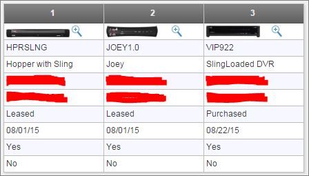

Not using it on my home Hopper network.. strictly the 1000.4 EA with the VIP922 in my RV. While the VIP922 is not the best choice it was extremely cheap and honestly I don't remember asking for advice on whether the VIP922 was the right choice. While a newbie with satellite systems I am not a newbie with forums. Thank you.
Are they two separate accounts? Can't have a 922 on a Hopper account, whether it's for the RV or not. 211 only.
Same account.. see attached...
The relevance whether or not a VIP922 is a good receiver or whether it can be added to a Hopper account strays from my original post/question. I appreciate your help and look forward to someone that can provide answers. Thank you.

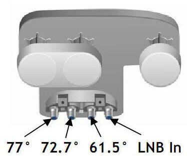

I thought each output port was fixed to a particular satellite. What convinced me of this was the attached pic. I'm learning.. thanks to you all.
Curious.. is that what Dish Pro or Dish Pro Plus means?
Allen
Thank you NYDutch..
Allen
No, the first 3 output ports can use all 3 satelites. It's a Dish Pro Plus which allows single wire operation for up to 3 dual tuners DVRs without an external switch.
