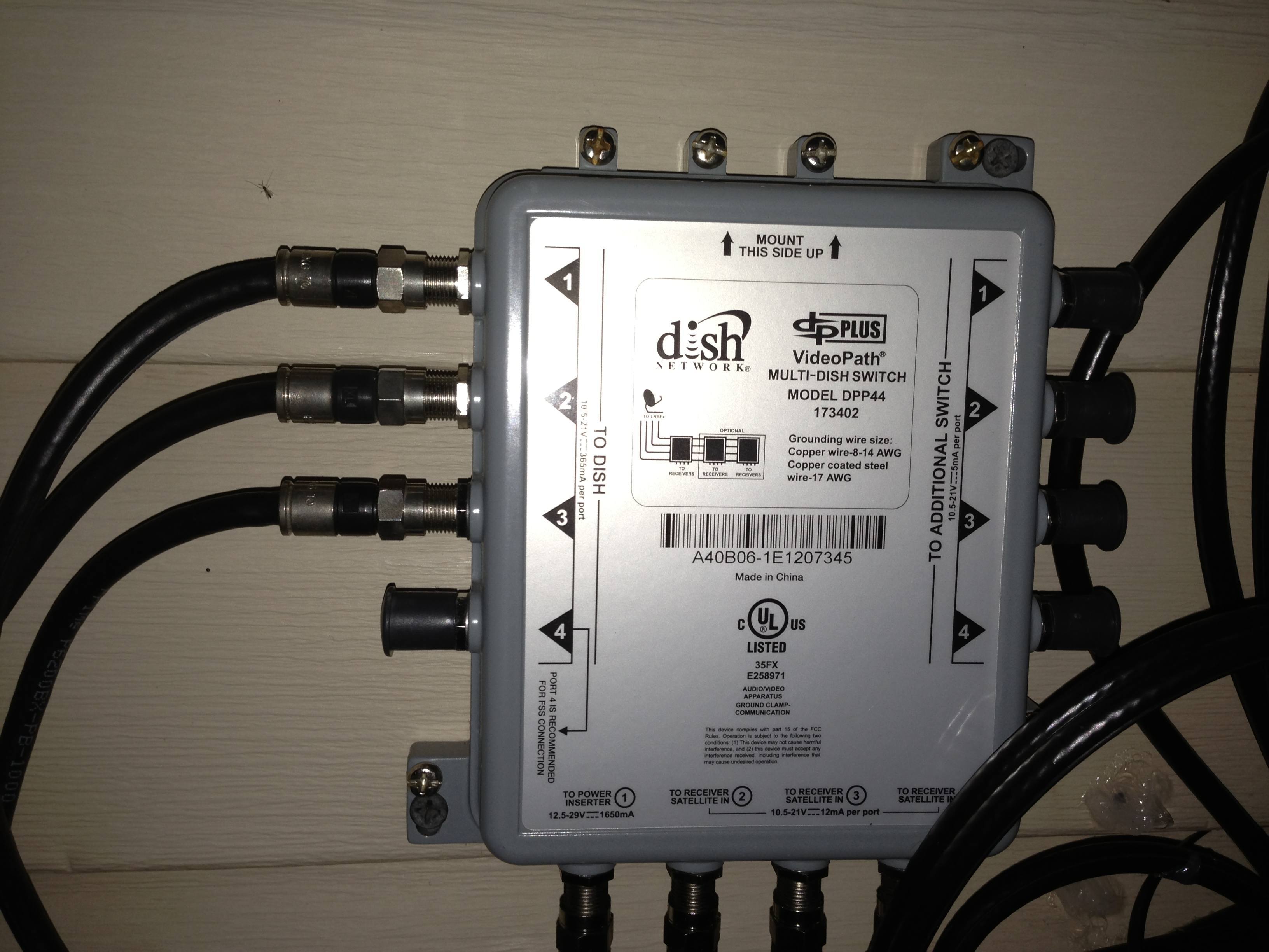

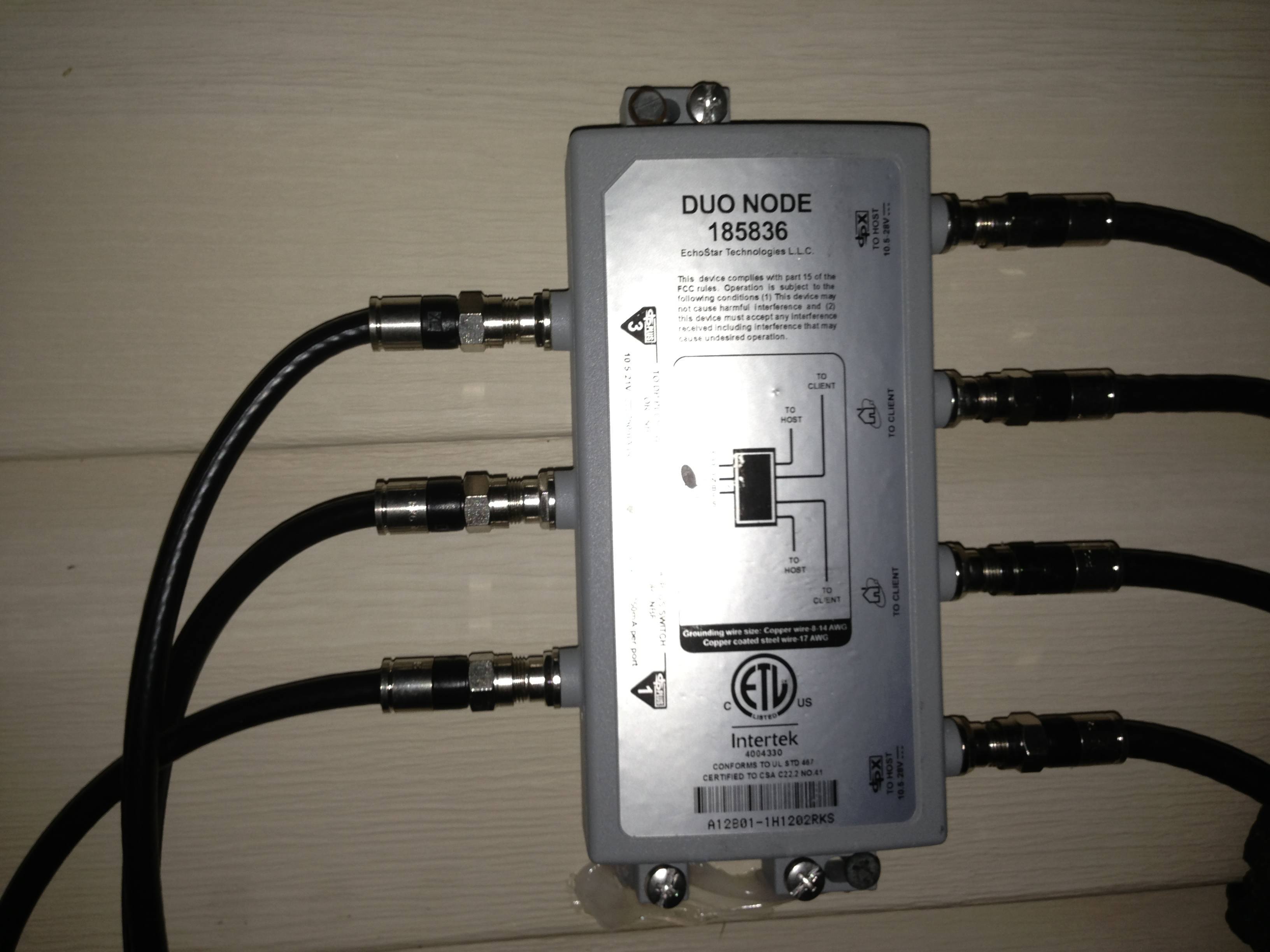

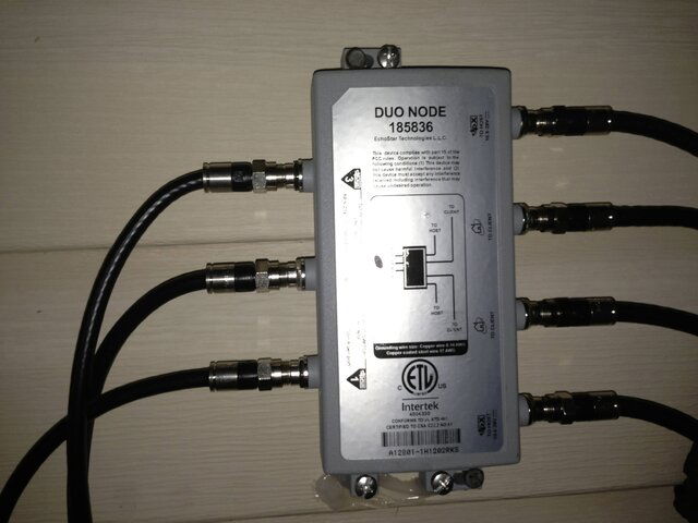

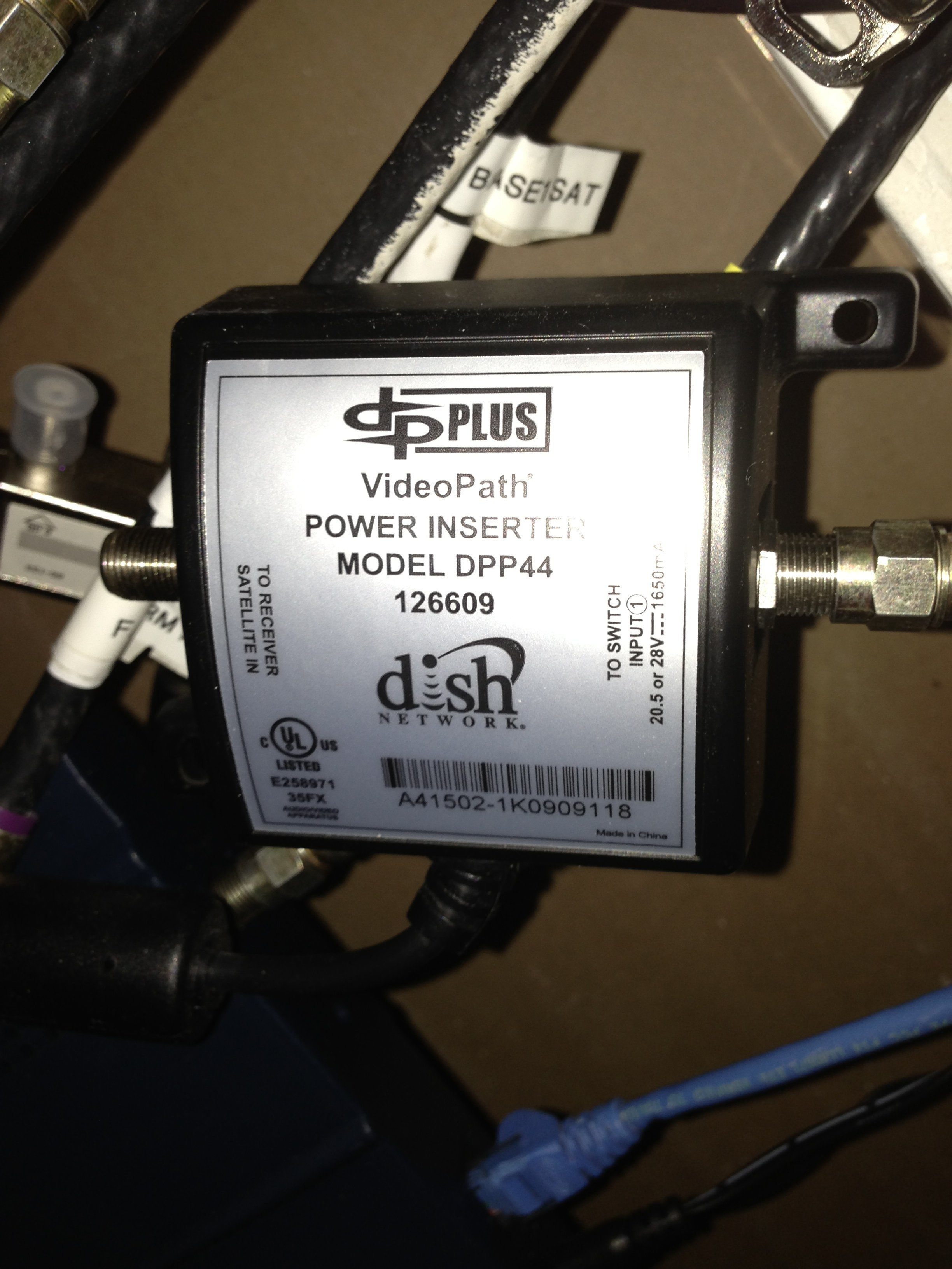

More information regarding my setup... I have a dpp44 switch connected to a duo node 185836. I have a dpp44 power inserter inside the house as well.

Pictures of dpp44 switch, dpp44 power inserter with empty output and of duo node attached.
So -
1. My power inserter has a "to receiver" output on it. Could this work and send an appropriate signal to the 211k?

Yah, the 211k will work fine on the power inserter output. Won't work on Joey (CLIENT) ports.
Thanks for the quick response. I plugged into the inserter output, did a check switch & program guide download and everything worked great.
